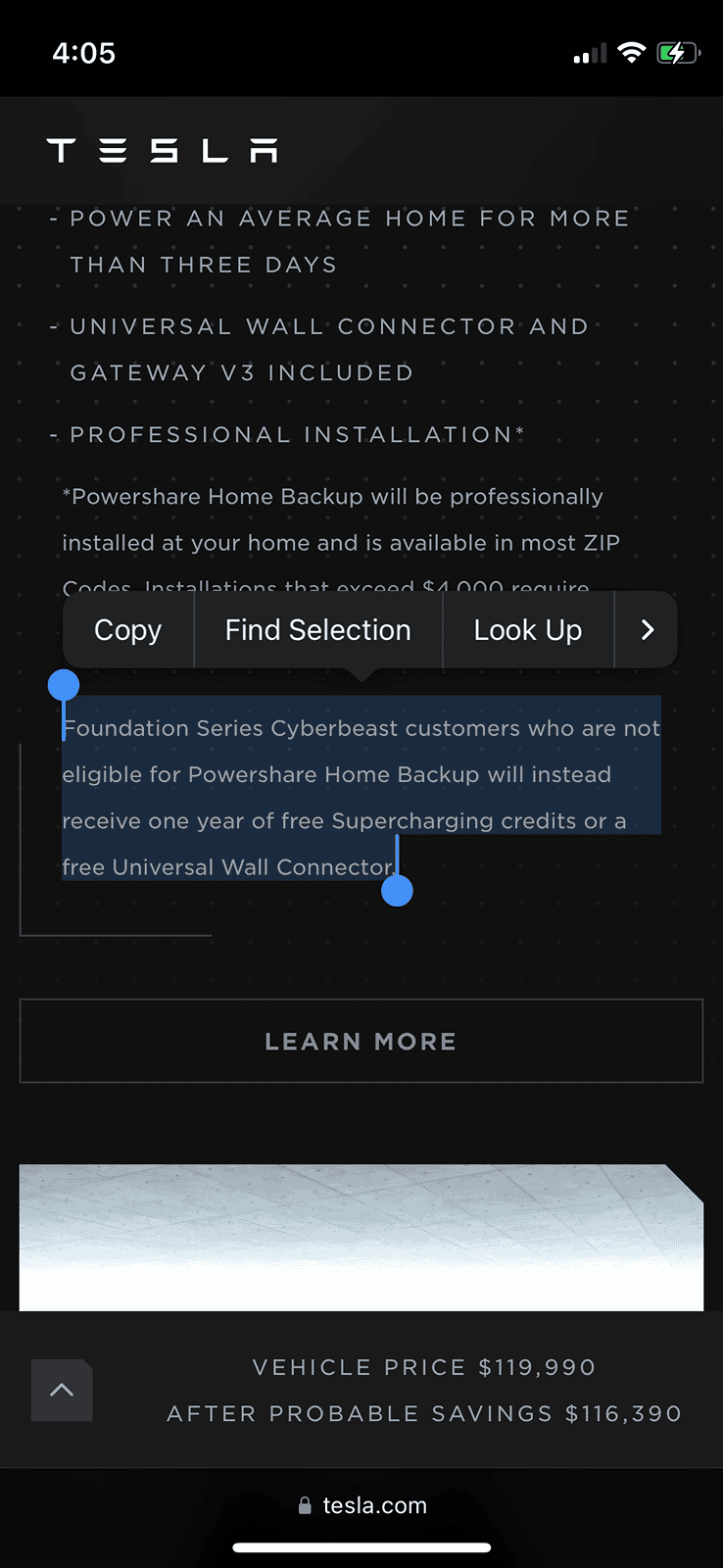

I was told "no" and given 6 months of free supercharging. I still very much want my wall charger though. Hope they don't think 6 months of supercharging is equal. I very much disagree and almost never supercharge(my Model 3 hadn't been supercharged in over a year before I sold it last month)
They said a year. I screenshot that shit because I knew I couldn’t install PowerShare.
Tesla Cybertruck ⚡️ PowerShare Install, Specs, Details confirmed! No load shifting (for now) IMG_0961
