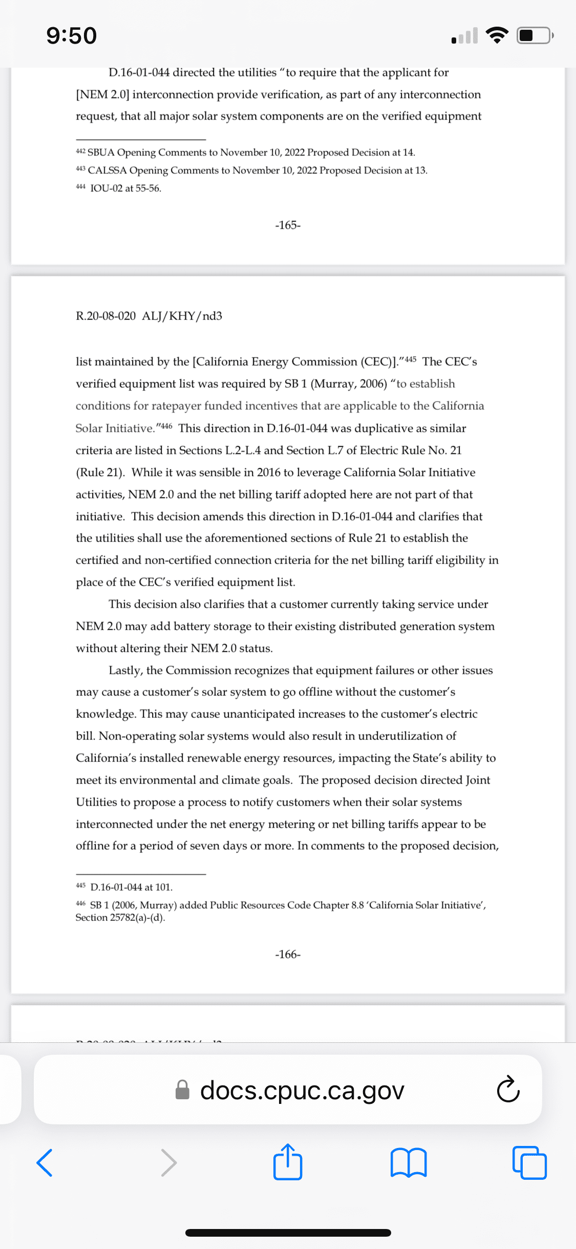

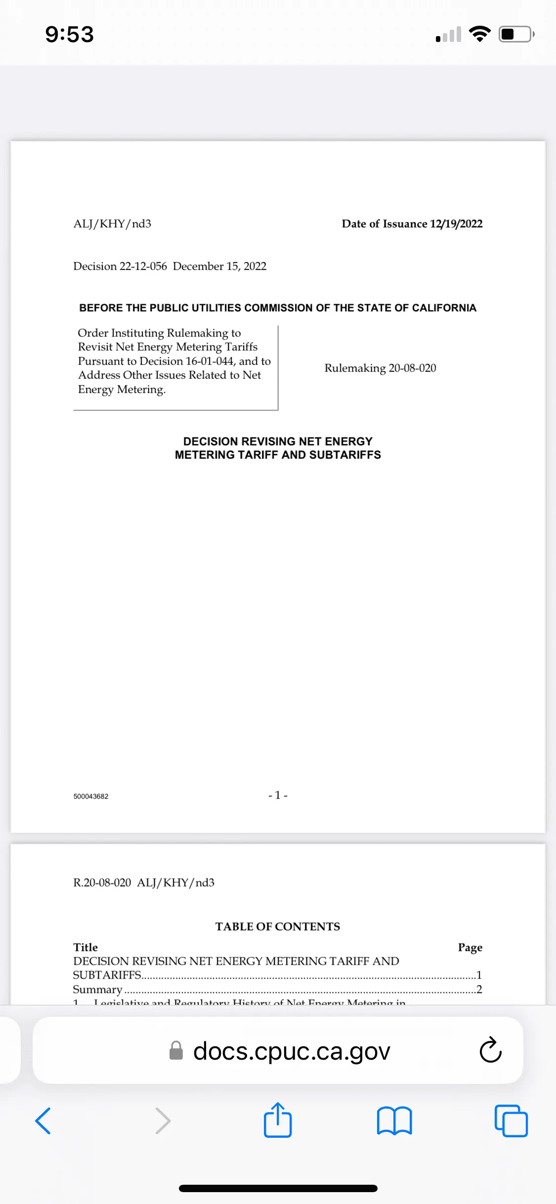

Agree. If you have solar and can afford a bit more, put install costs towards PW. Verify prior your NEM won’t change. My recent PW addition didn’t.
-As of ‘23 iI believe PW can also qualify for the Residential Clean Energy Credit, 30%
-Items you’d mentioned (grid-forming/load shifting etc) to recover some costs.
-No downtime w outages
-Vehicle doesn’t need to be there constantly for backup or GF/LS/…
-solar can recharge PW, extending backup.
-Can still use CT as additional backup,
-Additional home value-buyers won’t necessarily need to own a Tesla for PW functionality.
-Whatever effect daily charge/discharge cycles are, they’ll against the PW vs CT. People already seem to be complaining about distance. Probably easier to add another battery to a degraded PW setup than CT.
Would be nice if Beast FS credit could be used towards installation, while adding PW.
