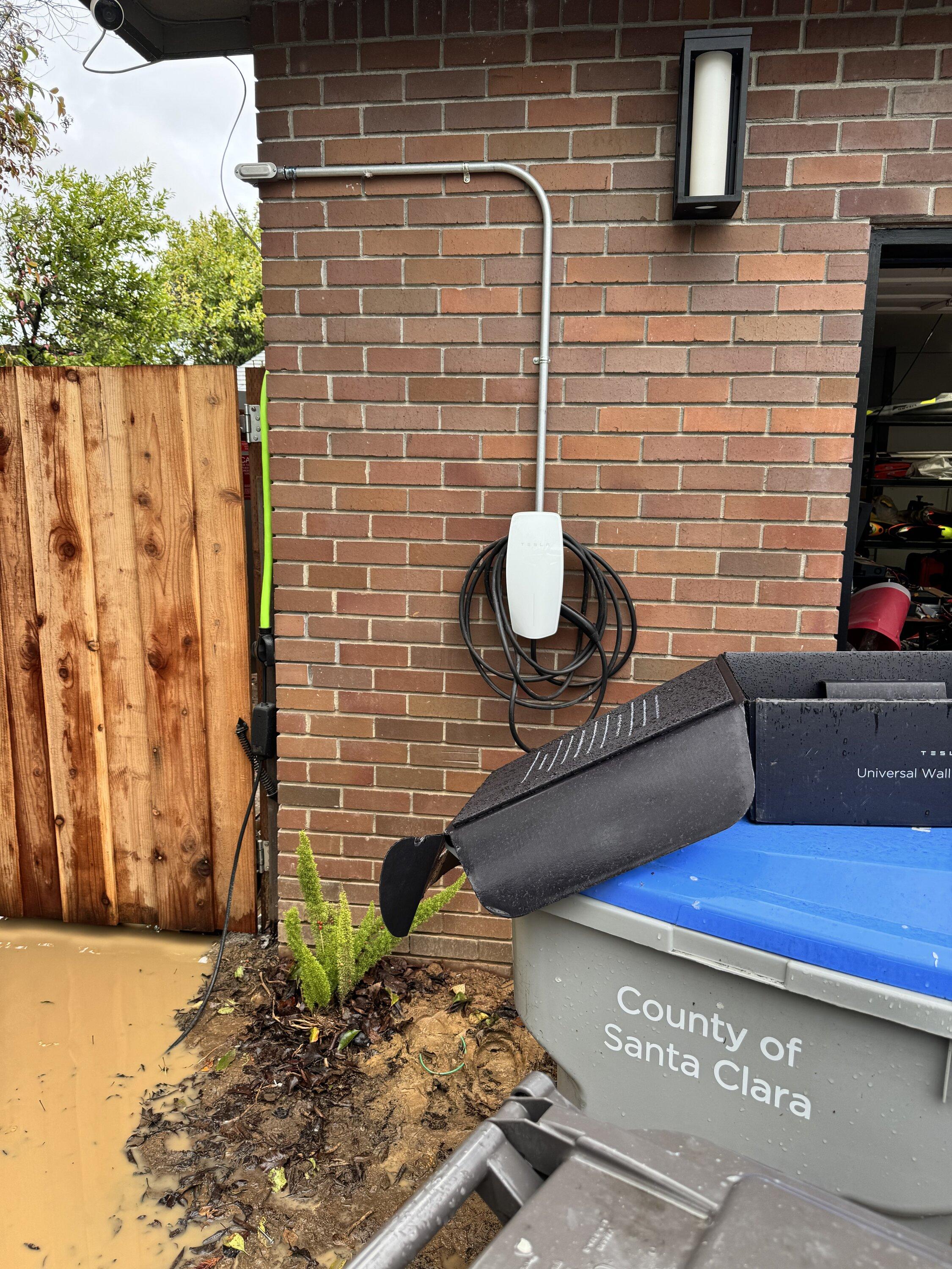

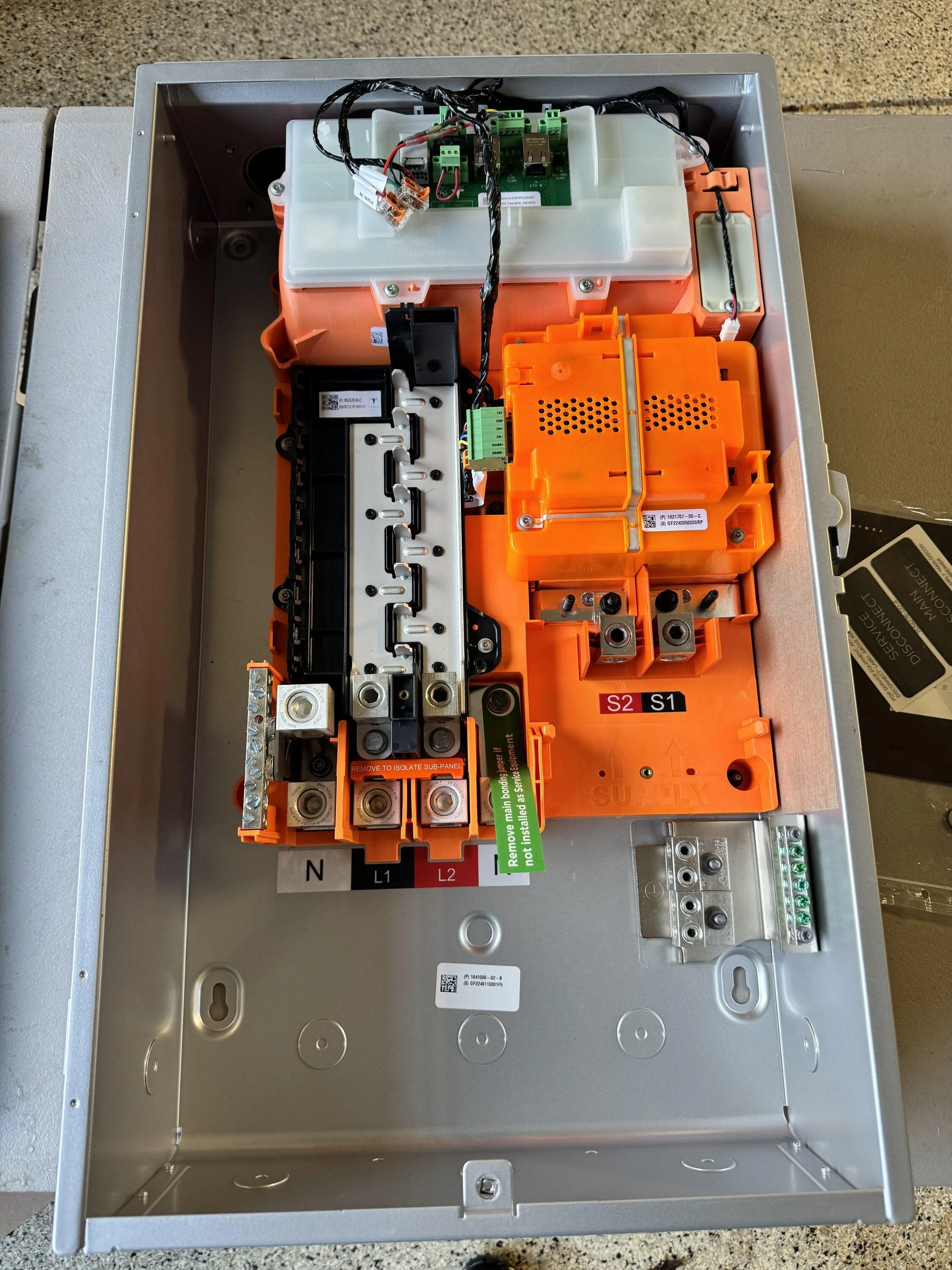

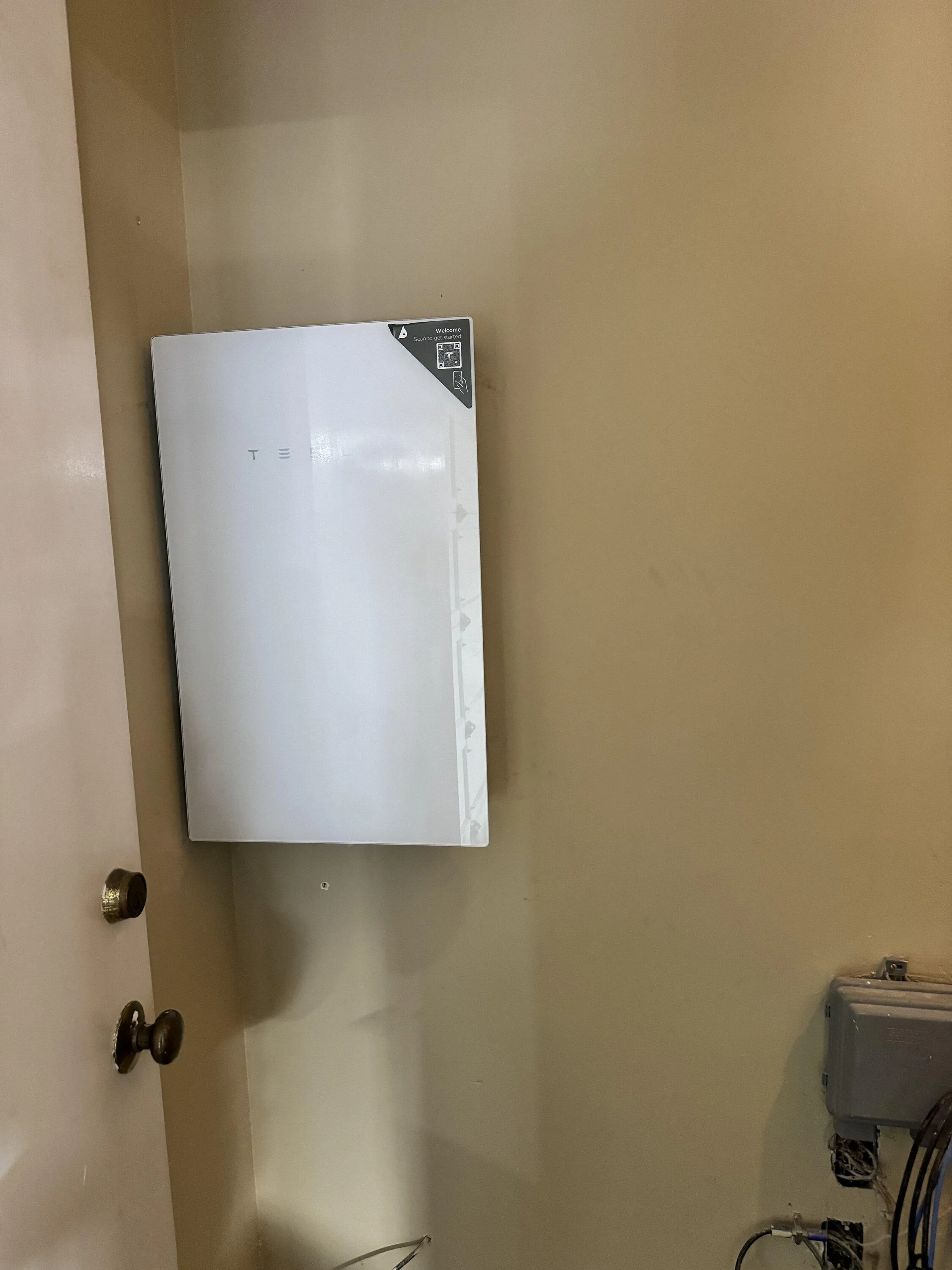

My v3 gateway and universal wall connector were installed today. Went very fast and was a very clean install. I was really impressed by the team that showed up. And I’m an EE that is hard to impress. Haha.
The new v3 Gateway design is impressive. Looks similar to v2 but a lot of visible improvements.
For us early adopters there were a couple of surprises
1) Firmware is delayed to March for supporting backup mode. So for now it’s just a breaker box. The firmware update requires them to come back onsite, and won’t be OTA. It’s early enough to where they didn’t even bother to connect the gateway to the WiFi.
2) Initial firmware won’t support having solar on the backup bus. So they won’t connect it. Once it’s supported they will come back and connect it
I have 400A service split into 2x 200A groups. It backs up one of the 200A branches.
Sadly we have storms rolling through here so was hoping I would have a solution. But it’ll need another month to bake. Hoping the support for solar isn’t far behind. I’m wondering if they will slow down the installs until the firmware is ready.

Gateway v3 is full installed. The UninWall connector and my house backup loads are all connected to the gateway. The only thing missing to make it work is the firmware which is delayed until March sometime. And won’t be an OTA update. Once the update the firmware manually it’ll operate with OTA updates.
The solar is still connected to the main feed and not the gateway. Eventually when solar is supported I’ll need to move it to the gateway. This will extend backup time. It’s not clear if they will support excess solar charging the car or not during a blackout. I’m guessing not but hoping it will.
My general sense is that V2H is supported but maybe not V2G functions like time shifting or allowing solar to directly charge the car in a blackout. Time will tell unless they release a roadmap of planned features for PowerShare. So powerwalls may have that advantage and eventually might make sense to add a couple to get support for those features.
