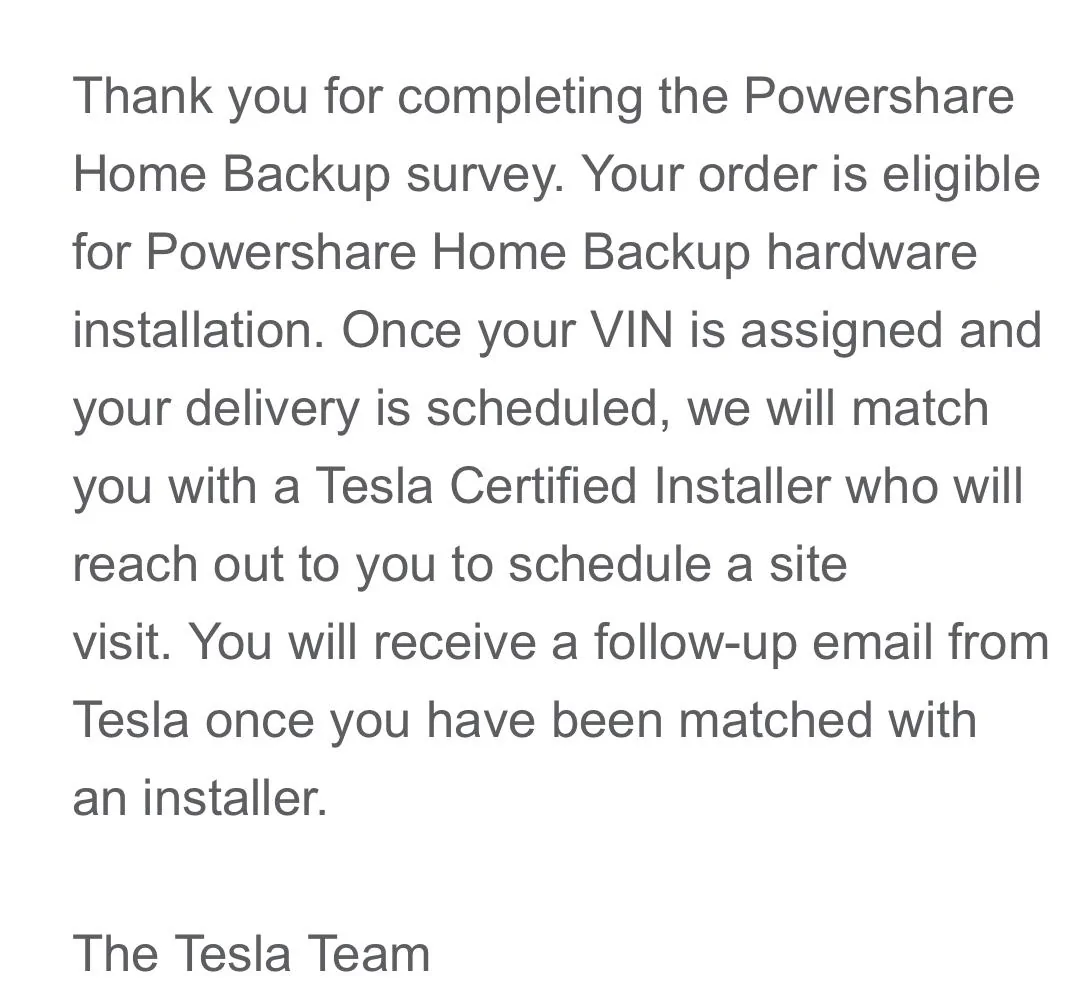

Just got an email about Powershare. I do have generac and they state i am eligible. We shall see how much it costs when i got my ViN
Tesla Cybertruck ⚡️ PowerShare Install, Specs, Details confirmed! No load shifting (for now) IMG_1023
Good to hear. Up in Portland and we just had a heck of a storm, so the wife wants a Generac and we got our PowerShare approval this week as well. Wondering how to coordinate between the two backup systems. Thanks for sharing.
