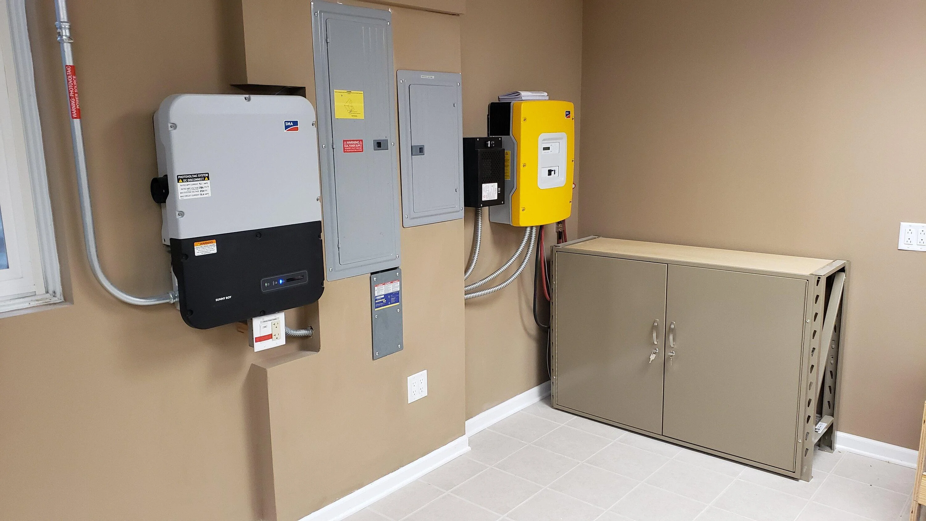

How does a 9.6kWH battery power critical loads for 24 hours?
For me, critical loads are:
1) Refrigerator and freezer
2) Lights in every room (selectively turned on)
3) Internet (modem, router)
4) Room outlets (selectively used)
5) Gas furnace
In summer my solar panels will typically produce 20 to 30 kWh each day. If the grid is down and the sun is shining, there's plenty of solar power during the day to supply my needs. Excess solar is exported to the grid and taken back a night to charge my Tesla and run the A/C. My monthly electric bill is $0.00 in spring, summer and fall.
In a blackout, the problem is having power overnight. The house battery is sized to handle overnight power consumption for those critical load circuits. Overnight power consumption from the protected loads panel typically drops to ~500W or less. A fully charged 9.6 kWh battery will easily last 12+ hours until solar output resumes, and the battery is recharged. Here's the system:
5) Gas furnace

I haven't been told if I qualify or not, but regardless I don't want the Power Share system.
1) ComED in Illinois is extremely reliable. In 12 years I can only remember one blackout that lasted more than a couple of hours.
2) I have a 6.8 kW solar system and 9.6 kWh battery bank to a Sunny Island inverter feeding a protected loads panel the reacts instantly to a grid power glitch. The battery will power lights and critical loads for 24 hours. In summer, solar will replenish the battery extending the backup period for days.
3) My Cybertruck will not always be available as a power reserve when I need it most. I spend the winter months in Arizona.
4) Spending an additional $4k - $5K for installing Power Share increases my CT cost to $107K - $108K. The AWD CT FS price is already a stretch.
Six months of Supercharging is better than nothing, but why not give $2400 in Supercharger credits good for use on my CT for life?
There is more profit in giving less ?
