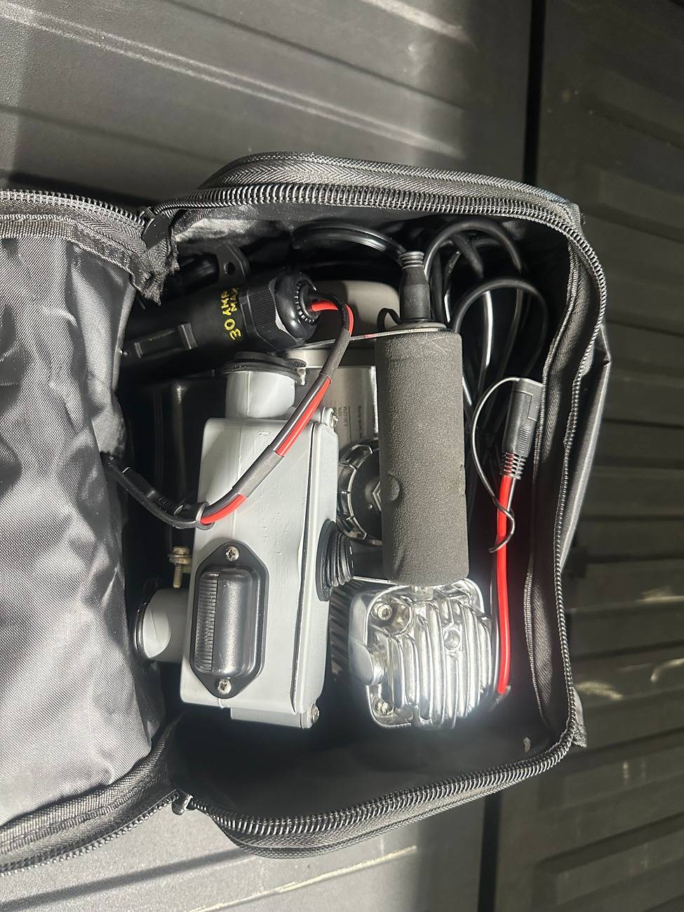

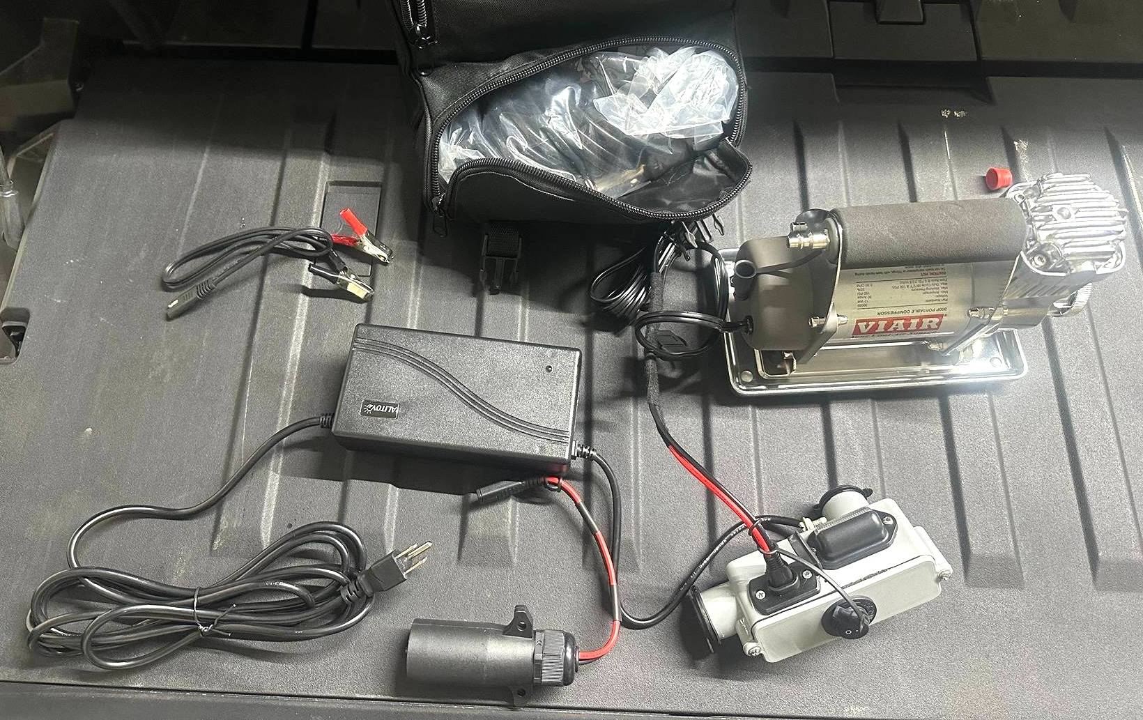

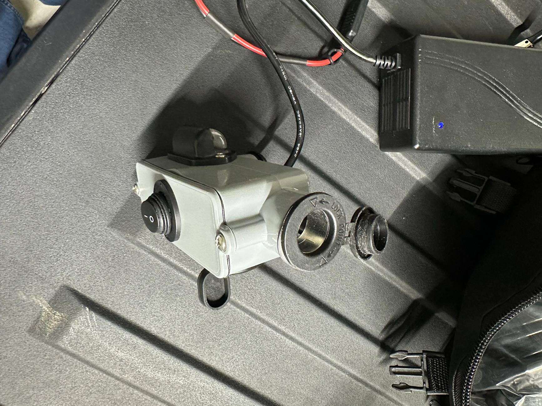

I wanted an alternative to the Tesla tire repair kit without the sealant (“tire goop”). Finding a 120 VAC portable compressor proved difficult, so I focused on 12 VDC automotive options. After some research, I chose the Viair 300P because of its positive reviews and reputation for quality.
Current Draw and Power Supply
  • Measured Current Draw: The Viair 300P pulls about 2.2 amps at steady state.
  • Power Supply Attempt #1: An 8-amp DC power supply didn’t work because the compressor’s locked rotor amperage (LRA) likely exceeds 8 amps. It actually short cycled.
  • Power Supply Attempt #2: A 30-amp unit (found on Amazon resale) worked perfectly.

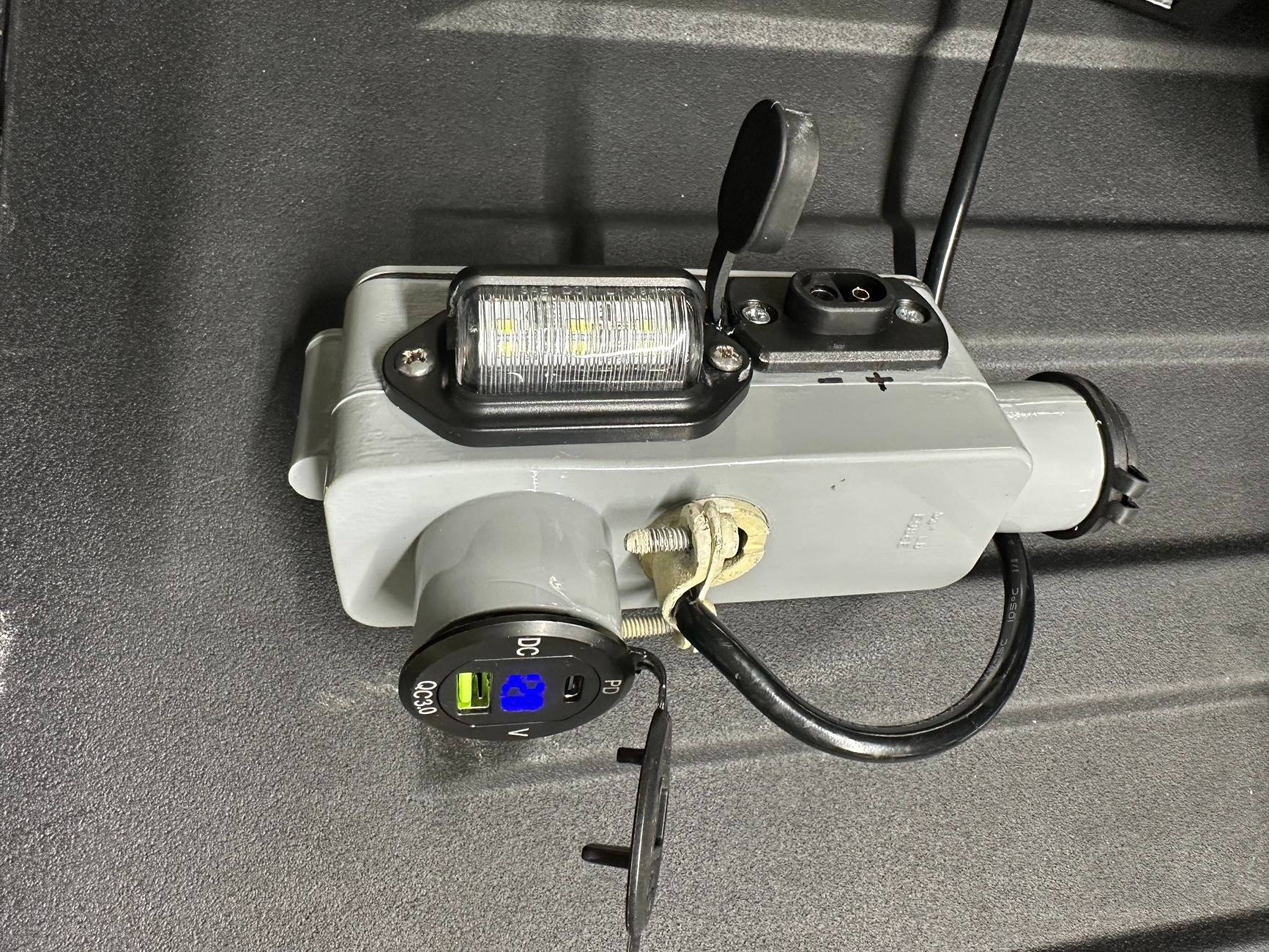

Enclosure and Setup
I like the idea of a battery or kayak box with lights and power outlets, but I wanted everything—power supply included—to fit in the Viair 300P’s storage bag. The power outlet box gives the added benefit of a USB charger while tailgating. I caught the 300P on sale for $150 and found the 30-amp power supply on Amazon resale for $34.
PVC Conduit Box:
  • Perfect for the socket connectors once you notch them.
  • Using a heat gun softens the PVC enough to mount USB and cigarette lighter sockets into the conduit connector posts.
  • The posts help accommodate the length of the sockets.

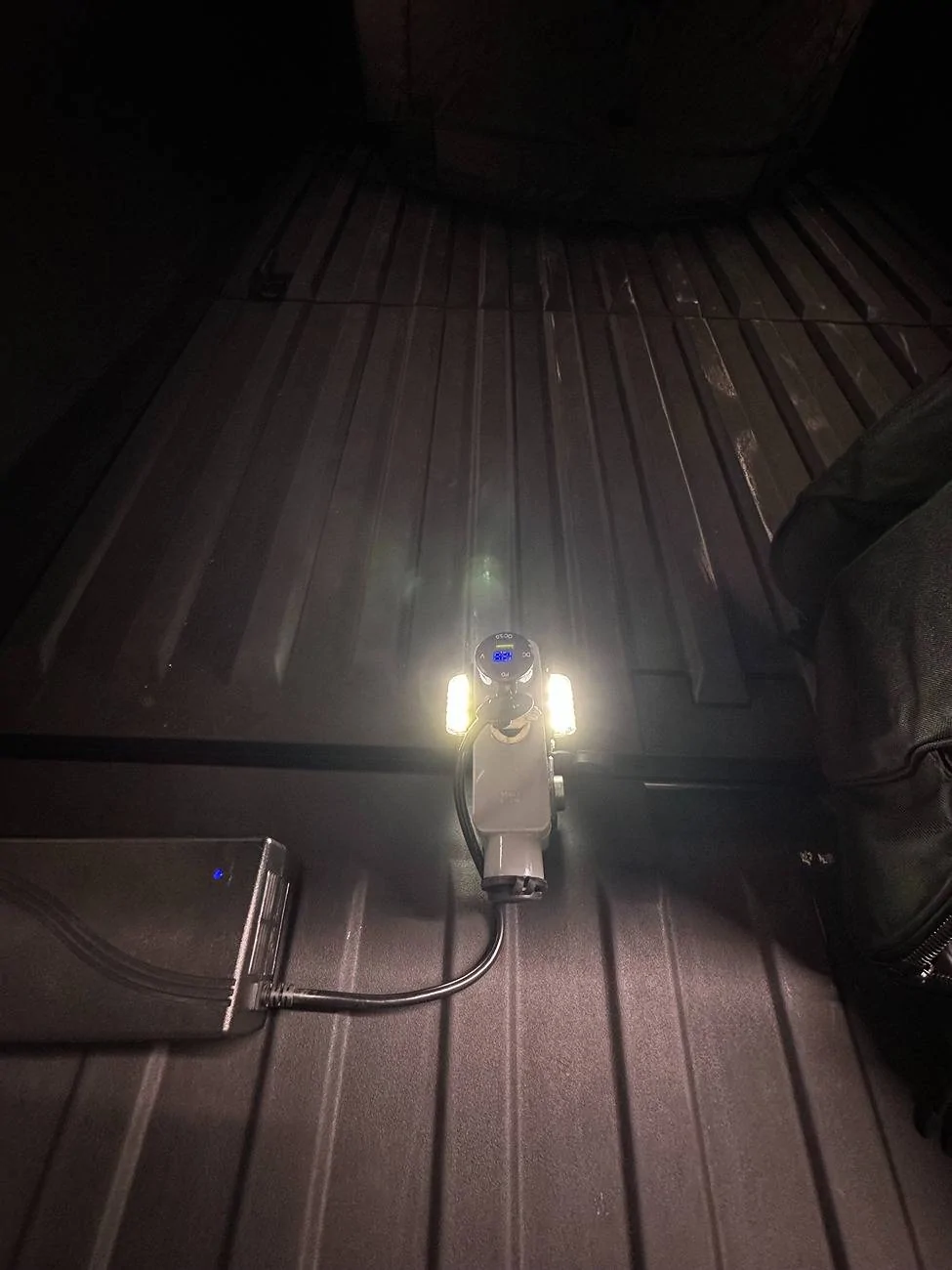

  • I mounted the switch is on the cover (it requires minimal depth).
  • Cut the hole slightly small so you can screw it in.
  • I wired the switch only to the lights.

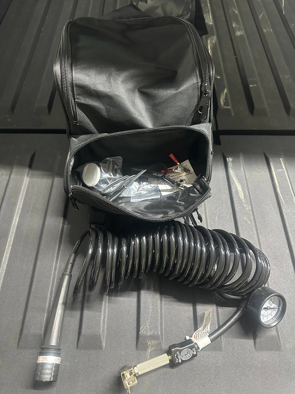

Viair 300P Set-up:
  • You will need to cut and splice an SAE connector to the end of the Viar cord.
  • Reuse the alligator clips to splice back onto a male SAE connector so you can use this with any other vehicles battery posts.
  • Pay attention to polarity with these type connectors.
Overall, the project was straightforward, and everything fits neatly into the Viair 300P bag. The final setup cost me around $256 and provides a portable, sealant-free air solution for the Tesla Cybertruck (or any vehicle you choose since it DC). The live links as of this writing cost about $289.
I’m sure there could be some improvements to this.

Yes this easily fits in the Vault.
You really don't need the 7-pin Aux power plug. I started with that but wanted to use the 120VAC supply since it is much easier to get to.
You can also downgrade to a cheeper compressor.
It's 12V because the vast majority - if not all - of the small portable compressors are made for automotive applications with 12VDC. None of the high quality Viar compressors are 120VAC.
If anyone wants to inspect their Tesla compressor I suspect it has a 12VDC converter powering a 12VDC compressor.

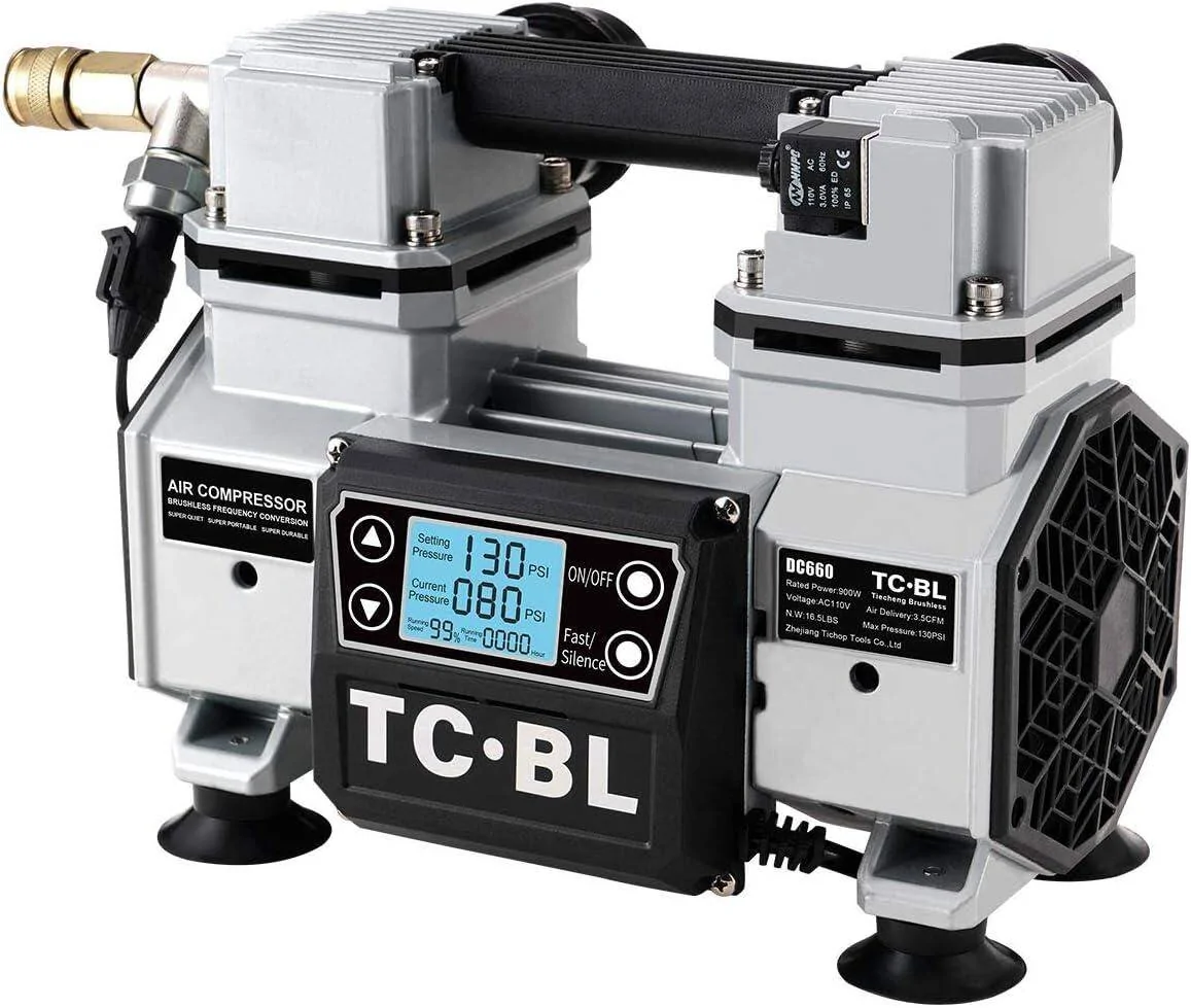

My compressor choice ended up being the Etenwolf Vortex S6. I went back and forth on a 'real' compressor, but this one works well and I can charge it in the truck if the need arises. It's made for truck tires, so works tons better than my previous portable compressor that I used in my Model 3.

That's a great find and option. I didn't come across that in numerous searches, including on Amazon.
As far as it running circles around the USA-made Viair - well, it's made of Chinesium, and time will tell. They both seem capable for emergency use, but the Viair has double the flow rate (2.3 CFM or 65 L/min vs. 35 L/min). I can't think of a scenario where I would ever want or need to do a circus routine filling all four tires at the same time.

This is silly. All Viair compressors are 100% manufactured in China, just like the TC-BL compressor. It's pretty difficult to find an American made compressor anymore, and thinking it would be better, even if it was made in the U.S. (and neither compressor is) would be wrong-headed thinking. The country of manufacture doesn't define the quality or durability, it's the actual engineering and manufacturing that matters. I've seen complete junk engineered and manufactured in both countries (and I've seen very well engineered and manufactured products from both countries).
Pretty much all compressors/inflators are made in China these days. If you want to search out one that is still made here you will probably find that it's too big to be useful for this application (or a highly specialized compressor, perhaps like the high-pressure compressor used in the suspension system of the Cybertruck).
As to flow rate: Specs can be misleading, what matters is how it performs for the task you use it for. I will guarantee the Viair is slower at filling tires than the TC-BL. Obviously, either will work but I don't understand why anyone would want to deal with the 12V voltage converter and all the wiring modifications just to end up with a slower, less efficient, more expensive solution with more dangly bits to deal with. Ignore the specs, they are probably both rated at 0 PSI in order to get numbers that will look more impressive to people who don't know any better. How much of your inflating happens at zero psi? In practice, none of it, because the Schrader tire valve causes considerable backpressure with either of these compressors. It's a meaningless specification.
The four-way tire filling hose is AWESOME if you need to add 15-20 psi to all tires after deflating for off-roading. The circus would be filling each tire individually (like I had to do for many years). The reason for this is the Schrader tire valve is very restrictive, so restrictive that a lot of backpressure builds up between the compressor and the valve, causing the compressor to have a higher working pressure than the tire sees. By giving the inflator four wide open Schrader valves, the backpressure is greatly reduced, and the compressor can pump a much higher volume of air with less heat and work.
With a four-way hose, your compressor will run a lot cooler and last longer, you will consume less energy, and you will get back on the road a lot sooner. A side benefit is your tires will all be exactly the same pressure (which has real-world benefits I won't go into here). It's the right tool for the job.
If you are just filling a single tire, you don't need a four-way hose (or a fast compressor). On my street bikes I bring a 12V compressor that is smaller than a closed fist. Yes, it's slow, it takes around 8 minutes to fill a single motorcycle tire, but it's only for emergency puncture repair.
