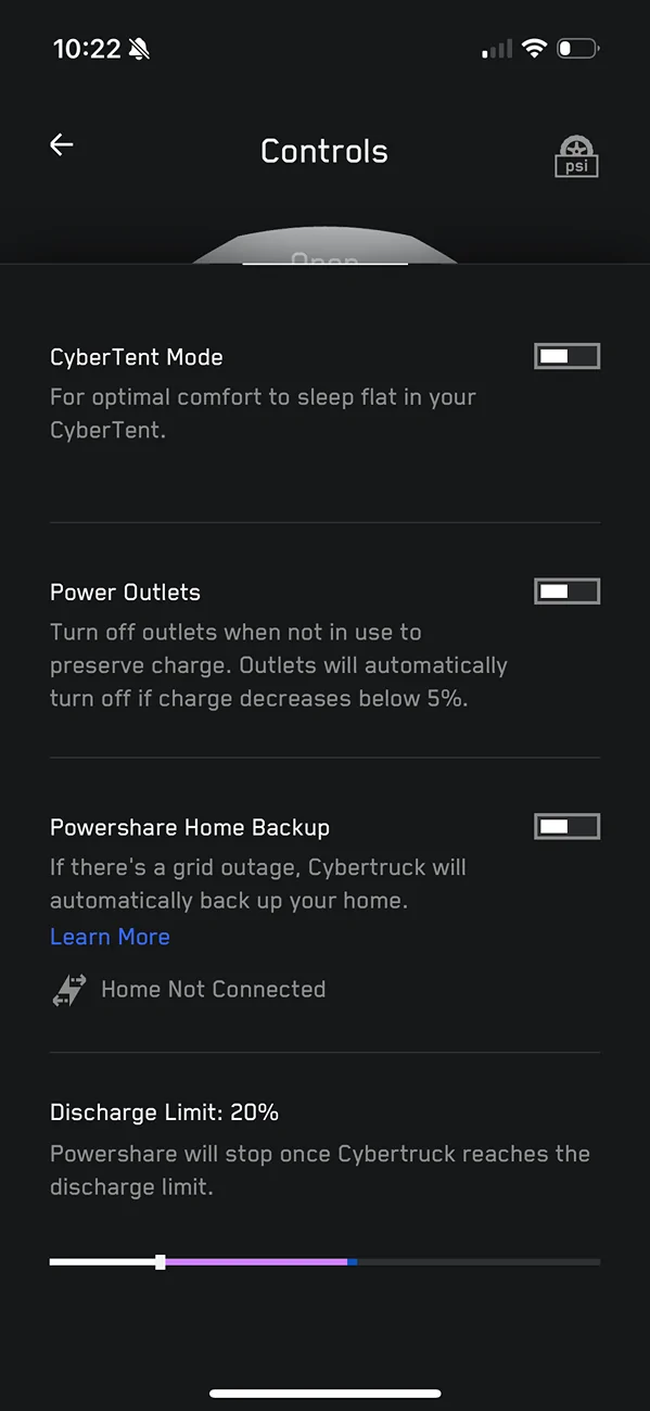

Under Cybertruck controls menu when you slide up from the bottom you can see few options like: cybertent, power outlets, powershare and discharge limit.
Ahhh, there it is!!
Honestly, I don’t think I knew you could swipe up on that card lol.
Tesla Cybertruck Powershare update: Home Backup enabled for Solar + Backup Switch IMG_4843

Haha same here. I found out about it just a few days ago. Member on the forum mentioned. Hopefully it will work for you. For now my house still shows as disconnected.
yeah, I now see the white horizontal line at the top of the card, indicating you can swipe / pull it up.
Yep, it shows as disconnected for me too. I’m not expecting it to show connected until the PW software update in Q3….but I still enabled it.
