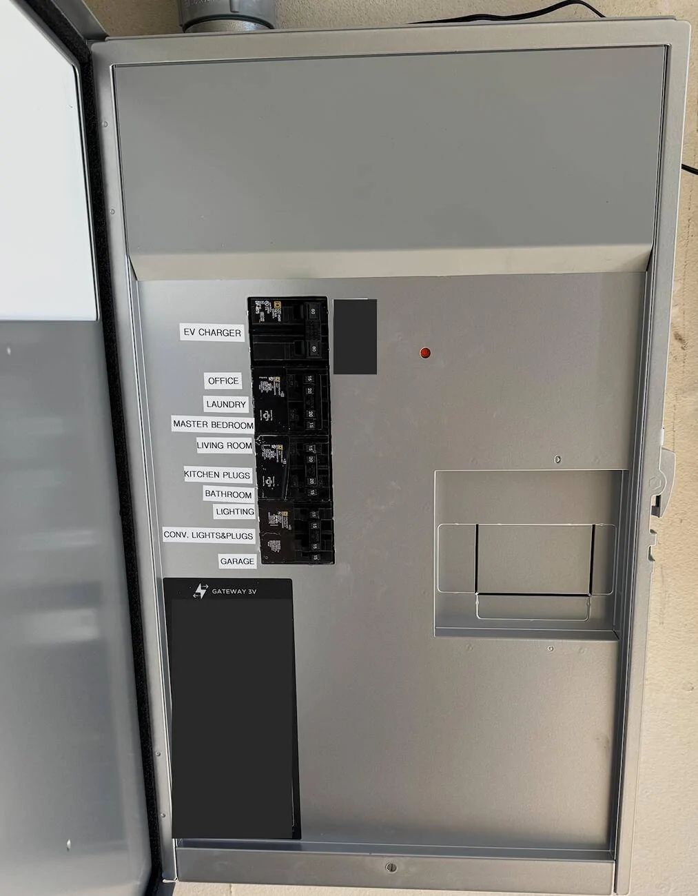

I've had my Cybertruck less than a month and the PowerShare Gateway for even less. Last week I noticed all the PowerShare options for the app and on the Cybertruck were available. I have Enphase Solar system with no battery backup. To test it I turned off the main to simulate the grid going off. It seemed to switch over to the Cybertruck battery and power my house in about 10 seconds or less. I do not have my solar system going through the PowerShare Gateway so I don't see how it could still work in an outage. Now if it was hooked up to my gateway, then I can see how it might be able to. Problems is, I was told I could only use 12 circuits from my panel to run off the Gateway/Cybertruck battery. I don't run my pool, a/c and one circuit that was labeled lights plugs. Even though I have these items not running through the gateway, all my 4 bedrooms, kitchen, baths, living/family rooms, garage have power in an outage. I have SDG&E in Orange County CA. It's an amazing technology.
Great info - thank you! Is the 12 circuit limitation applicable to the number of circuits, or is it the load, which in your case happened to end up limiting you to those 12? I'm confused about the amount of power the truck can provide, because I've heard the battery pack described as equivalent to 3 PowerWalls and that should be plenty to power my whole house.
The power output of Cybertruck is equivalent to one PW3. The energy in Cybertruck is around 6 PW3s.
The Gateway 3V has eight full sized breaker slots internally which can support 16 half height (duplex) breakers, and can also feed a subpanel with its own additional breakers (or even the entire 200A formerly main house panel (with manual load shedding)).

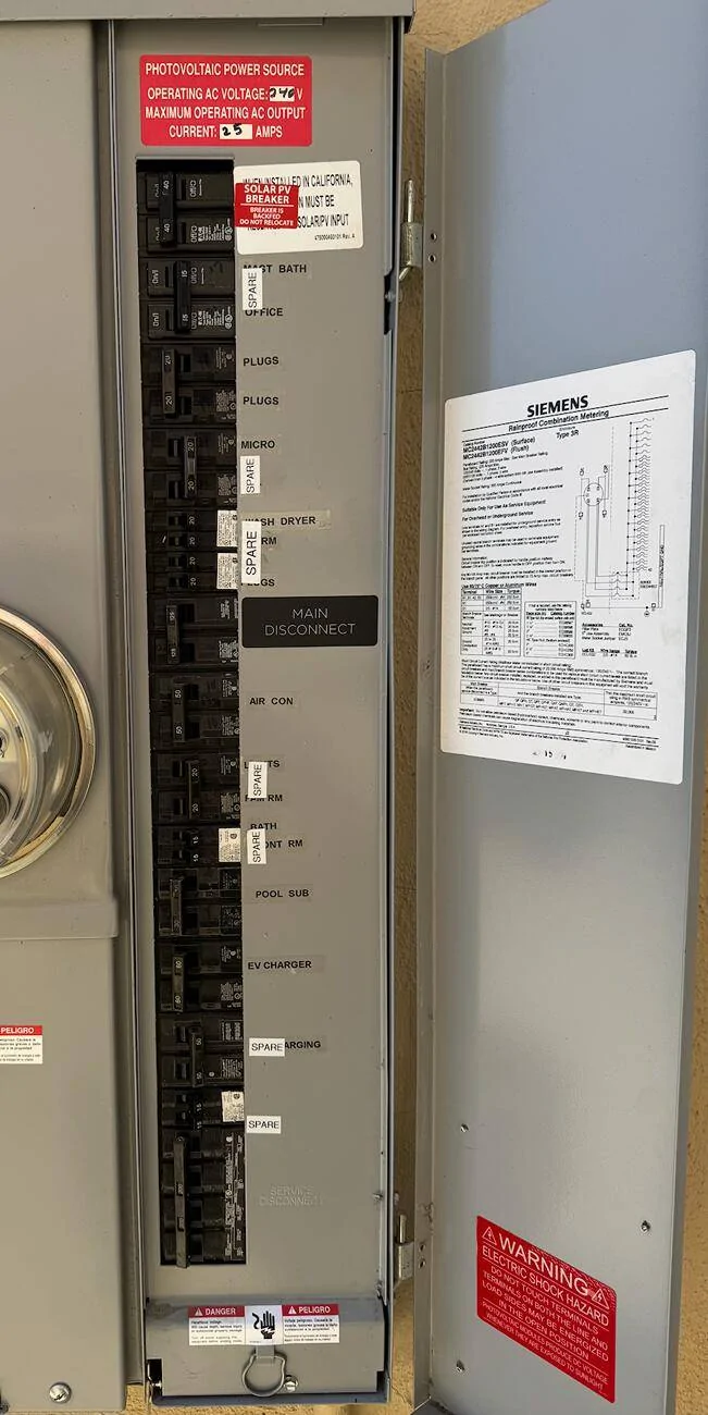

I believe it's both. In my case that included the 60amp circuit for the new Universal Wall Charger. As you can see in the attached photo of my electrical panel, everything labeled as "Spare" now goes through the PowerShare Gateway and will be powered during an outage with the Cybertruck. As you can see, my Solar is not going through the gateway. The other photo is of the PowerShare
Gateway showing everything marked as spare in my electrical panel goes through here now.

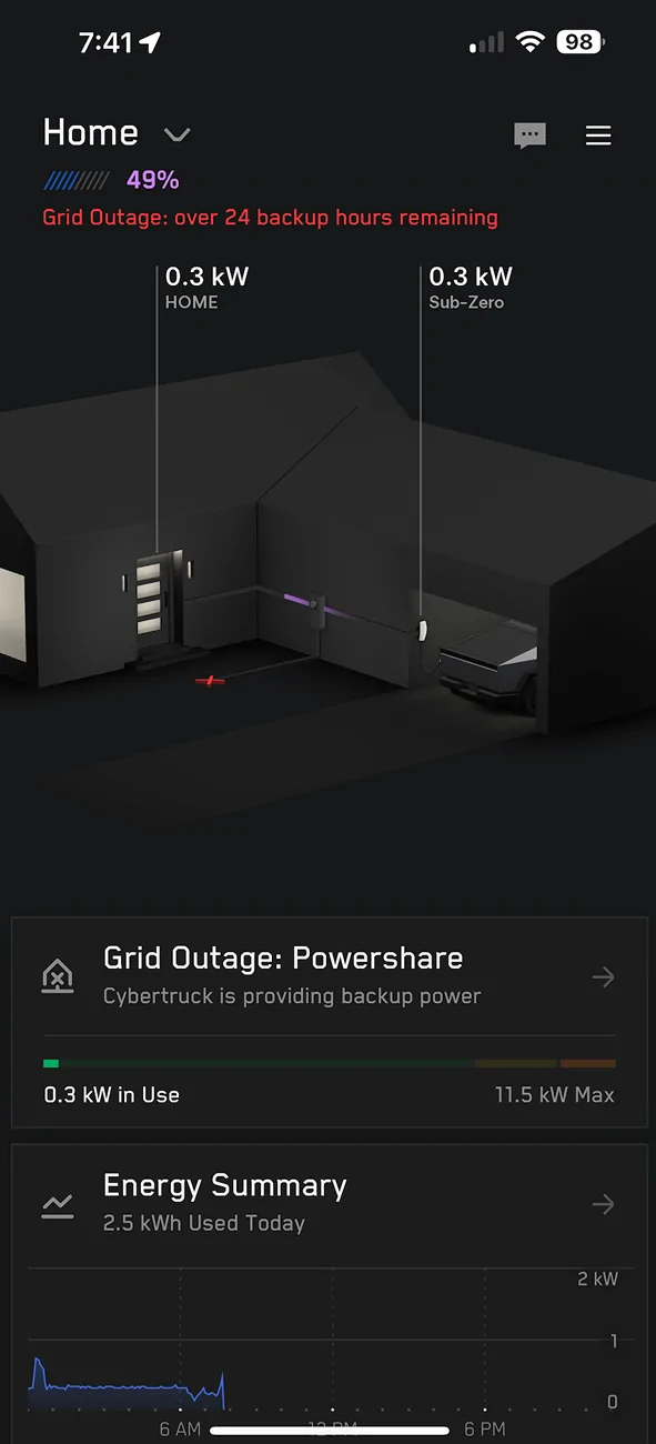

Here's a screenshot from my phone app when running off the Cybertruck showing the stats. As you see, I was only using .3kW and the max available was 11.5kW.

Yep, and from your photos, the 12 circuit limitation was due to the wall connector taking up two full slots on the internal panel.

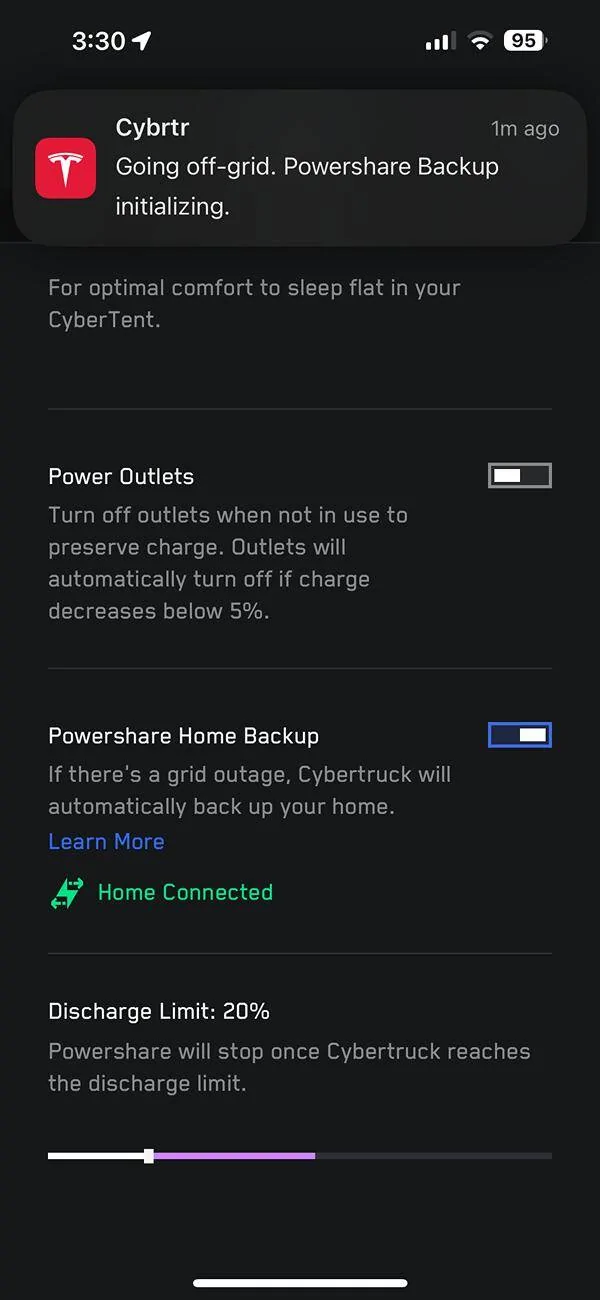

I just checked my Tesla app today.
Tapping on them Swiping up on the Controls I now see the PowerShare Home Backup as noted in first pic. However, originally it showed not connected. I plugged the truck in to charge then hit the main breaker to cut off power from the grid. The PowerShare gateway clicked and the truck was charging the house. ?? finally works - truck battery powering the house. In the Tesla app the Controls show under the PowerShare Home Backup screen that Home is Connected,
Tesla Cybertruck Powershare update: Home Backup enabled for Solar + Backup Switch IMG_0235
even after I disconnected the UWC charging cable from the truck it still shows Home is connected even though the UWC is not plugged into the truck.

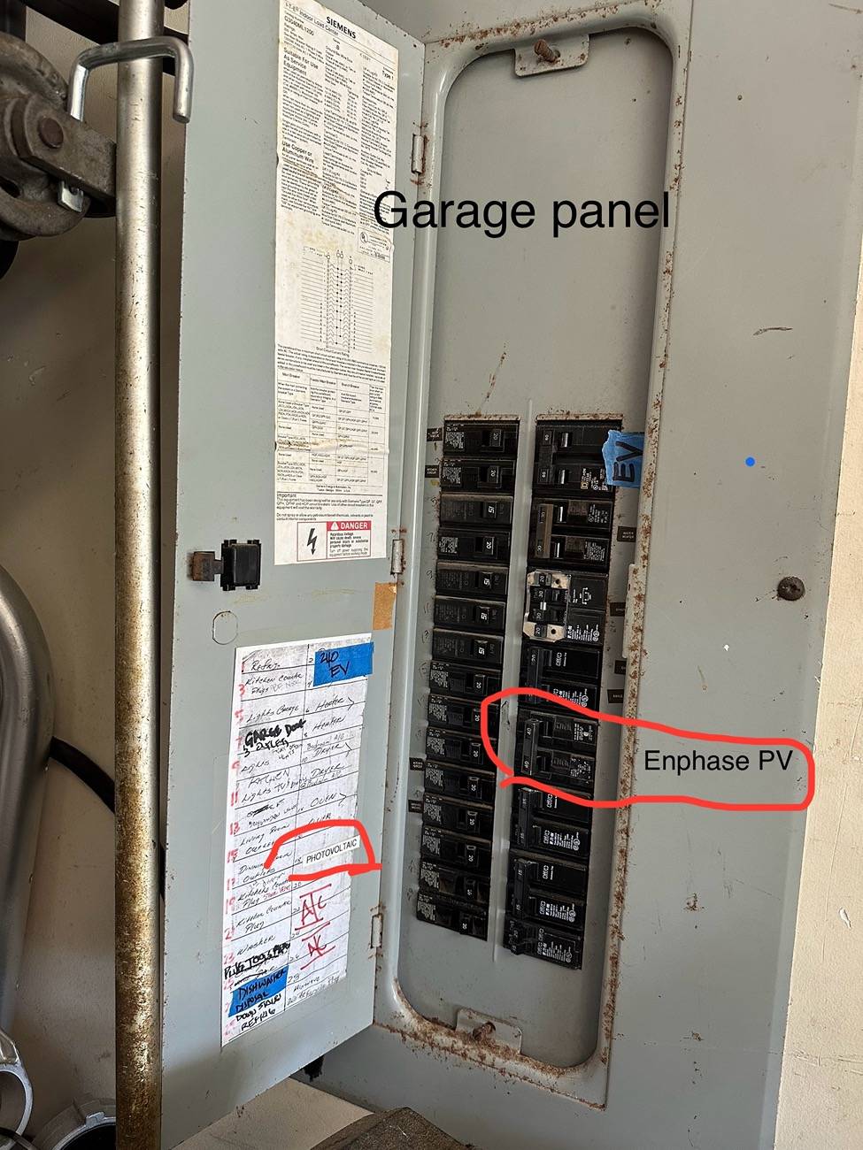

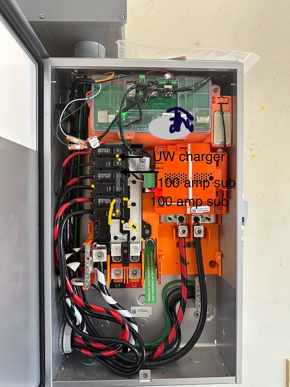

my system setup is:
* I have solar panels - third party Enphase micro inverters
* I have a Cybertruck
* I have PowerShare installed
* I have the universal wall connector installed wired directly to the Gateway with a separate 60 amp breaker. My two 100 amp breaker boxes are connected to the Gateway each on 100 amp breakers in the gateway wired as sub panels. thus all electric circuits in the house are backed up and should be powered by the truck. As the power coming from the truck is limited to about 11 KWh I know I can’t run all at once the 240 AC units along with 240 oven and 240 water heater.
* my solar panels are breakered into one of the 100 amp sub panels.
Most of the time on sunny days with nothing 240v running my solar panels are feeding back to the grid. However, during my test the solar panels were not charging the truck. Presumably cloud cover such that not enough KWh generated to power the house and any excess charging the truck. I need to have the Qmerit installer come back to test the system install and explain how this PowerShare is suppose to work as configured. Install was completed about two months ago. Installers first PowerShare install.
But the good news is have not been billed for the installation, about 5,800.

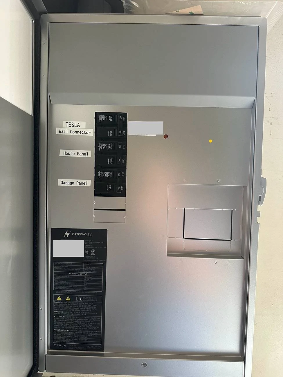

My setup is the truck powers the whole house but the 60 amps from the truck would not be able to power everything. I must self monitor what is being used. My original main 100 amp panel and the 100 amp sub panel are setup as sub panels of the PowerShare Gateway.
my system setup is:

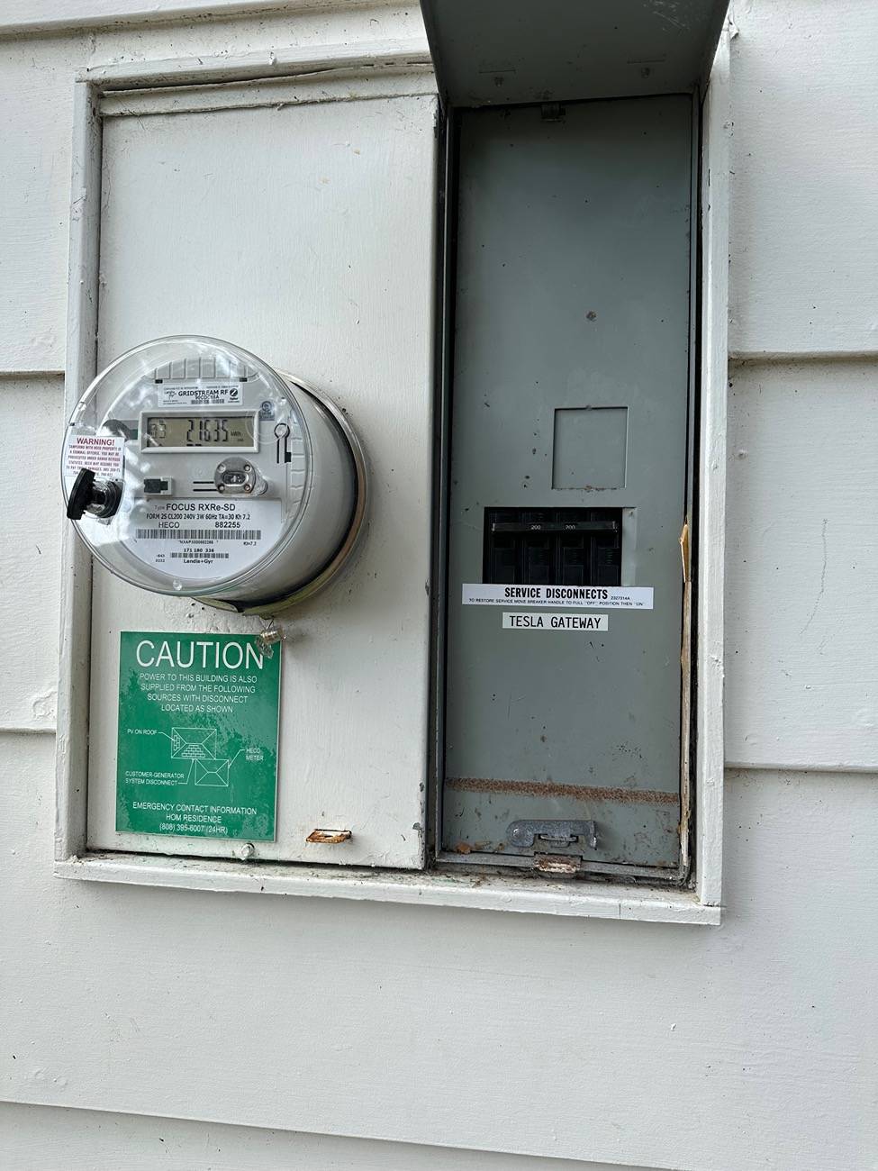

My installer came out to test my Powershare installation today. Spoiler alert: things did not go as hoped.
2 weeks ago we had a storm that knocked out power. I was suspecting it might so I plugged the truck into the wall connector. When the power did go out, I got a notification that Powershare had failed. I took a pic of it and showed it to the installer when he came today. He checked all of the software and hardware and couldn't figure out what was wrong, so he called Tesla Energy and they had him turn off the solar and my generator, and then he tripped the grid breaker, and I got the same error. This time, however, there was a button on my app that allowed me to start powersharing. When I selected it, powersharing started working.
The Tesla Energy guy said that systems with backup generators and solar are not approved yet from Tesla, and that it will probably happen sometime but clearly not at my house (San Francisco Coastal Peninsula). They told me that when the power goes out, and before my generator kicks in, I can hit the 'start powersharing' button in the app, and that when the grid power is restored I'll get another notification to turn off powersharing and I can then find that button in the app to turn it off and return to grid power.
Of course this sucks, but at least I know that the hardware was hooked up correctly and that this is all on Tesla, but it sucks to be told that everything is working only to find out that it isn't. I am glad that it is working for some people; I just don't understand how others with basically the same setup as me have it 'all' working (i.e., automatic turn on and off) and I do not.
