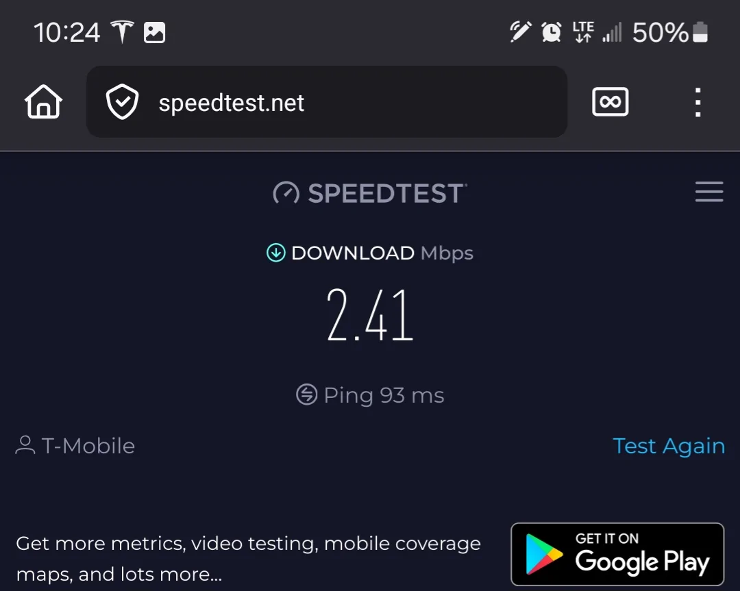

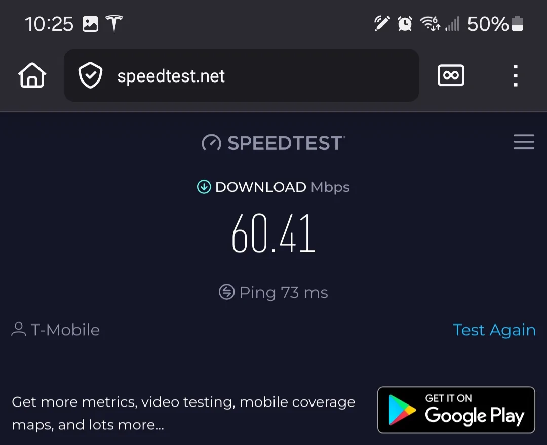

Right, they cap your high speed data.
Here are the results for T-Mobile (also on old Sprint carry over plan) and Starlink from my couch without having hit the limit.
