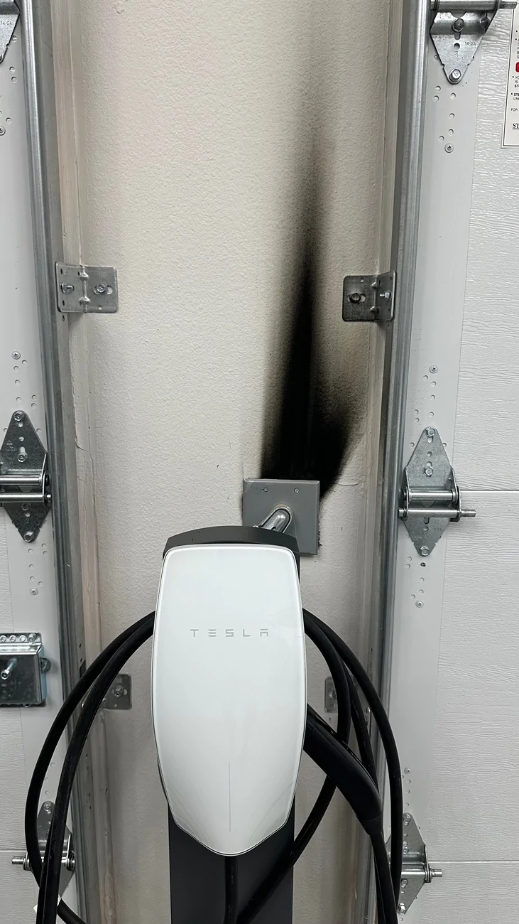

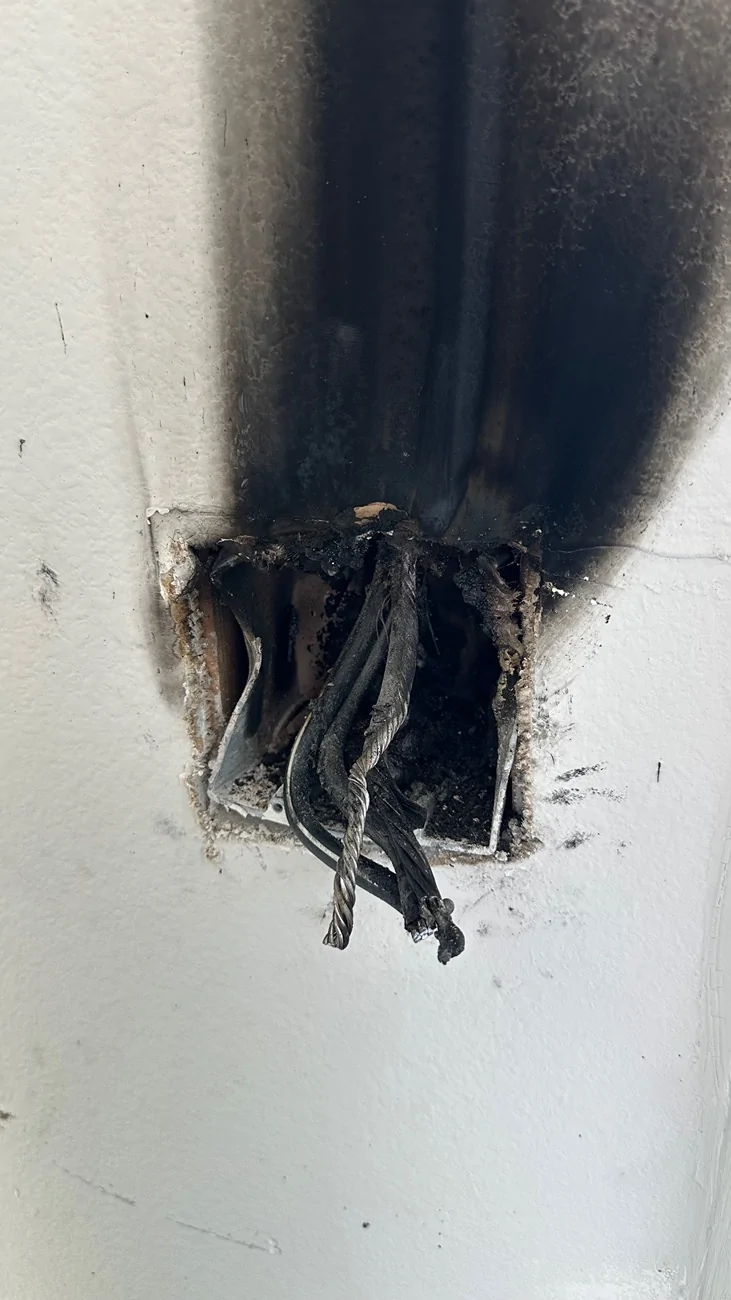

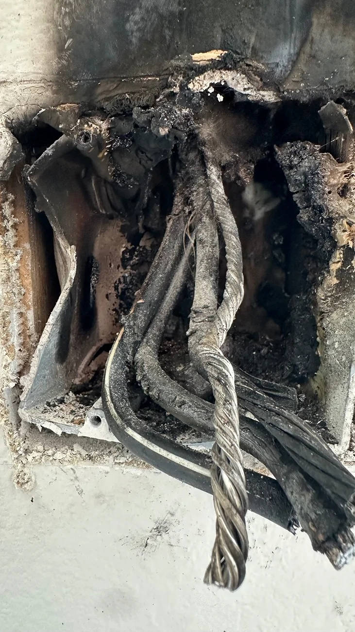

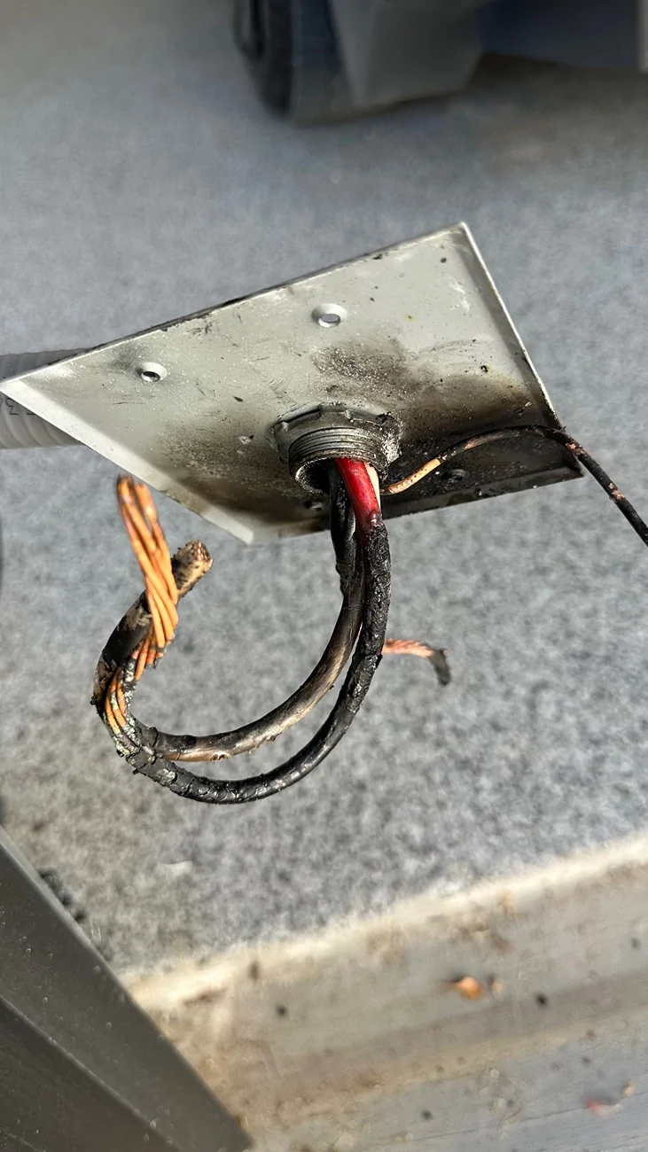

Aluminum clearly does meet code in some states. We built a new home in MD last year. The builder included an EV charger outlet (1450) as an option, which we selected. Upon adding a second WC, solar panels, and Powerwall, we discovered that the electrician had used #6 aluminum romex wire for the first wall charger. We left it in place and added another breaker, conduit and #4 copper to a new box for the first WC to mount next to the existing 1450 outlet that retains the aluminum wiring. Expensive to do, but provides the benefit of full 48 amp support at both of the Tesla WCs and allows the 1450 outlet to provide easy charging of non-Tesla EVs or to run 240v tools.
I did the same. I specifically asked them to wire it with #6 THHN so I could use it for hardwiring later (they wouldn't prewire without an outlet), but naturally they used romex instead...
