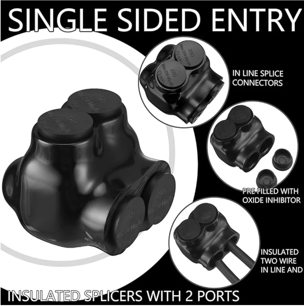

I was curious how they connected to wires. this appears to be the incorrect connector. on my solar setup the connecter has insulation around it, not bare metal.

Split bolt connectors get wrapped in electrical tape, it burned off...
Still, that was the wrong split bolt for the application. Cu/Al versions aren't copper finished and have an additional piece that goes between the cables.
all solar in California uses the insulated connectors I show, maybe from different company. you cannot rely on tape to hold up in hot and cold situations. the glue always goes bad from temperature change. getting hot will just melt the glue.

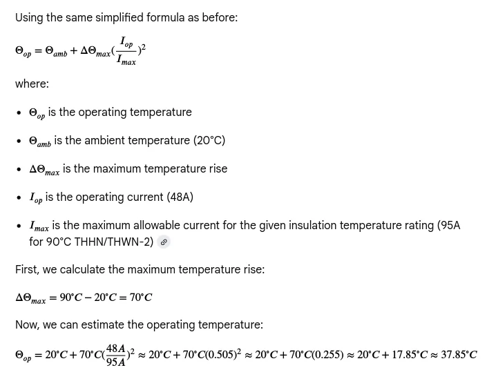

It can't get hot though, that's the point. The only reason it got hot in this case is arcing. Here is what the AI calculated for a couple of examples :
4AWG copper @ 48A
Tesla Cybertruck Almost Burned my House Down... Thoughts / Theories? Screenshot 2025-08-20 at 14-45-08 calculate temperature of conductor based on current - Googl
Now 4AWG @ 48 Aluminum
Tesla Cybertruck Almost Burned my House Down... Thoughts / Theories? Screenshot 2025-08-20 at 14-50-40 calculate temperature of conductor based on current - Googl
I think the short copper run above was 6AWG, so just case another calculation
Tesla Cybertruck Almost Burned my House Down... Thoughts / Theories? Screenshot 2025-08-20 at 14-52-56 calculate temperature of conductor based on current - Googl
4AWG aluminum and 6AWG copper ended up giving the same result

Right... I'd be not very inclined to lookup the formulas and do such math by hand, so AI is quite useful... assuming it's even remotely correct and doesn't BS us :D :D :D
It's even simpler. The highest temp column is 90 C.
Electrical tape comes in 90, 105, 180, and even 260 C varieties so even the cheap tape shouldn't see it's limit. However, the 180 self fusing rubber type is often used followed by 105.
