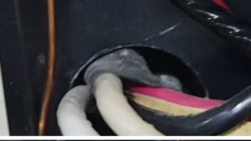

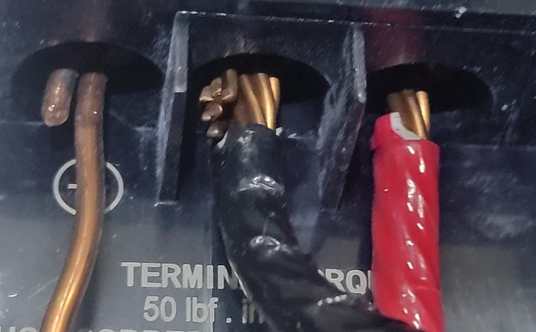

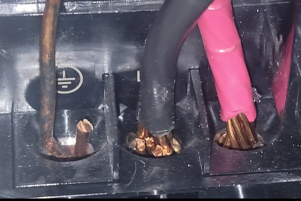

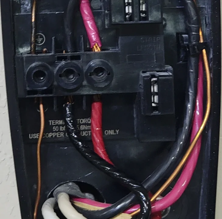

This thread inspired me to do an inspection. Two Tesla chargers daisy chained master-slave. Configured for 48A max. About 3 years of service with both chargers (another 5 years with just one). 60A breaker. There is some black gunk on the ground wire which appears to be left-over electrical tape residue - not oxidation). It does appear the feed on the bottom may have gotten hot enough to glass the outer surface of the insulation on the black wire but no signs of oxidation on the copper. Any code violations or other concerns?

Did you re-torq the terminals, at 50 in-lb? If so, did the screws rotate, in order to again meet the torq spec?

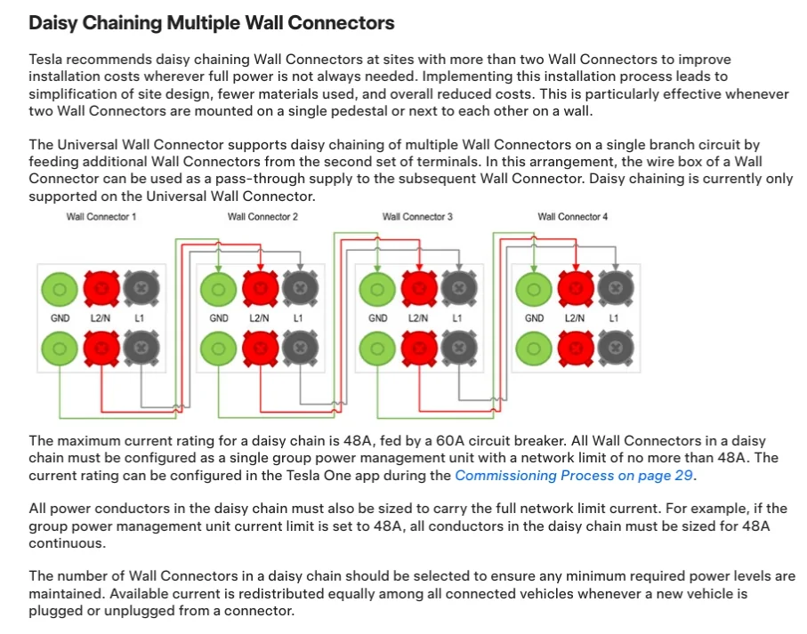

Only the Universal Wall Connector has the double lugs for pass through

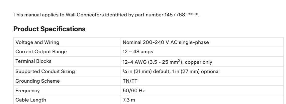

Further, that is NM-B so needs to be 4 AWG, and the terminals have a max gauge of 4, so doubling up violates that spec also.
