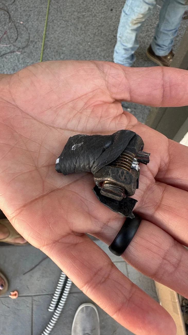

There is no issue using properly sized and terminated aluminum wire
That looks like a split bolt with copper wire and aluminum wire in direct contact. Your electrician is an idiot.

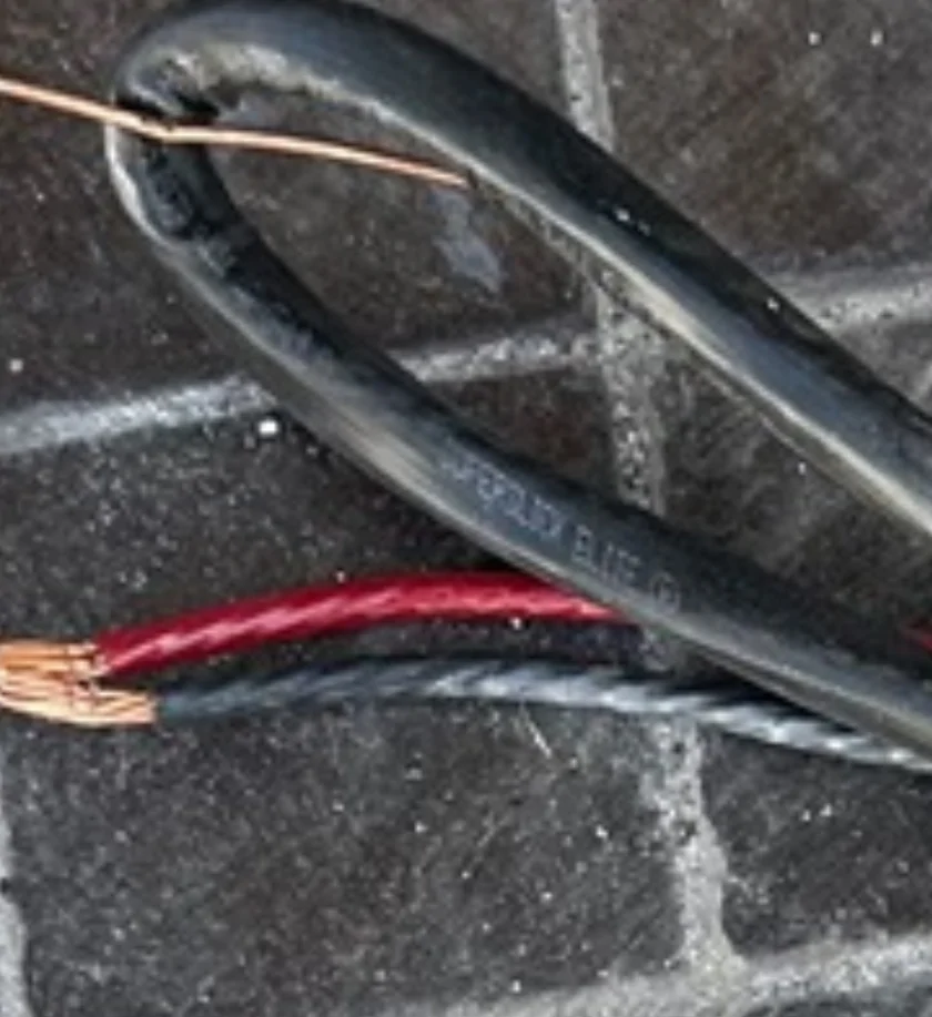

The short run to the WC was 6/3 NM-B and undersized, but the thermal issue was likely due to the wrong split bolt being used to join the aluminum to the copper.

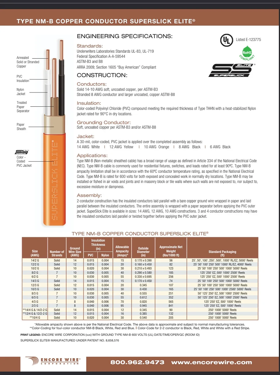

Talk me through what you are seeing and the chart you posted please?
May 27, 2024
4,605
5,595

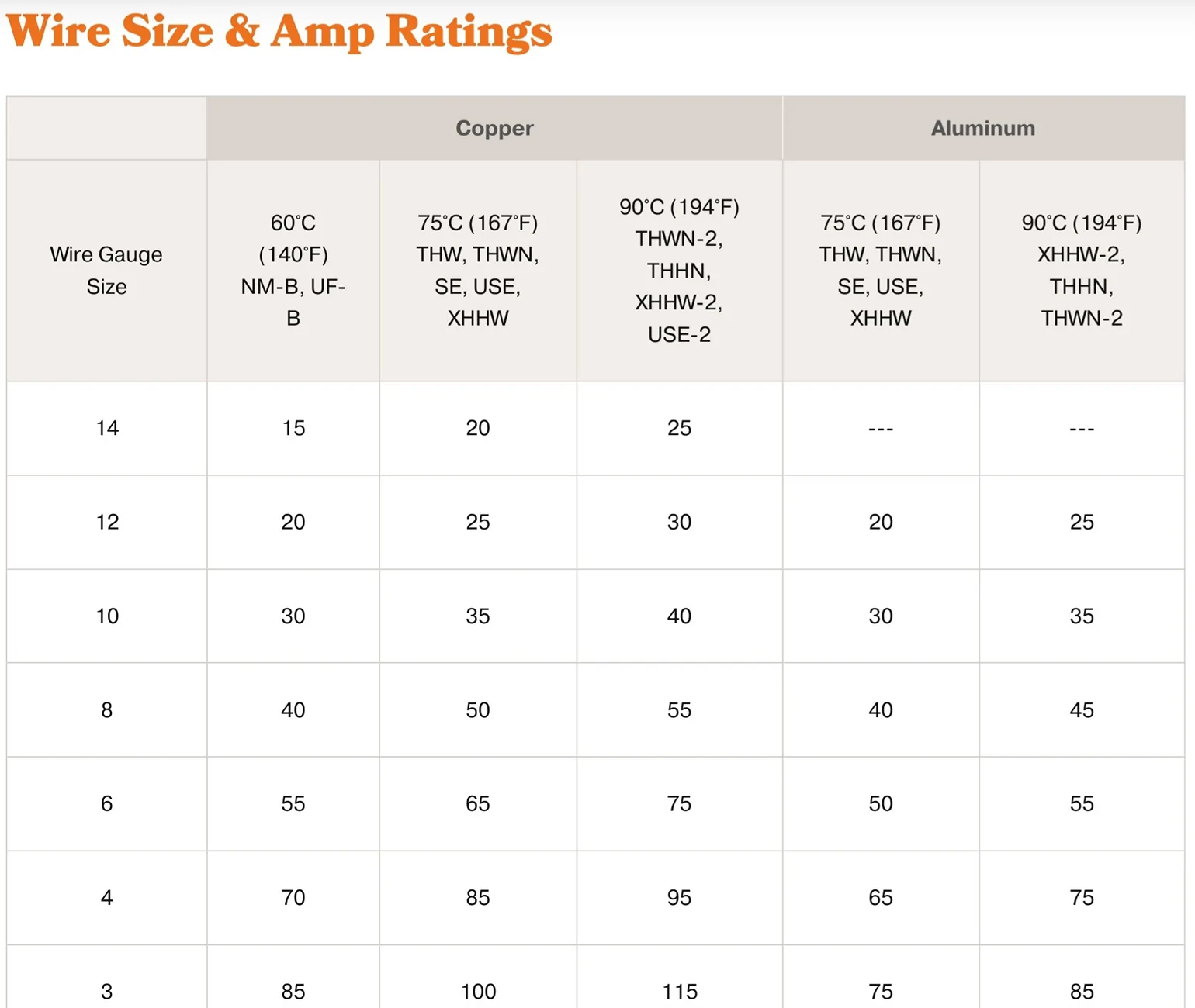

The chart is from the manufacturer of the short length of copper wire (Superslick Elite). Black outer sheath indicates 6 or 8 gauge. If it was 6/3+Ground, that is only rated for 55A. Applying the 80% continuous load derating, that means 44A max allowable charge current.
Regarding main panel to the disconnect:
Aluminum wire is less conductive, but service entrance (SE) uses the 75C column for current rating rather than the 60C that NM-B type does. Still, 48Amp charging reguire 60A capacity which would be #4 in Aluminum. If that is #6, it is undersized.
