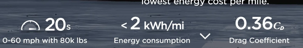

For someone smart :
Does the 300 or 500 range versions already allow for the .036 drag co-efficient ?
Does .036 drag co-efficient mean a 36% drop in potential distance a truck could travel without a load ?
I take it that advertising should match the likely use... if it says 500 miles, it should mean with a full working load.

If it travels about 2kwp per mile.. 1000 kw of batteries loaded with 80k lb. How far could empty semi travel with that same 1000kw ?
Or maybe I mis-read. Maybe its 500 miles when empty, and you take off the drag when loaded.

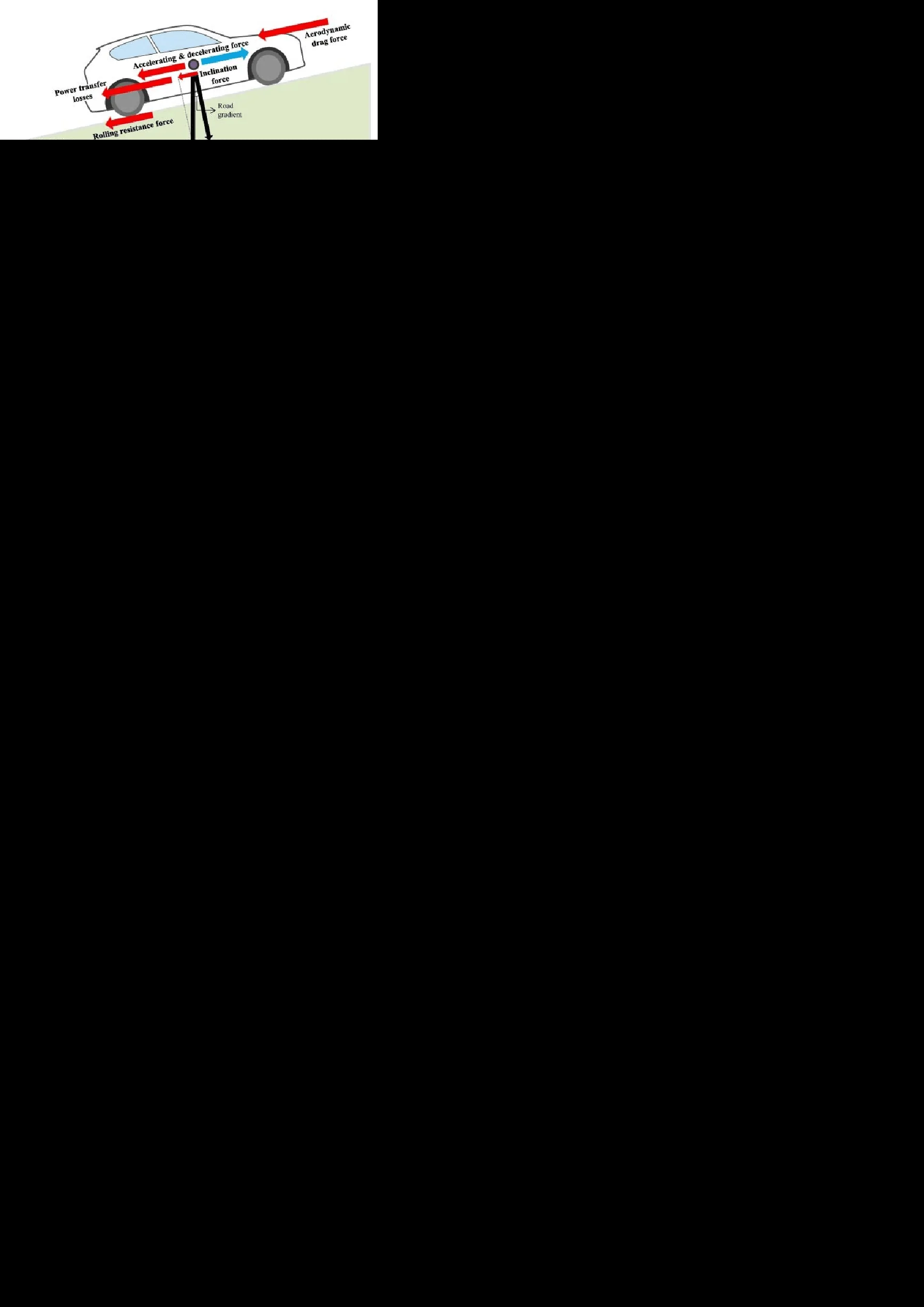

So there are multiple forces acting on the vehicle to reduce range and looks something like this:
Tesla Cybertruck CT end of life Different-forces-excerted-on-the-EV
As you can see the aerodynamic drag force, power transfer losses, rolling resistance and inclination force all consume energy in order to power against them. If you apply a force over a distance you do work using power (watts), and if power is required over time it uses energy (Wh). Hence the energy used in a EV is expressed in Wh/km or Wh/mile. Wh being watt hour, and kWh being kilo watt hour. This means that the simplest method to encompass all forms of energy use listed above, that is used in a vehicle is simply "Wh/km", being specifically Watts, hour and distance in meters. For energy you need to have a time component, (h) otherwise it's just power in W or kW.
If you know the Wh/km energy consumption rate for the EV then it's just a matter of sub-dividing the anailable battery pack size in kWh by it to figure out range.

ty Jbeeee, great.
So
The Semi has a >< 1000kw battery, it can travel 500 miles with a full 80k lb load.
And BTW, the drag coefficient is 0.36.
We can't have free energy. Energy is consumed by factors in your illustration.
I surmise rolling resistance / accelerating / decelerating forces would be effected by weight.
________________________
If the Semi sets a precedent, the CT's advertised range also includes carrying the 1.5 tons.
I know I won’t be loading that much and should gain some miles.
Maybe why the CT's rating is 500 miles +
Have to see what the '+' amounts to.

No worries. I don't want to sound pedantic, but it's important to use the right units when describing things. So for battery "energy" capacity use kWh and for "power" use kW.
I referred to CT aerodynamic because it wasn't clear in your post that you were talking about Semi.
Rolling resistance is affected by weight, but vehicle inertial state, being velocity, need not add extra energy consumption that is not recoverable through coasting or regen braking. That means acceleration and deceleration forces can, and often do, cancel themselves out when driven appropriately, which would be the case in day to day use.
As such range reduction due a load in the enclosed CT would be limited to drive train, rolling losses, and to some extent inclination losses should the journey not return down the same hill.
Rolling losses however are not as pronounced or variable as aerodynamic drag at low velocities, as such a small load is unlikely to significantly improve range by itself.
