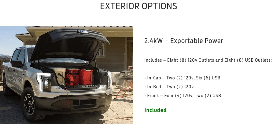

Ford F150 capability for comparison. 30a 240v 7.2kW
"Configured with the top-tier Pro Power Onboard system, the F-150 Lightning can deliver up to
9.6 kilowatts. One circuit serves the sockets in the cabin and the frunk, good for 2.4 kW.
Meanwhile, twin inverters in the rear bed deliver 3.6 kW each, and can be ganged up to a single 240V outlet to act as a single 7.2 kW supply if so desired."
via: https://www.thedrive.com/news/the-ford-f-150-lightning-can-charge-five-cars-at-once
2.4 kW @ 120v = 20 A
3.6 kW @ 120v = 30 A
7.2 kW @ 240v = 30 A
Keep in mind that the base model Lightning Pro ( priced originally at $40K but now $56K) 240mi range does not include any 220V outlets and the maximum output is 2.4KW not 9.6KW nor 7.2KW.
9.6KW Pro Power On-Board is an option.
Also regular consumers (non-fleet) buyers of base model Lightning Pro ( priced originally at $40K but now $56K) can NOT buy the extended range battery 320mi range option.
For regular consumers the Lightning XLT model is the least expensive model where extended range battery 320mi option can be chosen. The lowest price Lightning XLT with the extended range battery 320mi range option is $81K and this price also includes the 9.6KW Pro Power On-Board feature.
2023 Ford F-150 Lightning Pro
Tesla Cybertruck Cybertruck as work truck / for construction work? 1676311363624
https://www.ford.com/trucks/f150/f150-lightning

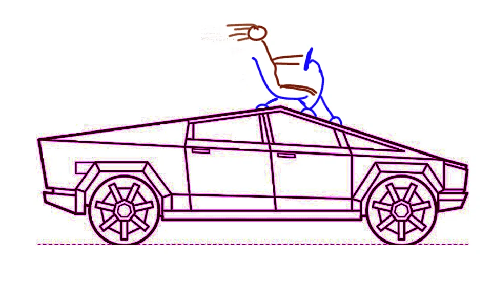

What’s the big deal? 99% of the pickup trucks out there never haul anything in the back bed portion. A salesman once told me that the selling point of driving a pickup truck is the higher elevation in the driver’s seat. It called the “Commanding View”.
Since the Cybertruck rides low by default, maybe a good aftermarket product for the Cybertruck would be seats that suction cup to the roof of the cab so people can enjoy that “commanding view”.
Tesla Cybertruck Cybertruck as work truck / for construction work? 1676325481470
Drive by wire makes this all possible. The optional bubble cockpit with fairings and mega-oodles frunk will also be available.
