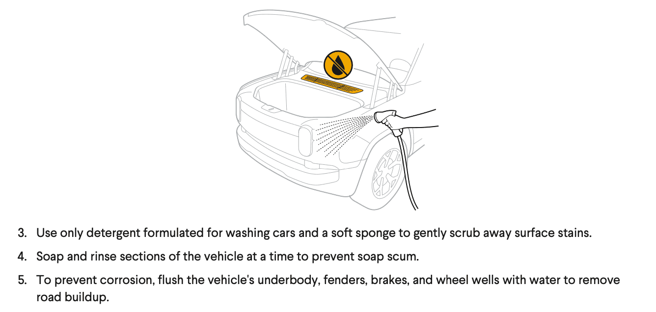

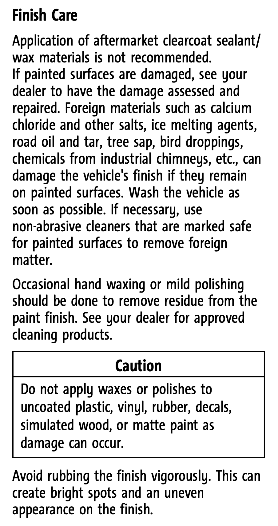

I do keep seeing people say, "all car manuals have these type of disclaimers about corrosion." What I haven't seen is anyone actual show proof of that. So if I look at a Rivian or Hummer manual, there's corrosion warnings? These vehicles also don't cover the body corrosion under warranty?
I looked and couldn't find any real world evidence this is something all vehicle manufacturers mention, but I'm also a terrible investigator.
Here are Rivians and Hummer EV's, from their owners manuals

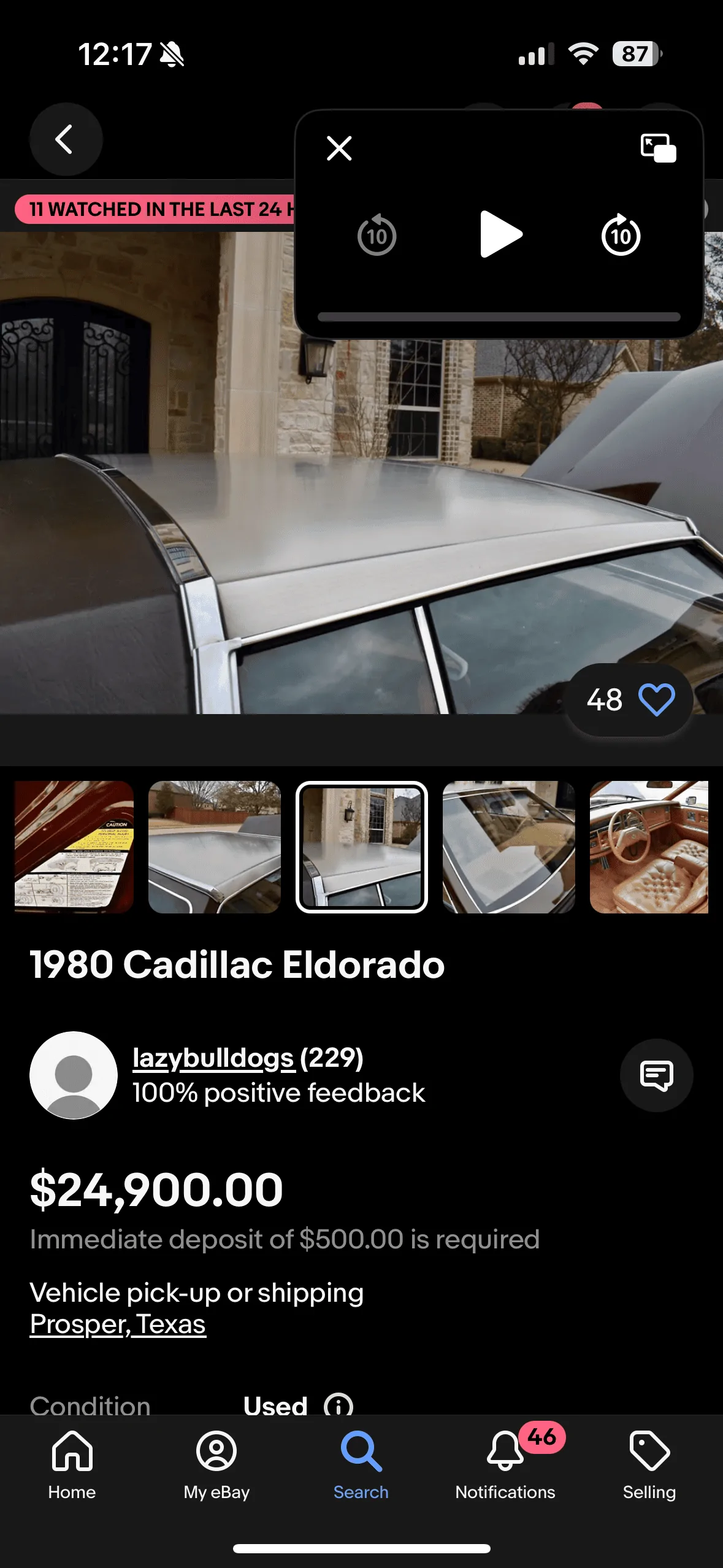

The Cadillac Eldorado Biarritz from 1979 through 1985. Also had a full brushed stainless steel roof.
And unlike DeLorean that almost all sat garages for most of their lives, most of these Cadillacs sat outside and they never developed rust on the stainless steel roof. Tesla is using a different alloy formulation.
The 1957 and 1958 Cadillac Eldorado brougham sedan also featured a stainless steel roof, and those too are still in perfect condition. Without rusting .
