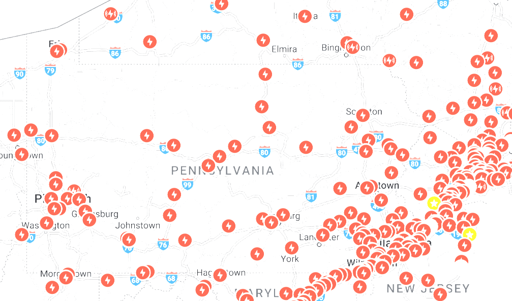

Aaah, long charge times will not be great, but that is more of a nuisance, as opposed to trying to make it across the middle of Pennsylvania going North and South and the Charging stations are 220 miles apart. Sigh.
Looks to me to only be about 100 miles. But I guess that there are some backroad routes that could be 220 miles.
For reference near the left, between I-86 and I-80, those are only 100 miles apart.

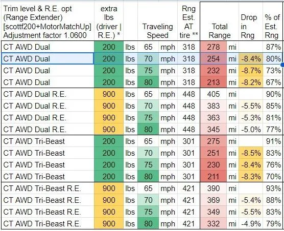

I added an adjustment factor to the Total Range to make it line up with Kyle's test. Here is the range at other CT AWD Dual speeds as well as the other trims.
