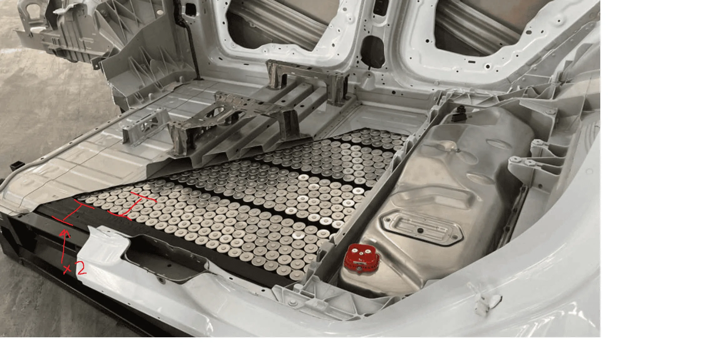

We don't really have enough information to calculate the width, I made a rough estimation. Take a look at the picture below of a 4680 structural model y. They put a spacer in the side of the pack here, it just happens to be roughly exactly the width of half a group of cells. There's two of those spacers. This leads me to speculate the model y can support 5 groups of cells for a long range model (I went into that above).
Given that the Cybertruck is wider than the model Y, 5 groups of cells was a safe assumption (so I think).

Fair - what I am trying to accomplish is pulling in all known facts and data related to 4680 yields+production as well as structural packs to show whether or not its even -possible- for Cybertruck to have 500mi of range out of the gate. I am the biggest TSLA bull in the world but I just don't see it being 500mi in 2023. The goal of this thread is to back up my claims. Would absolutely LOVE to be wrong here.
From a practical business perspective it also doesn't make sense for Tesla to burn through extra cells on the range of CT to achieve 500mi. It only made sense if the density improvements were made, and unfortunately, we aren't there yet.
I have no doubt we will see a 500 range CT at some point in the future just not anytime soon.
