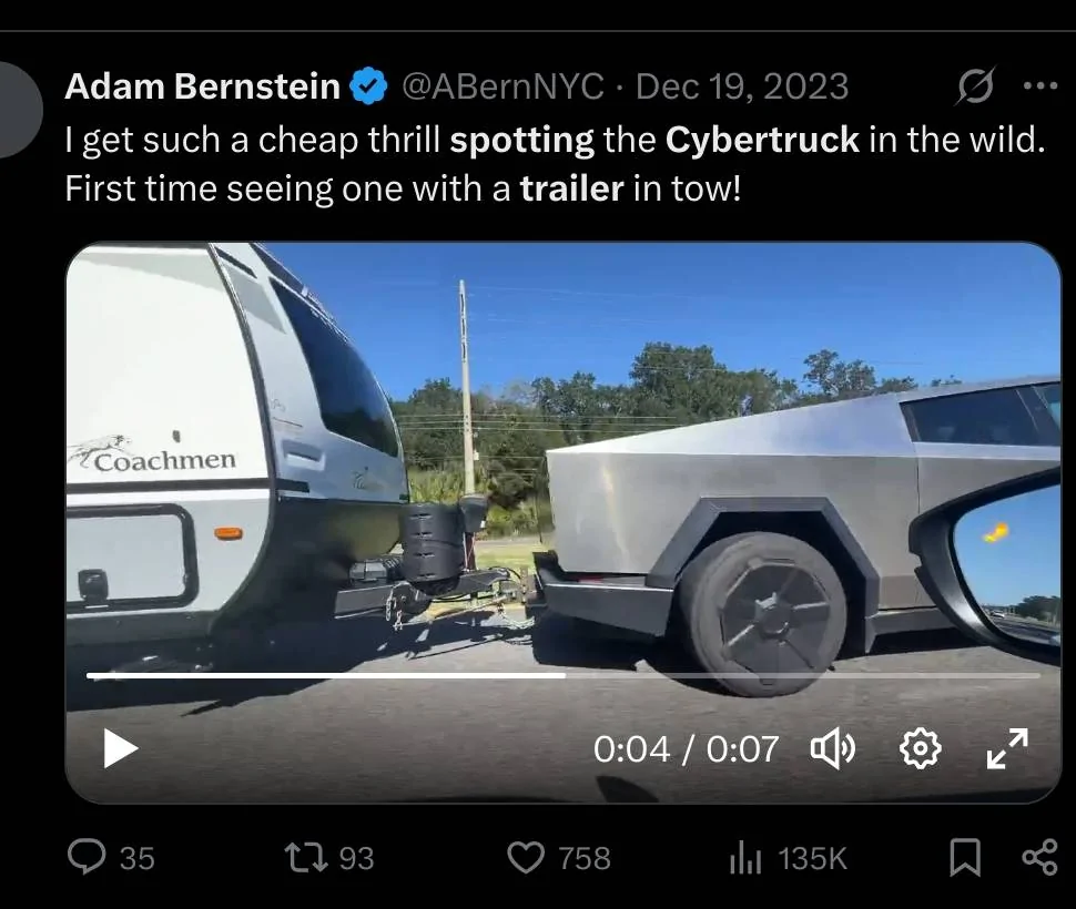

Why would a pothole create a surge in weight on the hitch ? What's the physics of that ?
Drive a loaded trailer over one and watch the load :)
But in seriousness a pothole or dip at speed creates a sharp difference in elevation from the vehicle to the trailer, essentially dropping it off a small cliff, the force can be significant.

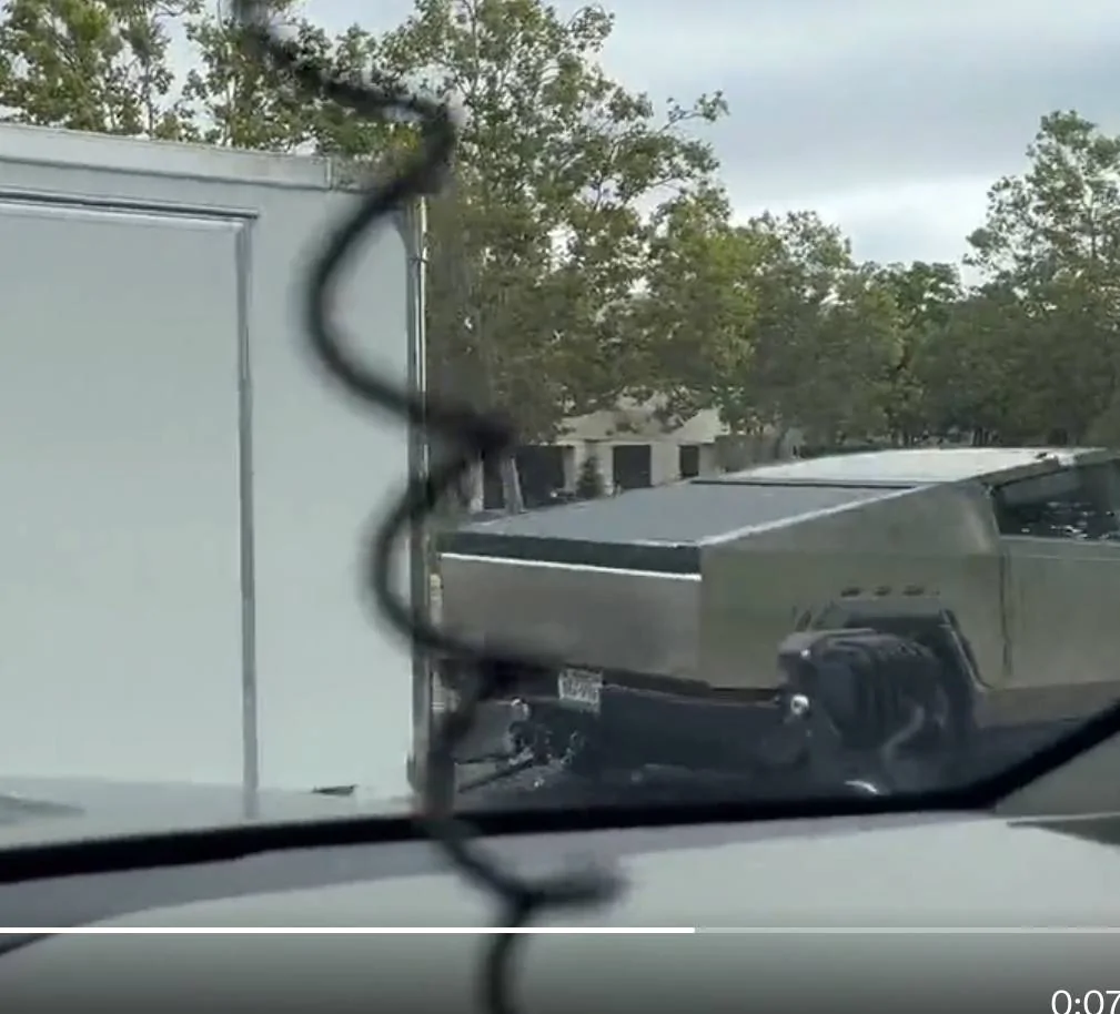

Plus, Tesla used WD during their testing (but good luck trying to find those images now ?... ok I found some)
Tesla
Tesla Cybertruck Cybertruck Trailer Hitch/Casting Failure @10,400 lbs *VERTICAL LOAD* SmartSelect_20250312_182025_Firefox
Not tesla:
Tesla Cybertruck Cybertruck Trailer Hitch/Casting Failure @10,400 lbs *VERTICAL LOAD* SmartSelect_20250312_181413_Firefox

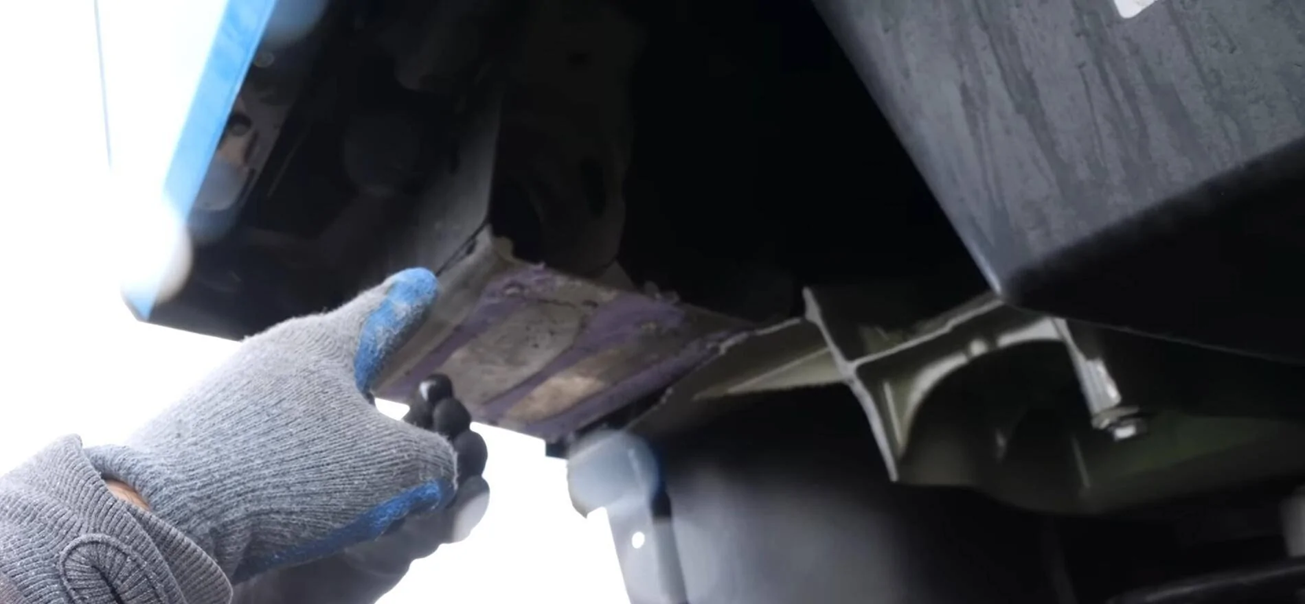

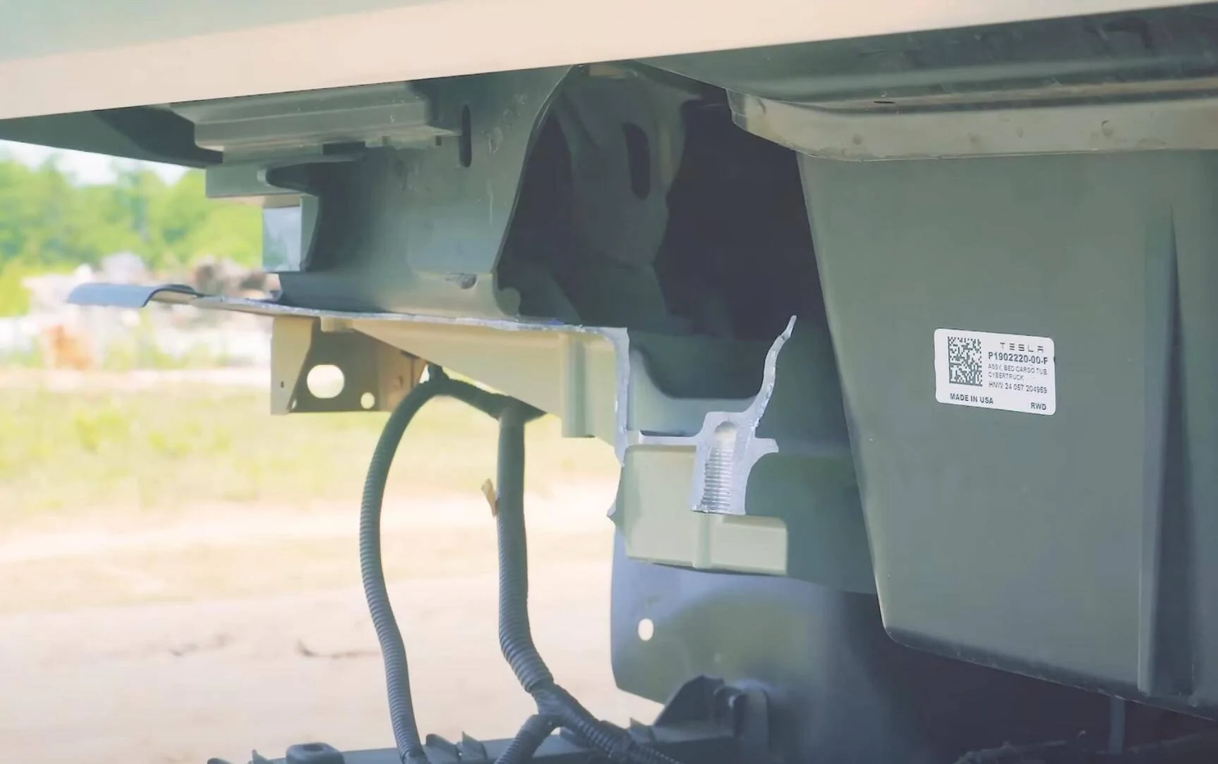

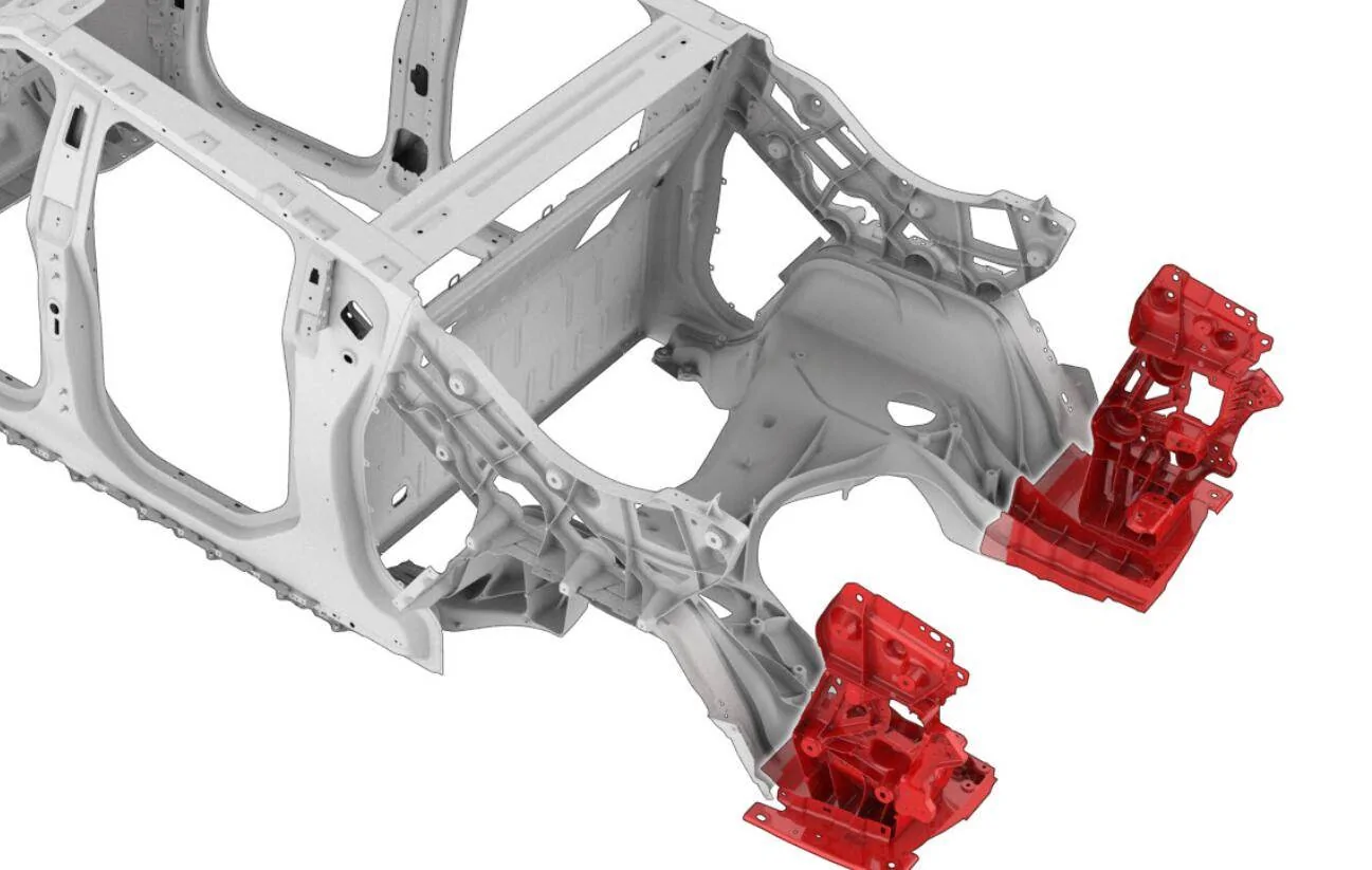

TLDR - this is crash structure and the truck is breaking at the intended location and at the intended strength.
Anecdotally, I've towed a buddy's 9k lbs trailer that maxed out my tongue weight for a few hundred miles of i20 with plenty of bumps and potholes. Also did a handful of full pulls when merging onto the interstate. Air suspension does a great job automatically leveling with various tongue weights. My cybertruck has been absolutely outstanding and I have complete confidence in the towing performance and safety, although it's quite entertaining watching youtubers come up with crazy tests.
Quite interesting to see the different failure points. JerryRigEverything's cybertruck seemed to fail where the frame rail section of the rear under body casting meets the tailgate towers. That area has both spot-welds and structural adhesive in the collision repair manual.
Tesla Cybertruck Cybertruck Trailer Hitch/Casting Failure @10,400 lbs *VERTICAL LOAD* 1741822257683-1d
Both the welds and the structural adhesive had to fail for the separation we saw in the video:

Interestingly, this is part of the crash structure in the giga-casting. The ribs at the end are designed to break off during a crash, as highlighted below. From the collision repair manual, it looks like both front and rear castings are designed this way so a partial casting can be riveted back together.
Tesla Cybertruck Cybertruck Trailer Hitch/Casting Failure @10,400 lbs *VERTICAL LOAD* 1741822367983-jh

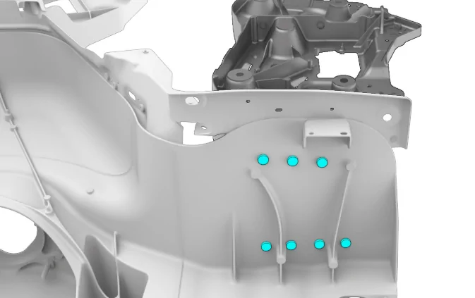

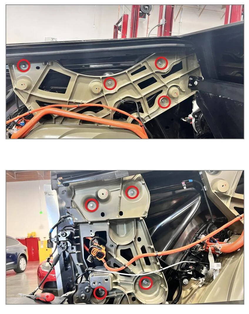

This demonstrates exoskeleton design for the bottom casting to pull away from the towers. Those towers are secured with 4 bolts to the stainless steel side panel which is secured to 4 bolts on the mast assembly.
Tesla Cybertruck Cybertruck Trailer Hitch/Casting Failure @10,400 lbs *VERTICAL LOAD* 1741825919547-c
The stainless panel was supporting the 11k lbs of force.

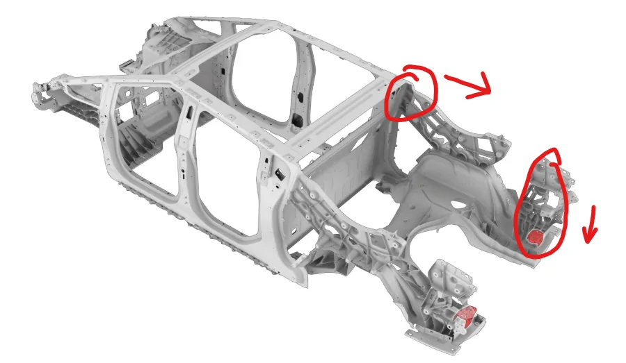

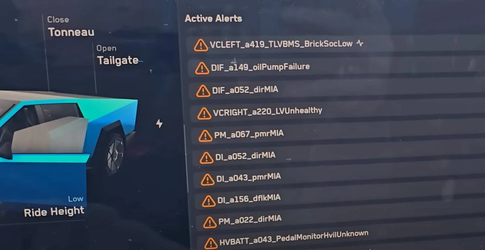

JerryRigEverything's wouldn't go into drive, and had a high voltage BMS alert showing one of the battery bricks had a low state of charge. This means downward forces on the front and rear simultaneously caused the battery pack to bow and flex like breaking a candy bar. Because we see an actual brick alert and the BMB didn't just go MIA, I'm thinking actual cells were being split from the brick bonding wires like pulling grapes. This implies some cool things - both the stainless exoskeleton and structural battery pack are real.
