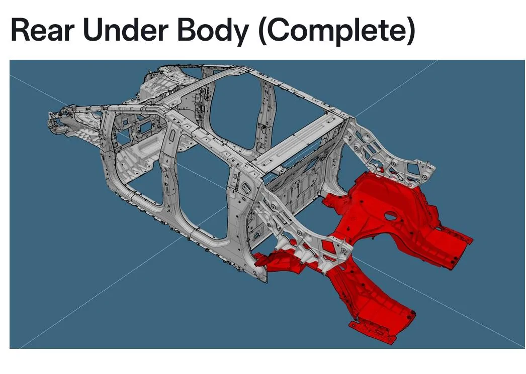

Structures Engineer w BS and 28yrs as an Aircraft SE FedEx / Boeing / Airbus. Good test
Fix
Easy fix a doubler on the casting or better to just increase the casting thickness. Easy fix is to get a better shear strength adhesive with a few what is called chicken fasteners.
If it were me as a Tesla Engineer I would do both
and
Add a water proof sealer outside of that adhesive bond area. Weakest problem with adhesives is hot / wet strength so one fix would be eliminate the wet.
Problem
Road salt or cracks in adhesive / casting due to prior use will cause a premature failure.
You should reach you to Tesla.

Fix
and
Problem
Why do think it needs further strengthening?
AFAIK, from the factory, the hitch loading path doesn't include adhesives. That's only for repairs.
