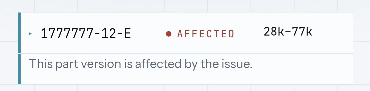

We can verify the site accuracy with rev# from people who already got PCS replaced.
The website is accurate. I had my PCS replaced over a month ago and the website shows my VIN as having rev G.
You can use it to check what Rev you have.

Is the “28k-77k” the VINs that are effected?

Thanks, my version is E and VIN @35K. I thought it might mean that those VINs had a known defective PCS. Fortunately, mine is still error free 🤞 but I am dropping the amps to 24 until I hear they have the verified fix version in stock. ( I have free lifetime SC and it is working too. )
