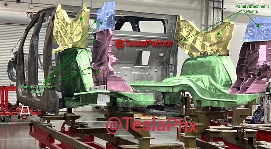

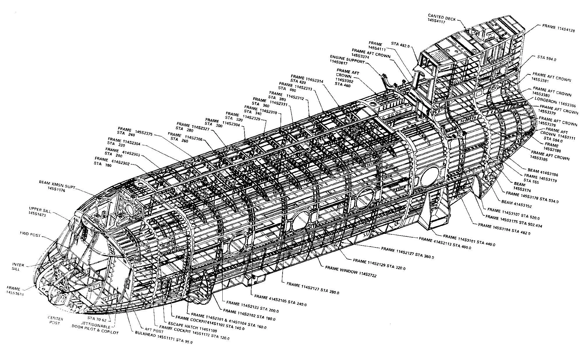

Thinking on how aircraft structure works (atleast on helicopter that I worked on) the skin is a stressed member.
You will not get the strength and rigidity needed for a large bed payload nor tow weight without some structural member connecting these components.
The advantage of the triangle shape for strength would not be possible with just the structure as shown. I think much like an aircraft has structure and is considered to be an exoskeleton, then the Cybertruck is an exoskeleton as well.
Tesla Cybertruck First RC (Release Candidate) Cybertruck from Giga TX is Out Front of GFTX for Investor Call [7/19/23] CH-47_structure_threequarters_view_Larg
The CH-47 Chinook structure. It is very heavy and if you move it with some of the skin removed, it warps the whole frame. I am very sure it could not support its own weight and definitely not the tons (tonnes) it can carry inside or as a sling load without the skin as a structural member.
I, too, think the relevance of the skin to operational loads largely relates to the issues of payload, towing, and torsion - ie at the rear quarter panels.
and these discussions today wouldn’t be near as fraught with confusion or obstinance if there hadn’t been folks like Munro proselytizing about how “exoskeleton” means there will only be the skin performing operational load bearing
like your helicopter, it’s a mixed bag and what proportion the skin is performing operational load bearing depends on the load type/location
to be fair to Muroe and others, what they’ve proselytized was a fair interpretation of Musk’s comments on stage in 2019
but it was a marketing event, a short description, and always subject to change
