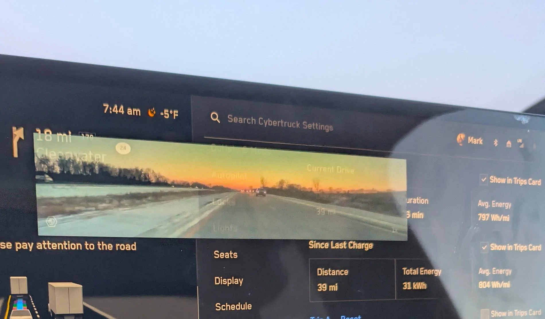

Really that's nothing. Put two dogs, a light SO, and 600 lbs of travel gear and ski stuff for a month of powder chasing.
Minnesota a couple weeks ago I pulled a hundred mile stretch where I averaged 804 wh/mi after leaving a supercharger. All warmed up.
Tesla Cybertruck First Road Trip 470miles - Horrible Efficiency - Cyberbeast w Cyberwheels PXL_20250114_134412327
-5F and 78mph into the wind sucks electrons.
I love how this thread tells the OP everything they are doing wrong, and to hit a supercharger. Not really addressing the efficiency or lack of.
Edit: added photo on energy usage.
