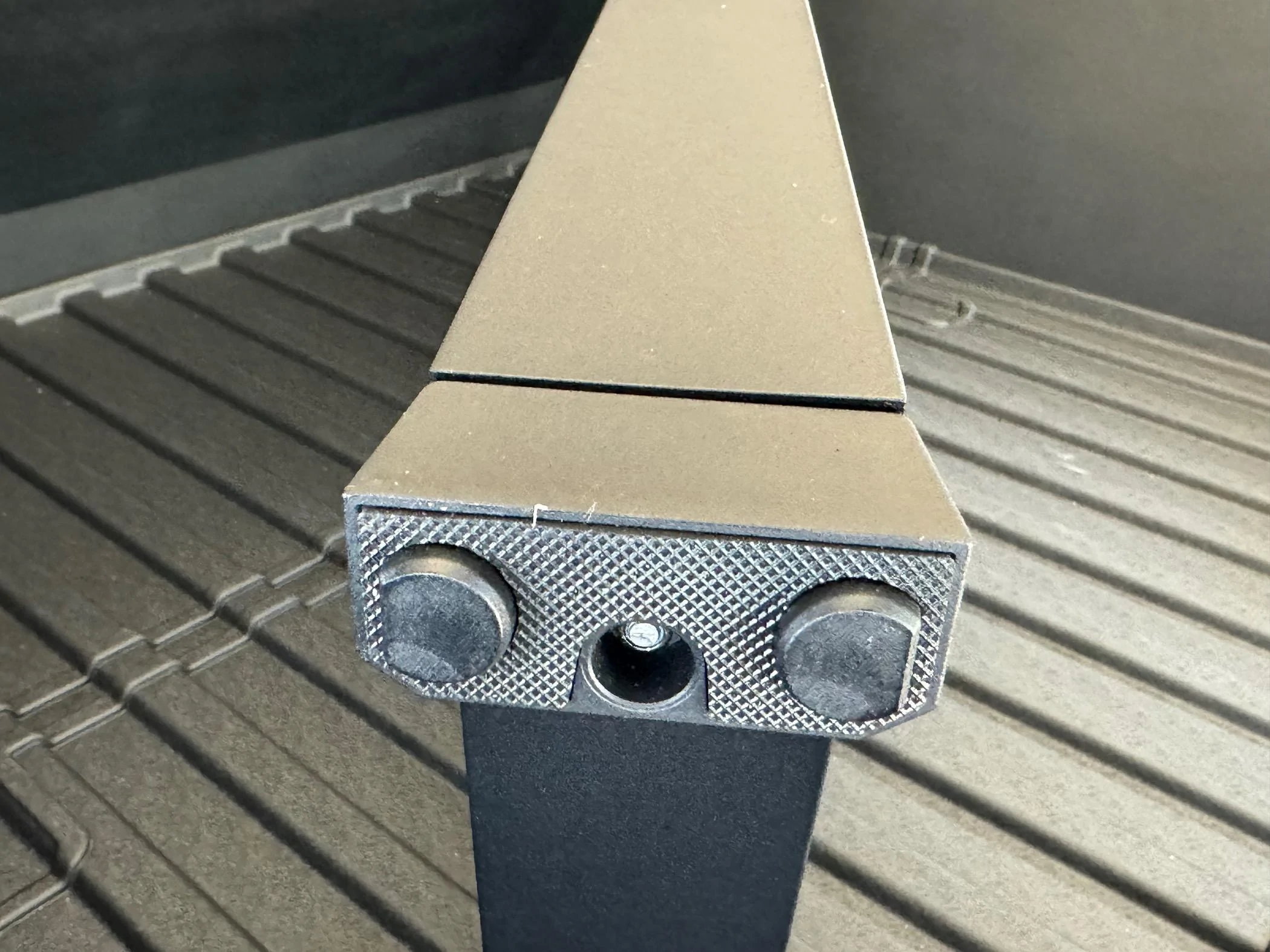

My divider arrived today... Yea same thing its to high in the back. I think I'm going to do the grind @okiebug posted.

Happy to report that the cut 1/3rd of the pegs posted above worked a treat. I used a dremel with a cutoff wheel and it took all of 5 minutes. Seems like it's locked in tight and solid and giving a hard push pull seems to have zero effect. I can lock in anywhere in the bed now front to back.

I have received the replacement bed divider and it seems to me to be identical in all respects to the original one. Identical part number too. Now having a spare, and because I installed a bottom bed linner, I modified the first one to fit. I used a drill to drill out rivets on the bottom that hold rubber pads on the bottom, and I cut off the top of the two buttons on the top of each side, so now it works well in every position. even with the extra height of the bed due to the liner I added.

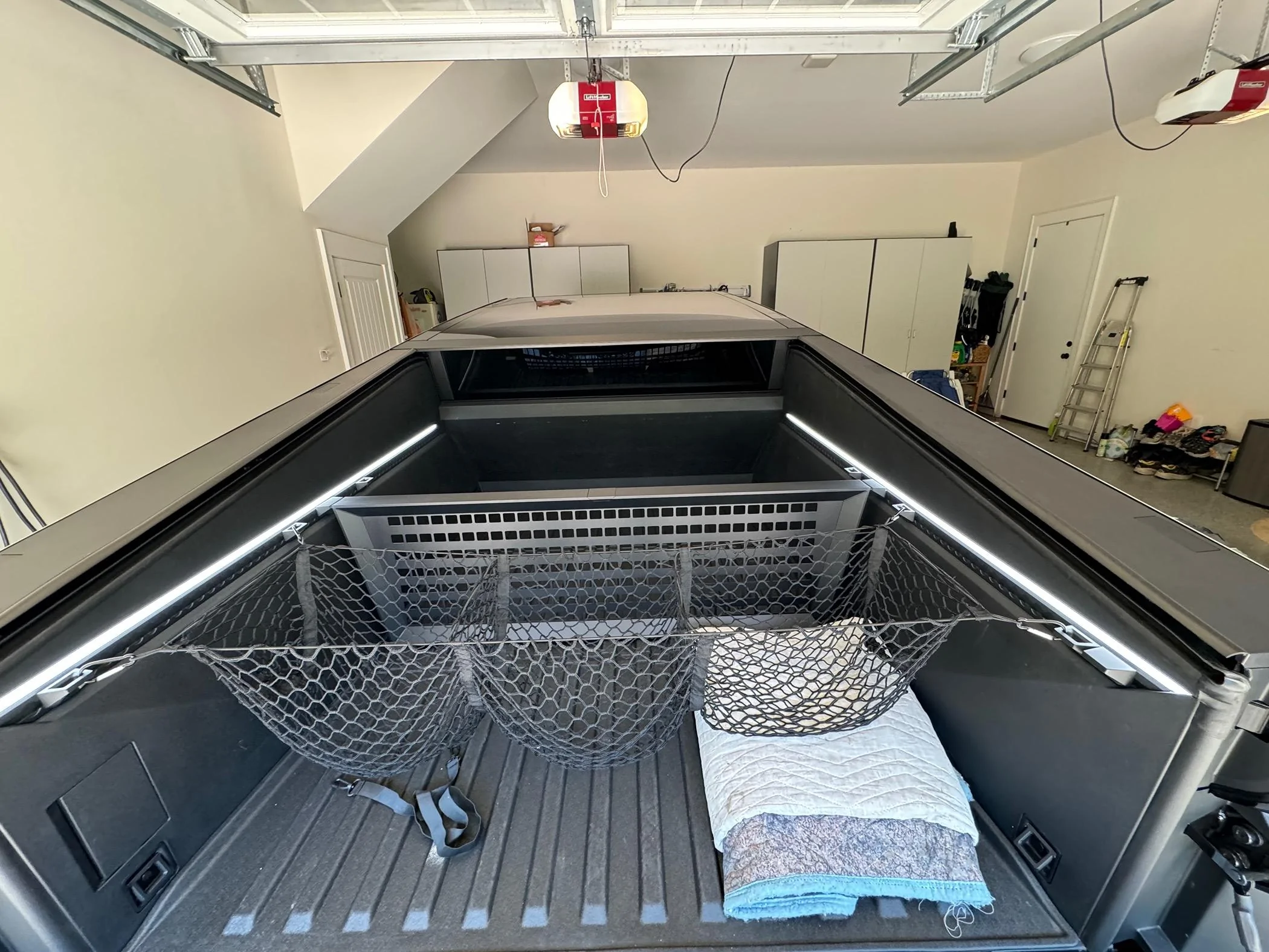

I was able to order a bed divider a couple of weeks ago. Installed it today. It fits all the way back., Even with my elecfresh bed protector installed.
Here’s some pics. Is this an updated divider or is my bed just flat?
