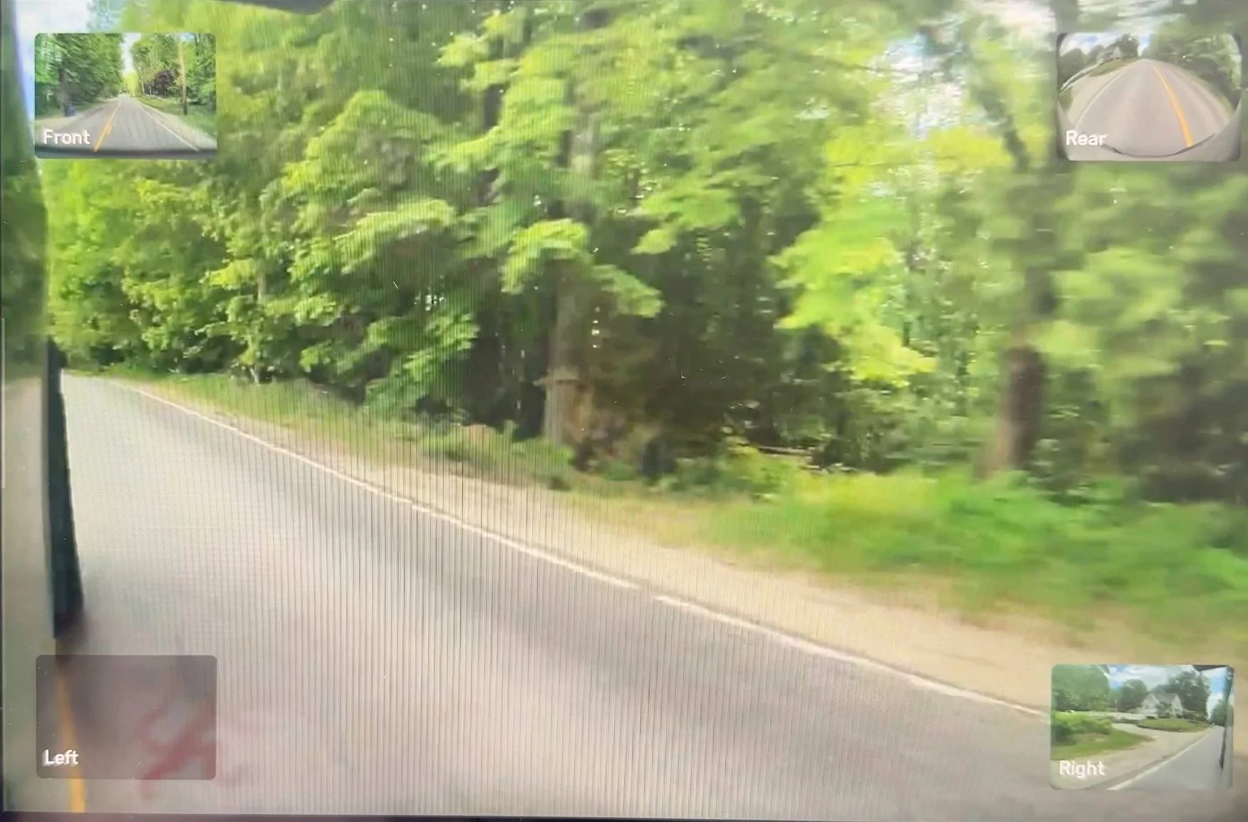

Yeah, it floats/drifts out of its lane on curves, as if it doesn't fully realize how much momentum it has. Just a few days ago, I recorded this crossing the center line on my narrow country road, at about 45mph. It only went about 6" over, but still, it shouldn't happen. I also have a 3 with FSD, that used to drift when we first got FSDv12, so I know it can be fixed. It's why Tesla needs more driving footage to train the neural net.
