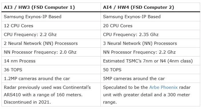

IDK if there's even the pretense of such redundancy in HW4, but I doubt it. It's a rare event to have the two parallel CPUs disagree, and even if they did you'd want the car to stop anyway.
That is unclear. I'm finding references to it in articles and the Munro video.
There is also a question if redundancy is 'required' for unsupervised ("level 4/5") FSD. ala RoboTaxi. [Level 4 Requirements: Level 4 autonomy means the vehicle can operate without human intervention within a specific Operational Design Domain (ODD)]
a)
One significant aspect of Hardware 4 is the reintroduction of redundancy. Each board in the new hardware suite has two nodes, which can compute the same data and compare outputs, allowing the vehicle to identify any inconsistencies. This redundancy feature, previously removed in Hardware 3 to maximize processing power, has been reinstated in Hardware 4, ensuring that the vehicle can continue driving safely even if one node fails.
Tesla Hardware 4 (AI4) - Full Details and Latest News - AutoPilot Review
Tesla Cybertruck FSD v13 and Hardware 4 Partition Limit HQNQEnZ
b)
The presenter mentions that the placement of the main harness connectors on each end of the board is related to the symmetry of the board and helps maintain hardware redundancy for safety [04:35]. They also emphasize Tesla's priority on safety [04:42].
