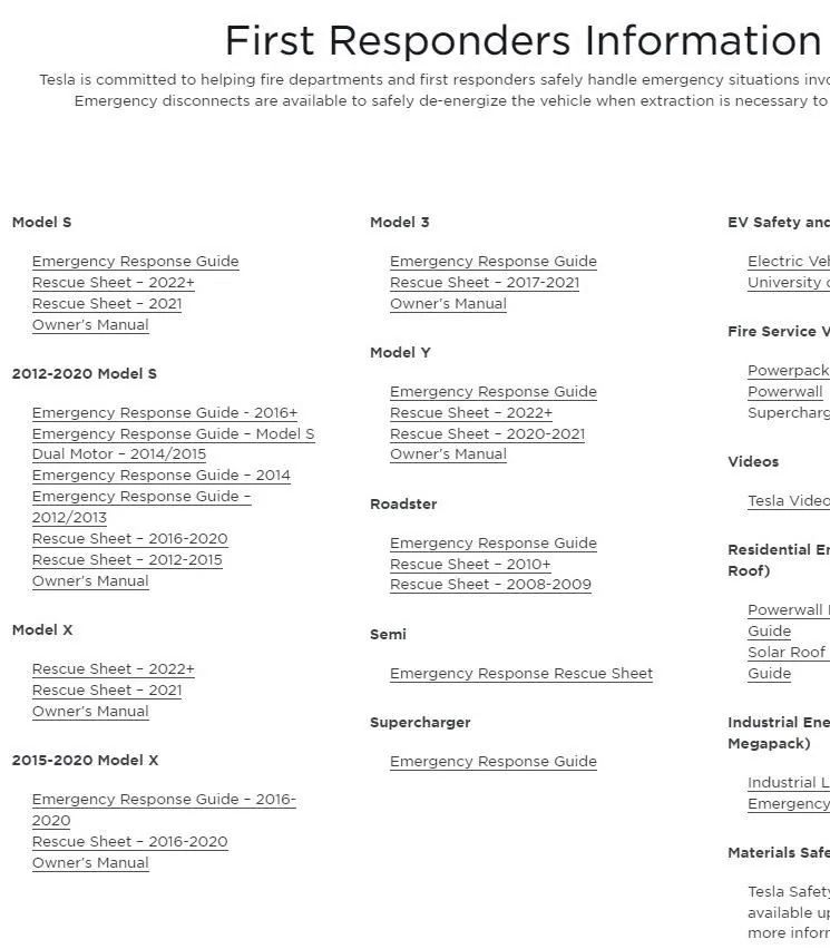

It is odd to me that Tesla does not have the Cybertruck on their first responder page yet:
https://www.tesla.com/firstresponders
Seeing that the last year listed is 2022, but the Model X is only shown as 2020, I don't find it surprising to me. But it's pretty much the same. Open frunk, cut big red wire marked as firefighter, cut here.
