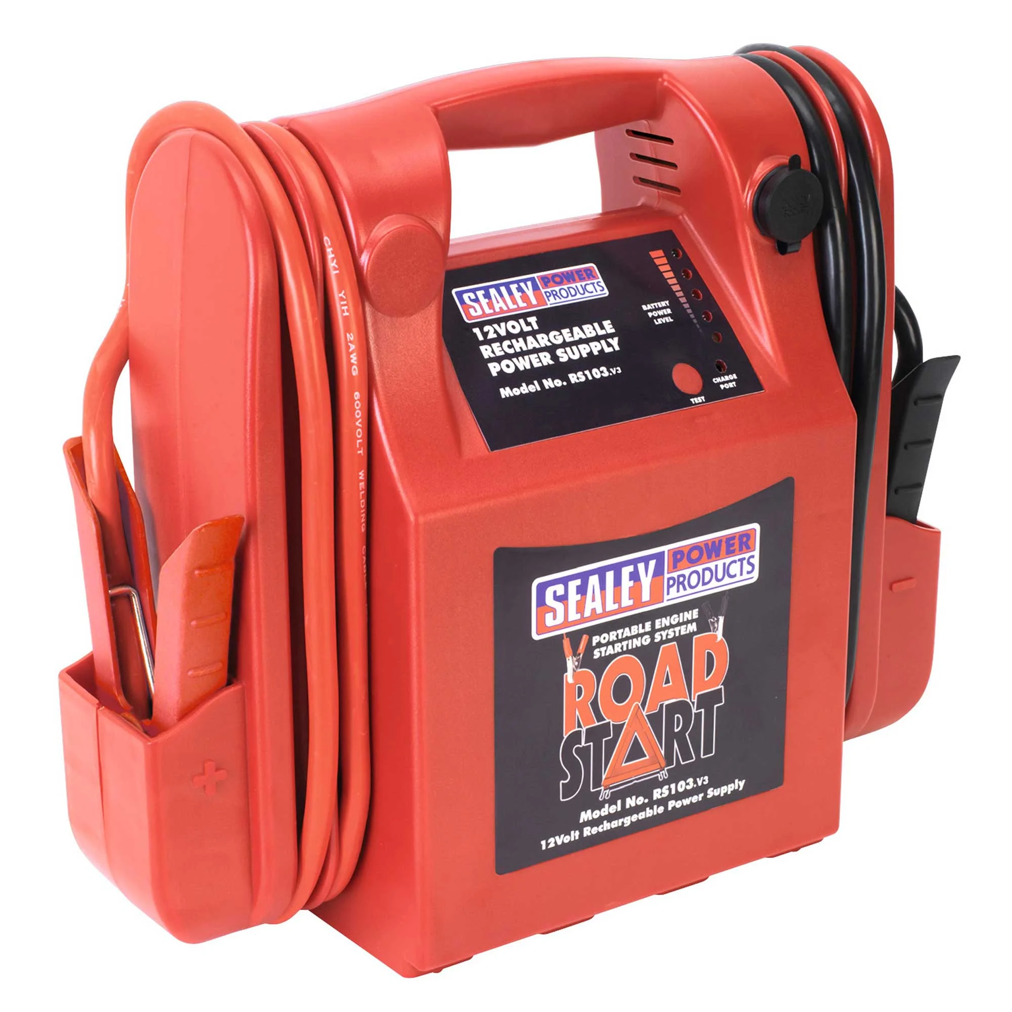

I have one of these and I'd use it. Not exactly portable.
Curious what that manual says. I don't recall that.
