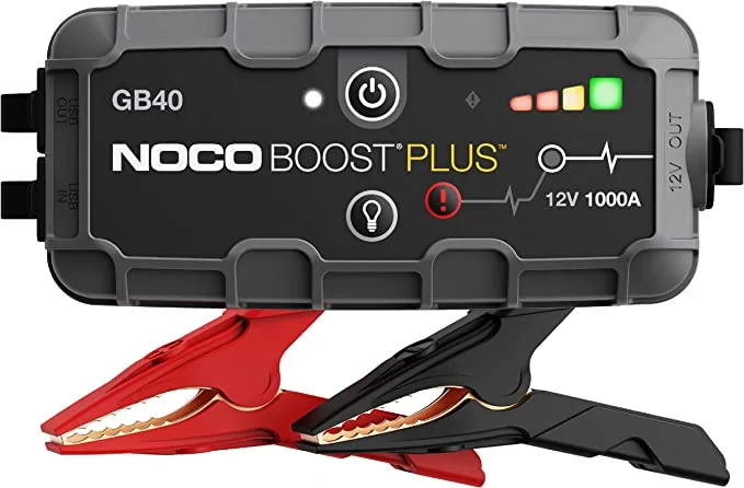

I swear by these and have one in every car...including my Tesla. Either to jump another ICE, or, jump my 12v computer if need be (although I've never actually had to try this).
Tesla Cybertruck How do you jumpstart an ICE vehicle from a Tesla? Noco GB40
