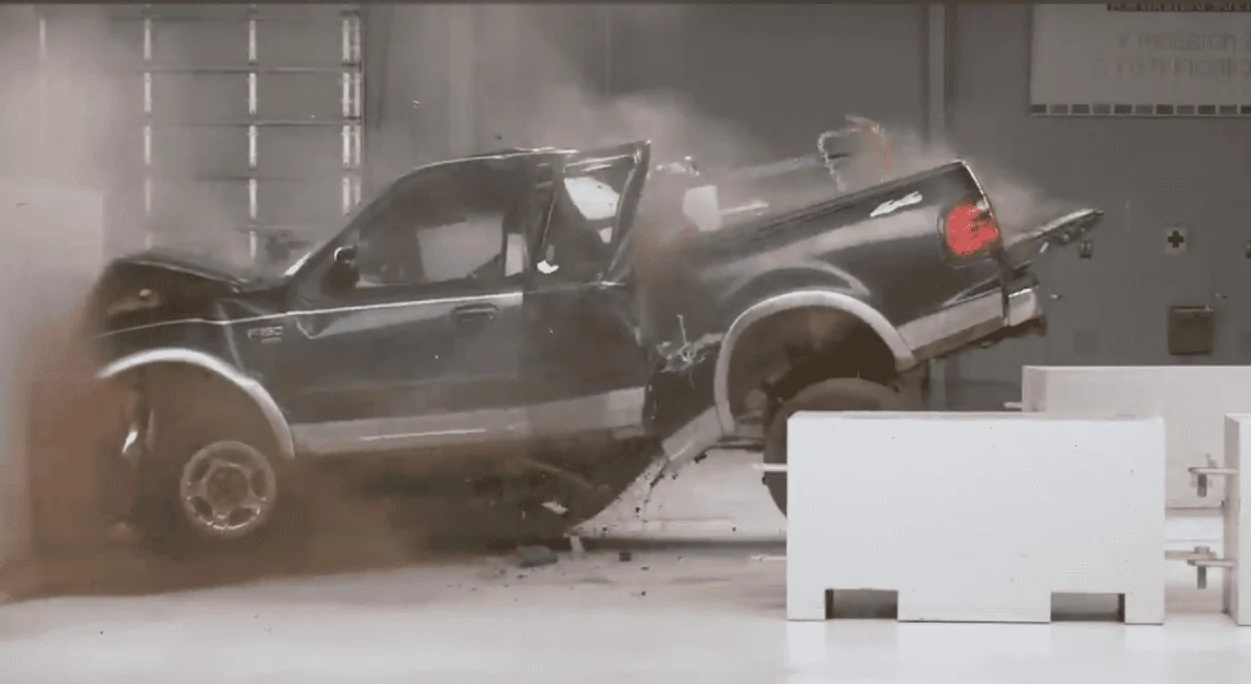

Saw this crazy video from the IIHS where they loaded up an F150 with concrete and smashed it into their test wall at 40MPH.
These guys were just testing their system out to ensure it could handle the weight, but seeing what this load did to the cab of the truck was … stunning.
That white block you see in the drivers seat of the truck was strapped down in the bed of the truck at the start of the video. If anyone was in the truck when this crash happened they would likely be dead. The load just smashed through the entire bed wall, rear seats, front seats and is now smashed against the firewall.
When people talk about 3500 pounds of cargo capacity, that’s the kind of crazy forces you are dealing with.
Also notable, the truck just accordions up, but not in a good way.
I no longer want a mid gate, plz make that rear wall tighter than a crabs ass hole on the CT!!!!!!!!!!

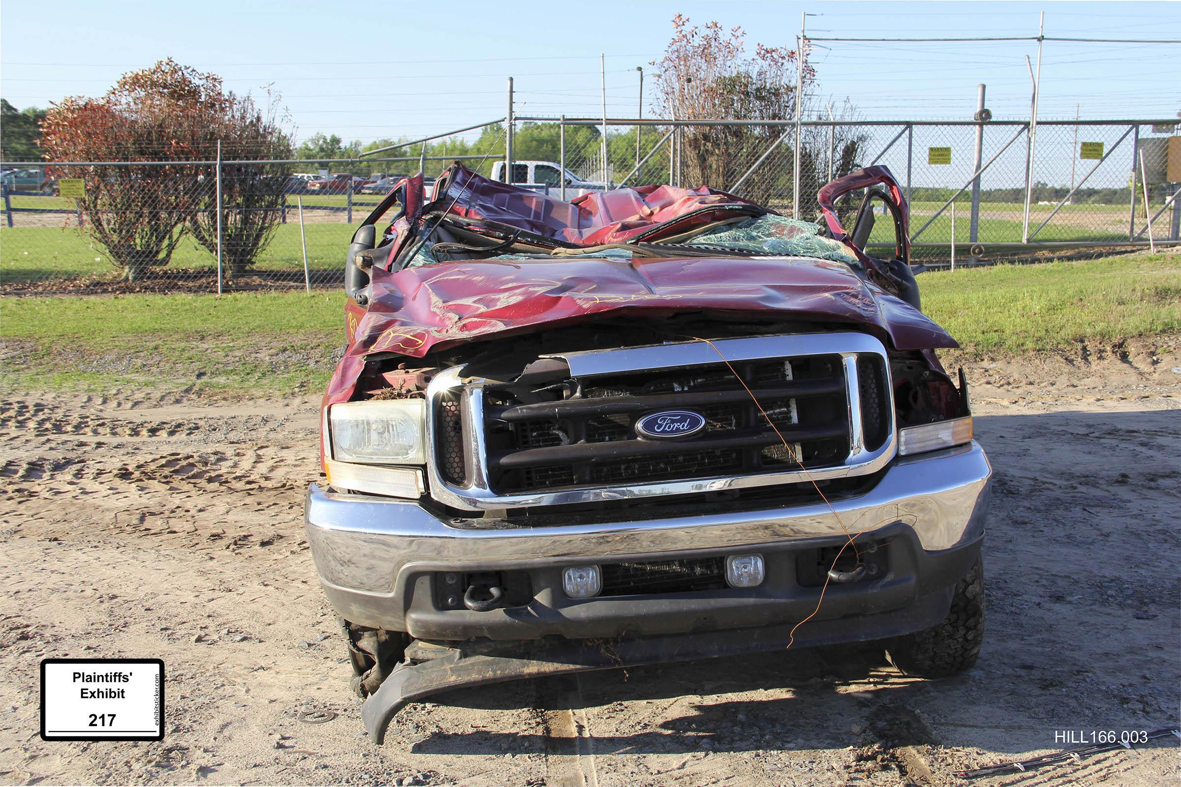

https://nypost.com/2022/08/20/jury-slams-ford-with-1-7b-verdict-over-deadly-2014-crash/ said:
Tesla Cybertruck Instant Compact F150 (Structure matters!) 1671598351137
Ford sold 5.2 million “Super Duty” trucks with weak roofs that would crush people inside during rollovers, the jury determined. The flaw was present in all “Super Duty” models between 1999 and 2016, their lawyer, James E. Butler said.
Attorneys showed evidence at the trial of nearly 80 similar wrecks where people had been killed or injured when the trucks’ roofs crushed them during rollovers.
Ford has refused to say how many similar incidents it is aware of. Nor has the car giant ever issued a recall, Butler said.

If they can made a driver's door that doesn't crumple in a T-crash, they can make a midgate that holds up to a load strapped to it.
Oh yeah, I was tad inebriated when I made that comment.
Lol sorry
But yes, I'm sure you're right. The approach is so different between the f150 and CT that it isn't a valid comparison to begin with, really. I had no idea the cab was so flimsy though.... 40mph really isn't that fast and..
Just wow
I've resolved to watch the crash tests of all future vehicles I purchase. Including, if available, a load in the bed.
