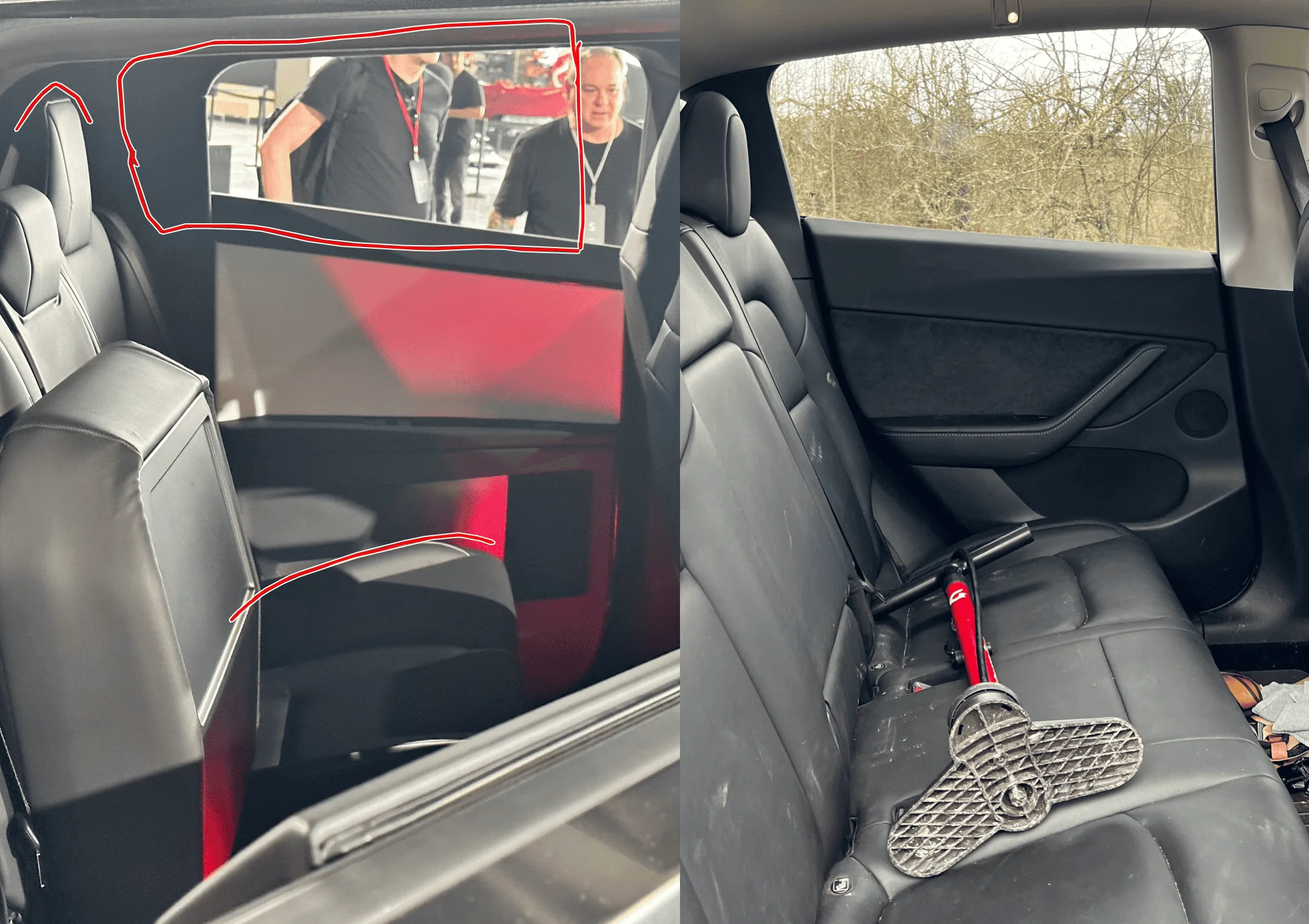

It’s not as bad as this image makes it look. I made a comparo versus my Model Y (because I had similar concerns). Short people might have issues, and looking straight sideways will be the big concern. Looking forward you get a bit better view.
The red outlines mark where the window on the Model Y would be for that seat.
