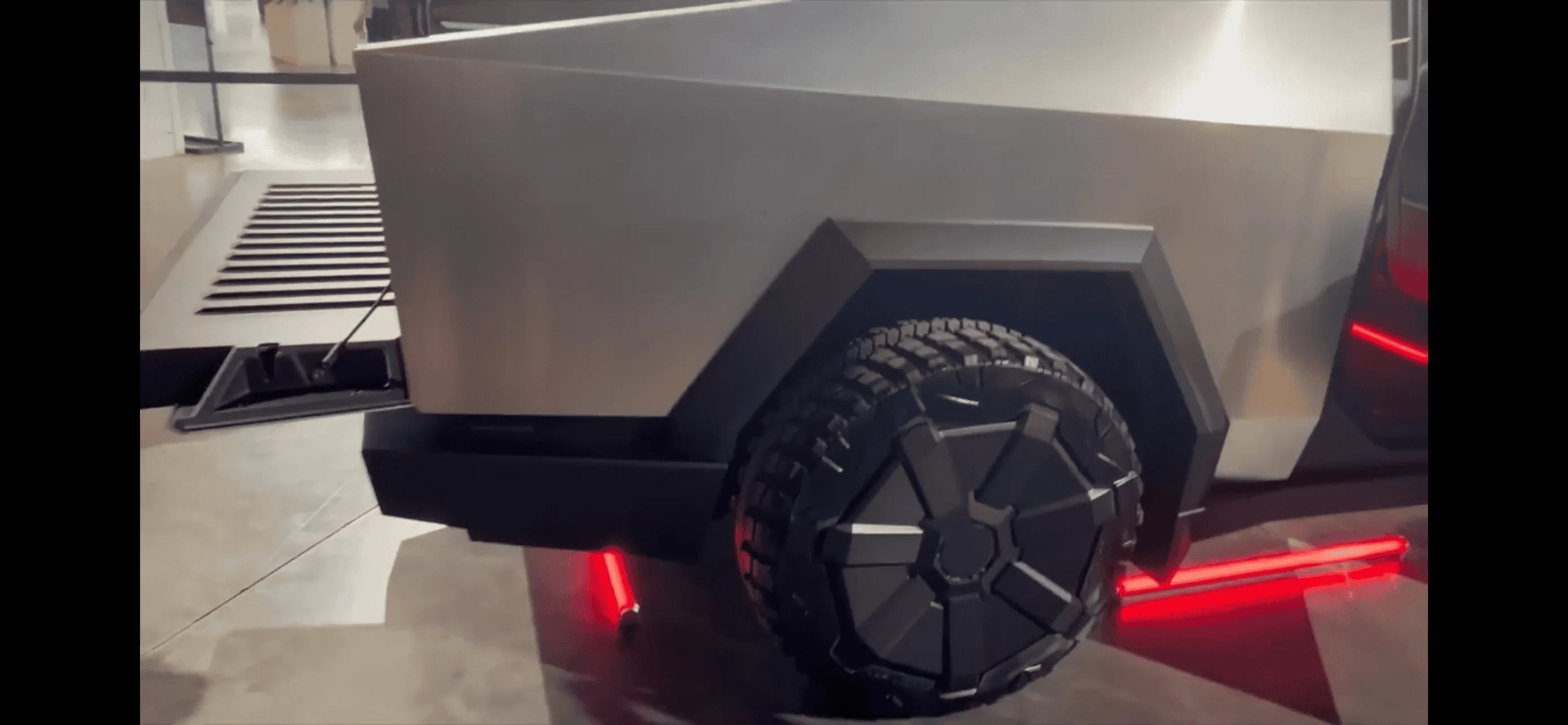

The top 'button' is not a button at all, but is a cover for an attachment mount point. This is a left side picture, but the right side only has the top (attachment mount point), and no recessed control. There is also an identical attachment mount point further up the sails, and then another one just behind the peak of the rear cab on each side as well.
The integrated tonneau open/close control and tailgate release, is only at the driver side rear.

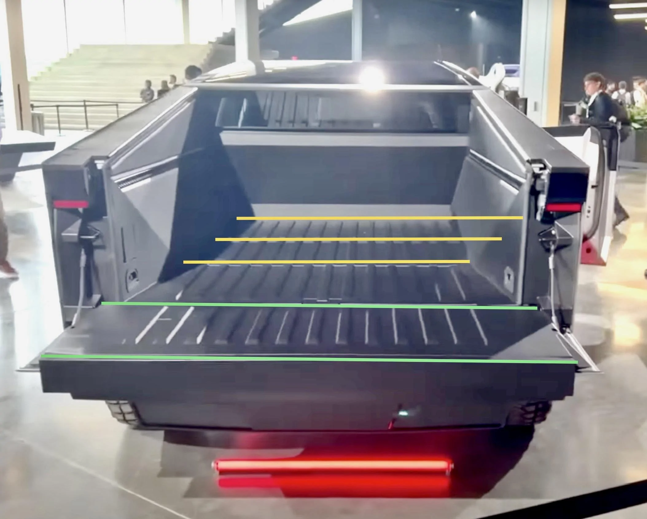

• DETERMINE LIGHT’S DISTANCE FROM CAMERA: Let’s next determine where the light is sitting, in distance from the camera. That’s important to determine because the photo has distortion from near field to far, as can be seen from this:
Tesla Cybertruck INVESTOR DAY CYBERTRUCK BETA PRESENT! [w/ Walkaround Videos] 01255A5C-9E97-4084-A208-97D20AC8DED1
In the above photo, the yellow lines are all the exact same length. Conversely, the green lines are different lengths, but the tailgate itself is a rectangle and the same width front to back.
Perspective!
Accordingly, to use the width of the light as a ‘measuring stick’ for the width of the truck, it is remotely accurate only if the ‘measuring stick’ is used to measure the plane of the truck that is the exact same distance from the camera as the ‘measuring stick.’

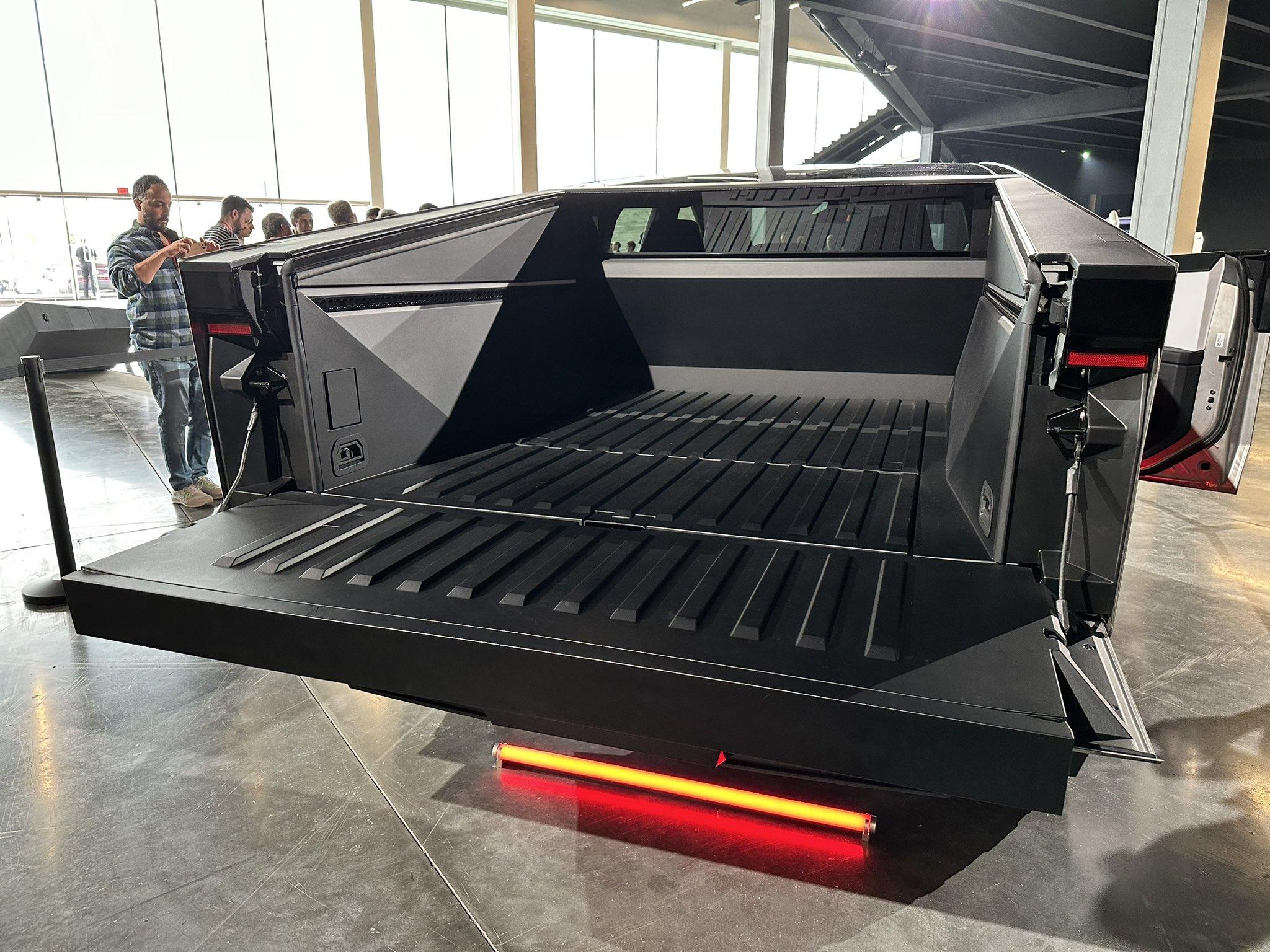

In the photo below, the blue line over the light is identical in length to the red line in the truck bed - which line in the truck bed is directly ‘above’ the light on the ground (and so both the same distance from the camera).
Tesla Cybertruck INVESTOR DAY CYBERTRUCK BETA PRESENT! [w/ Walkaround Videos] 57A9A567-C50F-4087-80C9-653E5C74140D

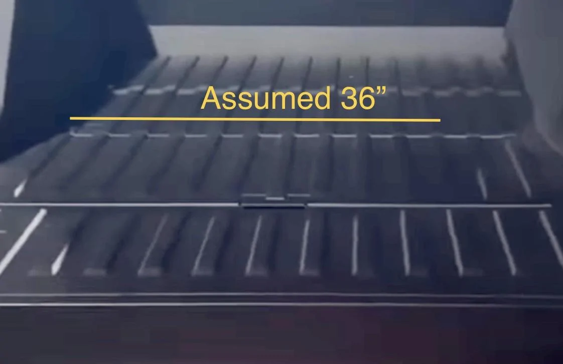

USE THE MEASURING STICK TO DETERMINE THE WIDTH OF THE BED HUMPS:
In order to eventually measure the distance between the CT’s wheel wells (which is, in perspective, materially further back), we need a new measuring stick - the bed humps. (Which are evenly spaced in the truck, but appear to converge in the photo because of perspective.)
Our red line measuring stick in the photo above is placed over the centered humps of the bed (since the photo was taken from an angle, there is also distortion of “center” in the furthering field of the photo). That red line covers 11 bed humps. In other words, if the red light on the ground were picked up and placed in the bed, it would cover 11 bed bumps.
• USE 11 BED HUMPS TO ESTIMATE WIDTH BETWEEN WHEEL WELLS:
Because we’re really only trying to solve for the bed width in its narrowest portion (the back ~2/3rds), let’s look at the width of 11 bed humps in that narrowest section of the bed:
Tesla Cybertruck INVESTOR DAY CYBERTRUCK BETA PRESENT! [w/ Walkaround Videos] C8A52AE5-15C2-41C4-9145-5F84DAA7A18E
• EXTRAPOLATE TOTAL WIDTH BETWEEN WHEEL WELLS:
Now, because that yellow line above is what 36” looks like in the narrowest portion of the bed:
• if the bed is exactly 4’ wide total, we’d need to add another 12” to our yellow line above … which is adding another 33% of the length of the yellow line, which seems right but plausible​
• conversely, if instead we assume the CT’s distance between wheel wells is the same as the distance between wheel wells in an F150, 51”, we’d need to add another 15” or another 40% to the current yellow line - which is maybe possible, but begins to seem a stretch (or is it a squeeze?)​
• if we instead assume the distance between wheel wells is >61”, which is what you first conclude in your video, we’d need extend our 36” yellow line another 25” or another 70% to the length of the current yellow line. Not remotely correct.​
