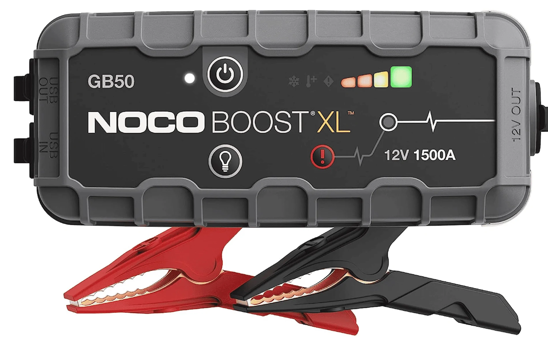

So you can use a battery based jumper or maybe a 120v AC charger/start with the power outlets. I would lean to the 120ac because you might only need to jump someone once every.. 2 years? I would be worried about the batteries in the lithium based products being drained or dying.

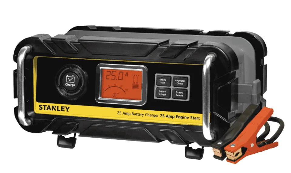

You can carry an old school battery charger and plug it in. Its not super fast like a jump start but it would work in a pinch.
