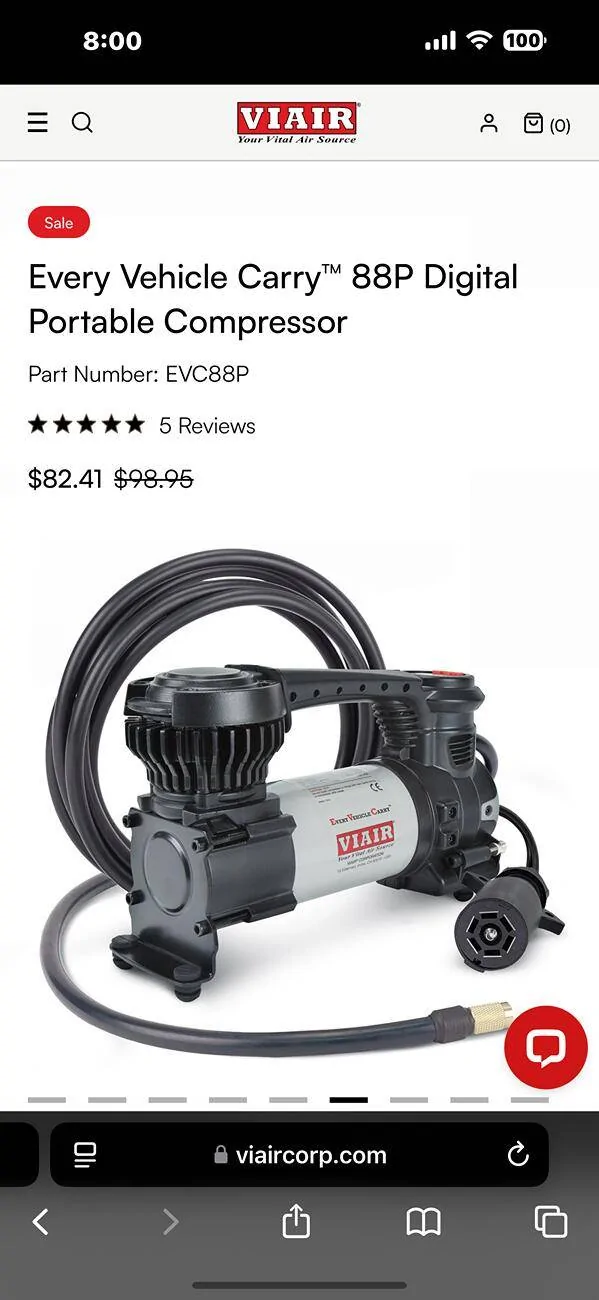

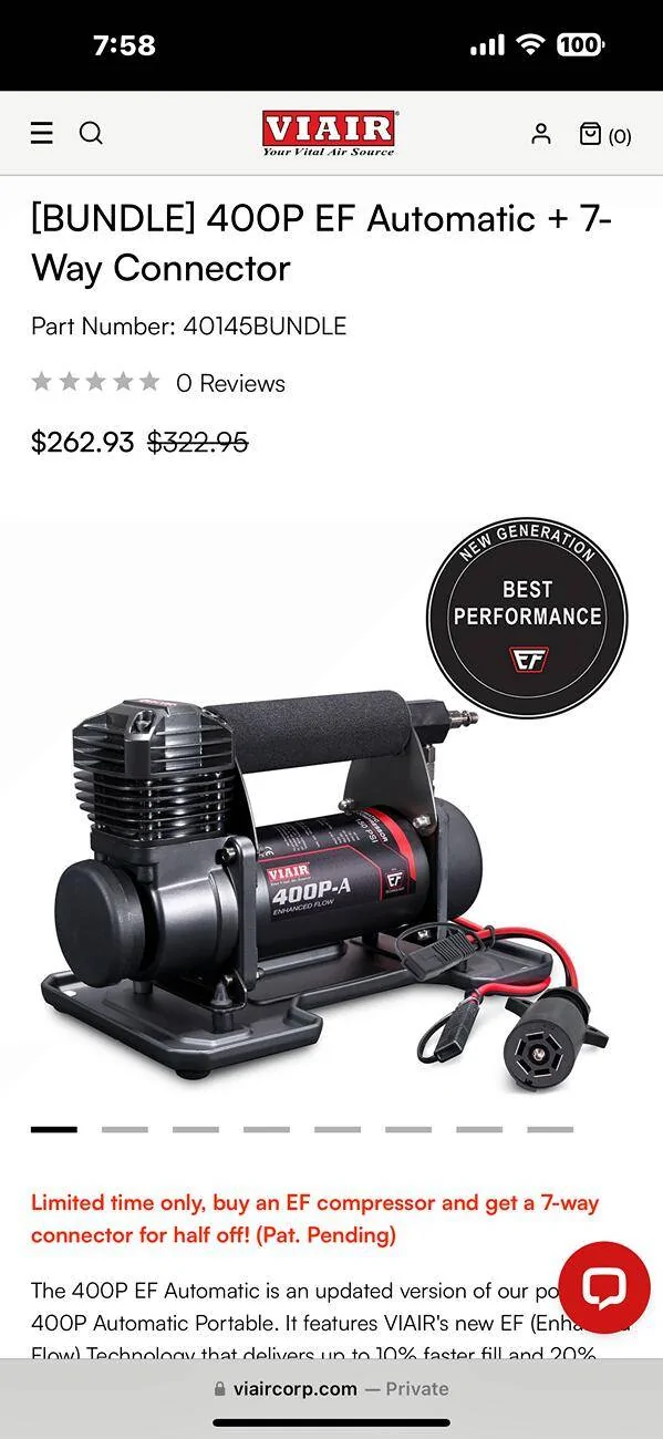

I bought the Viair with the trailer hitch plug.
my use would be roadside tire repair. It’s small and didn’t take up a lot of room in the trunk. Oh and it’s not expensive. They have all sizes available.

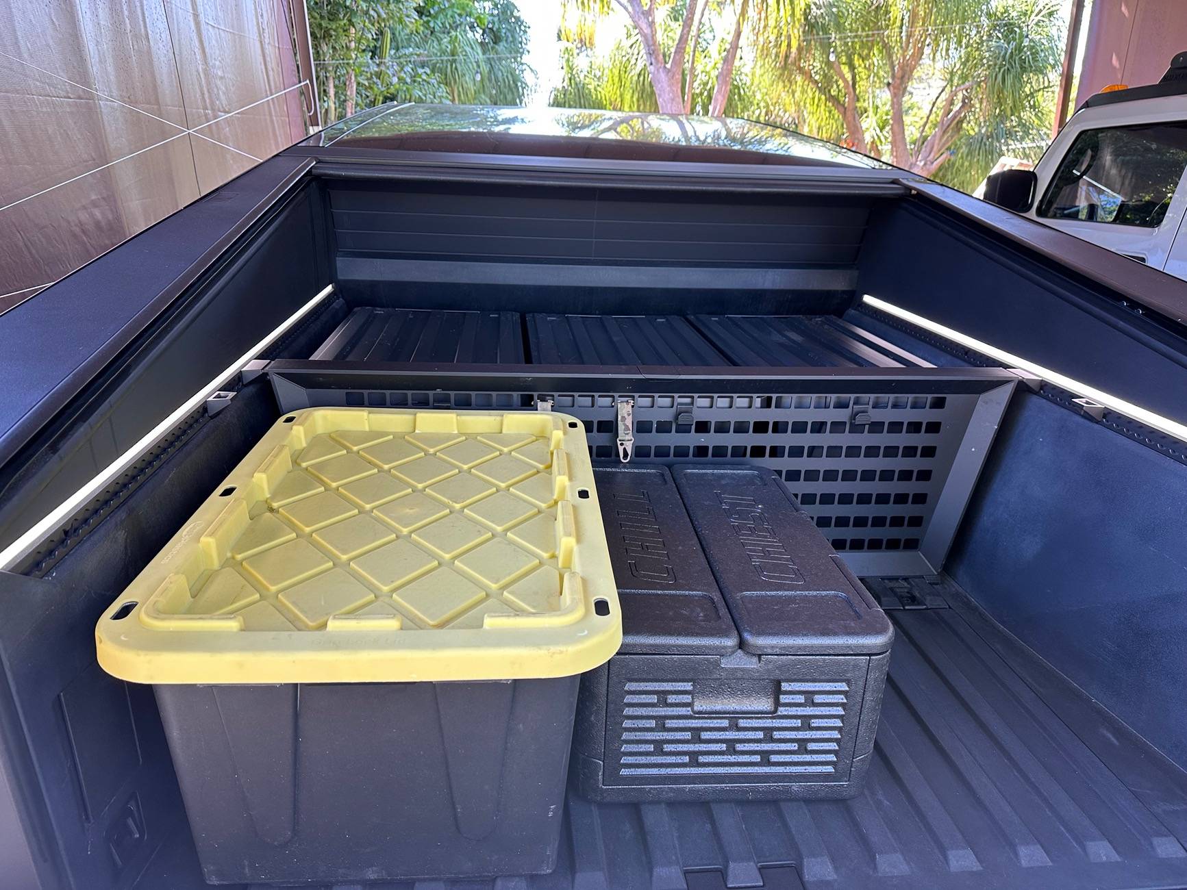

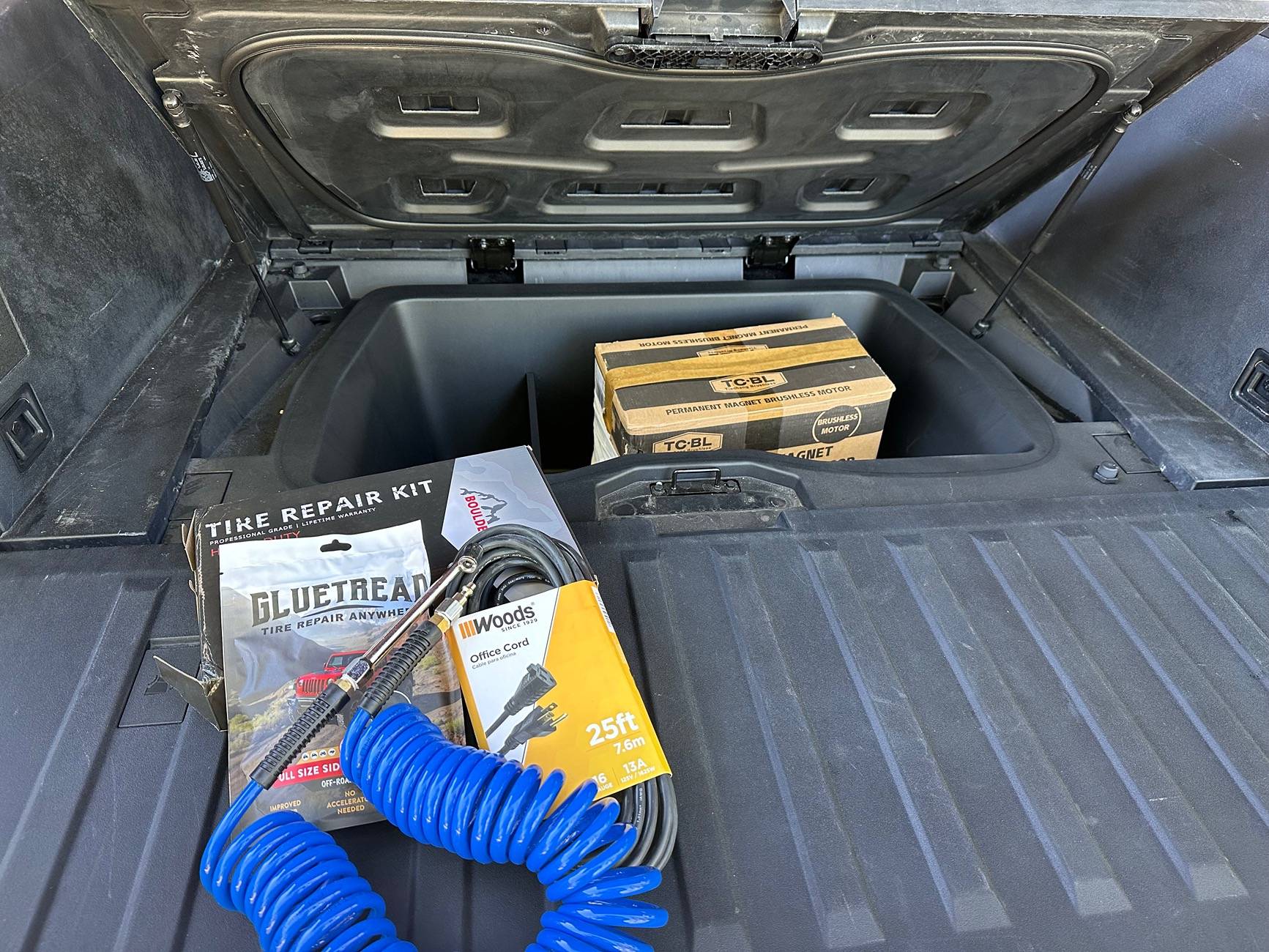

Any chance you have a picture of this in your smugglers trunk? I've been looking for a couple weeks for the right quality high powered compressor to throw in the truck, but I also have my mobile connector, extension cord, and various tie downs in that spot right now so curious for how much room it takes up. I'm a visual learner!
Also paging @Ken in Miami for any pics you might have as well :)

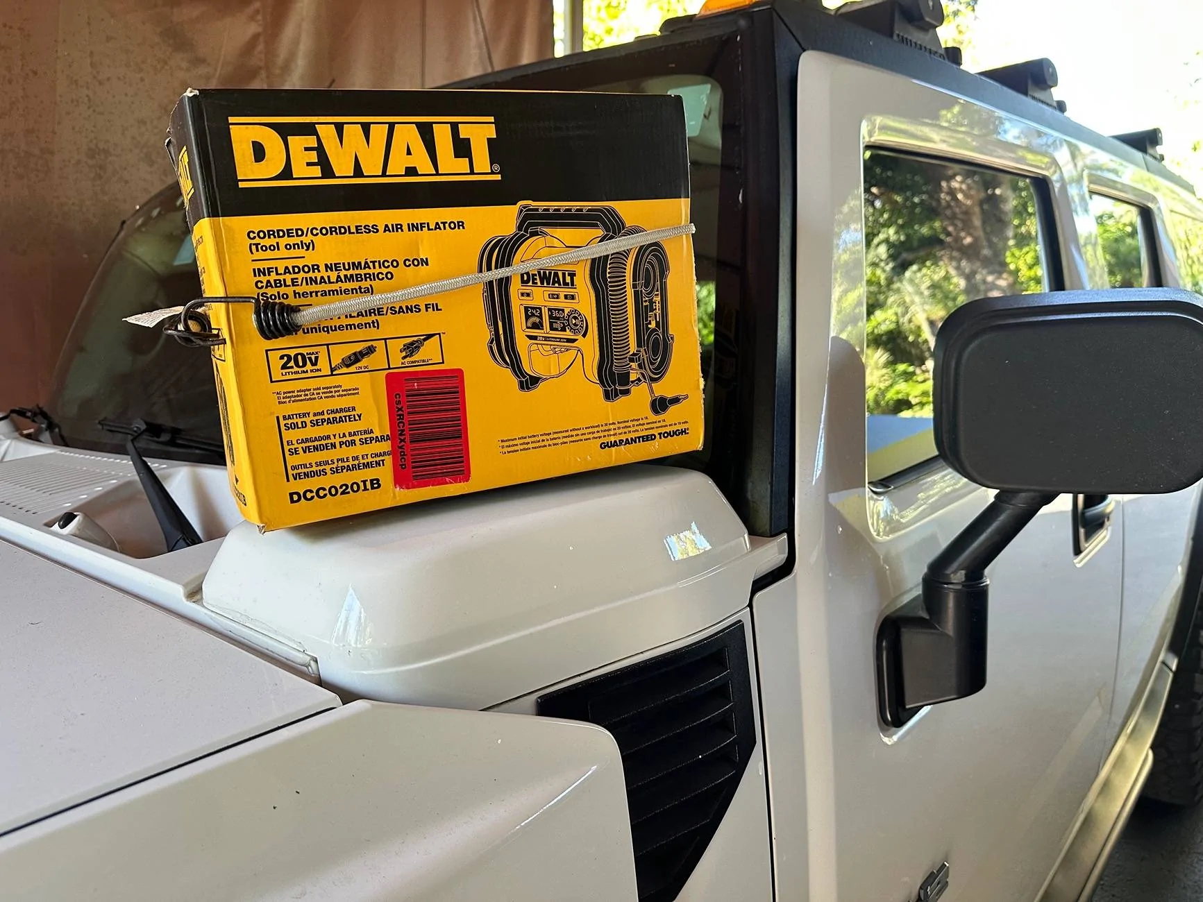

The Dewalt I keep in my hummer with a 6 amp battery and two large cans of fix a flat and tire plugs and no spare. In the Tesla truck Hauling Ass gave the idea for the 120v compressor from Amazon. The problem with the storage bay and an air compressor is height. The Tcbl in original box fits easily I did change the outlet to one that fit all my air lines. I could only find one other compressor short enough to fit and it was a baby Makita with tank from Home Depot. In all trucks I have owned my plan is to repair on vehicle and get to safe location. With tpms I have been able to do a temp repair and keep moving. In reality with this truck or my hummer I just don’t want to carry a spare, passenger car yes.
