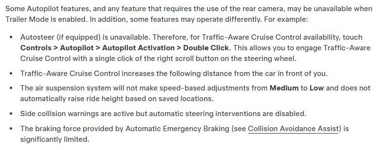

I’ve considered using trailer mode to stop the annoying back up warnings and travel warnings when my bikes are in the back. Is there any concerns with doing this? What does trailer mode actually do to the controls if the truck?
You can't activate FSD with trailer mode active.
Some Autopilot features, and any feature that requires the use of the rear camera, may be unavailable when Trailer Mode is enabled. In addition, some features may operate differently. For example:
Autosteer (if equipped) is unavailable. Therefore, for Traffic-Aware Cruise Control availability, touch Controls > Autopilot > Autopilot Activation > Double Click. This allows you to engage Traffic-Aware Cruise Control with a single click of the right scroll button on the steering wheel.
Traffic-Aware Cruise Control increases the following distance from the car in front of you.
The air suspension system will not make speed-based adjustments from Medium to Low and does not automatically raise ride height based on saved locations.
Side collision warnings are active but automatic steering interventions are disabled.
The braking force provided by Automatic Emergency Braking (see Collision Avoidance Assist) is significantly limited.
Some downsides directly from the manual

Thanks to scottf200 also. I didn't realize that when trailer mode was on, it doesn't make speed adjustments to height. That's nice to know.
