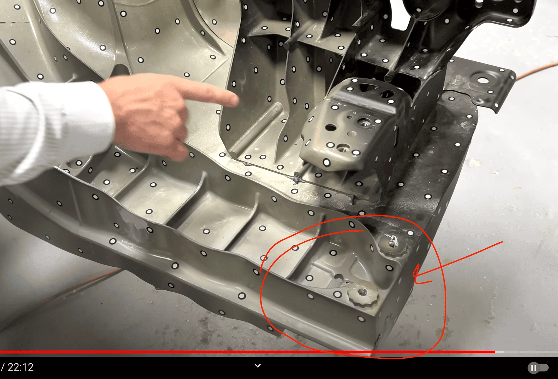

The video (mostly*) debunked the poor argument that a steel F-150 chassis would snap if dropped on its hitch. However, that's an irrelevant strawmanish topic to the events the Cybertruck experienced.
He admits they dropped it on the hitch/ rear frame
He continues saying it snapped in half. The trailer receiver section broke off, not half the frame. It's not clear if the receiver is a critical cross vehicle structural component.
He tries to hand wave the F-150 braking on extraction which is when the frame broke. Note: a 11,000 pound trailer with maximum braking will only exert around 8k pounds of load. The F-150 with nose in the dip could have exerted more, plus the shock load of the chain would be multiples of the F-150 mass.
Note the F-150 is braking before entering the drip, chain is slack, and the pull angle requires a near perpendicular motion of the F-150 front tires:
The Cybertruck still pulls it up the culvert before breaking.
*Ways the video did not compare apples to apples:
F-150 dropped a shorter distance, (but rear wheels didn't hit )
The F-150 had a ball mount in the receiver vs hitting the frame
Biggie: The drop was using an excavator instead of free fall and it was supported by the chain all the way down.
The impact angle was different
Other test: Dragging a concrete block is less force
Basic differences the test couldn't control:
Vehicle weight

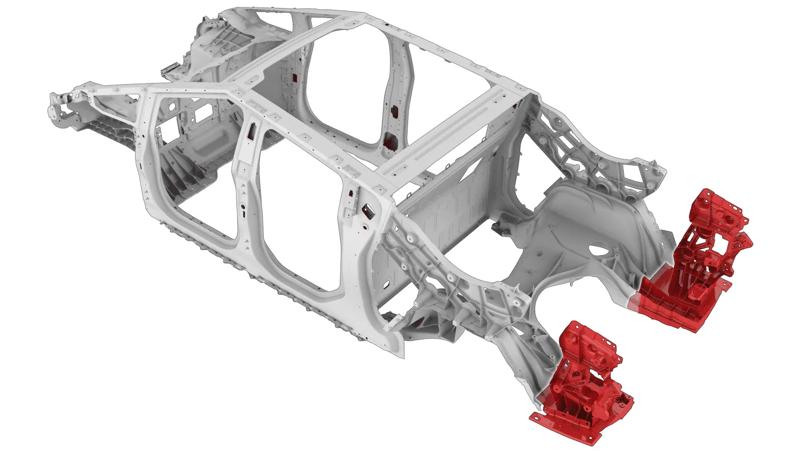

So overall I wouldn't second guess Tesla's strategy except for the fact that the truck costs so much which kind of negates the whole argument for a giga-cast assembly structure. Personally I am waiting for a revision of the truck because as Elon says "requirements are always wrong" and so all the FS CT owners as well as people like WD are helping Tesla refine the requirements and make a better product. I bought a 24 M3P instead so I can drive my cheap gas pickup less.
The "cost" of the truck does not negate the argument for giga-casting. You are confusing retail pricing with cost of manufacture (while simultaneously comparing apples to oranges):
1) EV trucks from legacy manufacturers are sold far below the cost of manufacture. Tesla is loathe to sell vehicles below the cost of manufacture and plans to be cash flow positive with Cybertruck by this fall.
2) You can't determine the gigacasting cost savings (or lack thereof) by the cost of manufacture of the entire truck. Because EV trucks from legacy manufacturers do not come with roll-top tonneaus, steer-by-wire, 48V architecture, 35" tires, heavy gauge stainless steel bodies, high end stereos, toughened glass, etc. ALl of these things cost real money to include.
You just get a lot more truck for your money with the Cybertruck, even with the current Foundation Series price premium. And Tesla can make the Cybertruck for less than legacy manufacturers can make their EV trucks, which as I pointed out above, are inferior in many respects. Never confuse selling price with cost of manufacture. All other EV truck manufacturers are selling them at a huge loss. That's why they refuse to make very many of them. Tesla will ramp the Cybertruck to high volume and solid profits due, in part, to the efficiencies of the gigacastings.
I could never go back to a flexi-flyer steel frame. I like a rigid chassis for handling dynamics, ride quality and cargo capacity. I could feel my F-150's frame flex during normal driving on paved roads, and I don't like it. The Cybertruck drives with the chassis rigidity of a million dollar sports car.

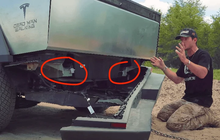

If you have hit your hitch receiver as hard as Whistin' Diesel did by dropping the rear of the truck in a 5 vertical foot free-fall, then I think you need to reconsider how you off-road. It looks to me like they may have identified a way to break the receiver and then designed the "test fixture" consisting of the 6' diameter culverts and the concrete curb at the bottom to exploit that knowledge.
When they backed into the logs and tore off the plastic receiver cover, they acted all surprised that there was a receiver under that cover. But it looked to me like they were already intimately familiar with that area of the truck and were just feigning ignorance. That they had already studied the structure of the receiver and identified a way to apply an unnatural impact to it.
They knew exactly what they were doing and, even then, they needed to do multiple takes of the drop off the culverts to crack the receiver frame. The evidence of that comes from careful analysis of the drive mode and state of charge in various video cuts. It looks like the first drop didn't break the receiver due to the truck being in off-road mode (because they needed to do another take). We did not see this clip. They then drove it back to the top of the culverts with it in "low" suspension mode, not "Off-Road" (and the battery SOC was now 2% below where it was before the initial drop). This took a while to film and make happen so they could splice all the cuts together to create their desired fake narrative. The curb was not tall enough to impact the receiver hard enough to fracture it when the suspension was in Off-Road mode.
This is just a wordy way of saying it was hard for them to exploit the perceived weakness they found, and this is not the kind of impact that could normally happen, even during rugged off-roading maneuvers, unless one was doing incredibly foolish and reckless things with zero regard for the truck. This is not how truck owners actually use their trucks.
I might be a little concerned if they had been able to crack the casting with only an 18" vertical drop. But anyone with a knowledge of physics can tell you there is a world of difference between the impact forces involved in a 5-foot vertical drop and those of an 18" vertical drop.
