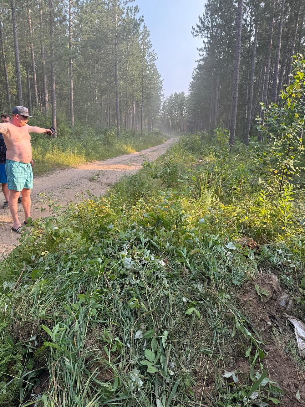

I’ve been testing out the off roading capabilities quite a bit recently.
We have a 4 wheeler trail with a good ramp for jumping. When I give friends a ride we take it over that and have jumped it pretty good several times now. It’s really quite amazing!

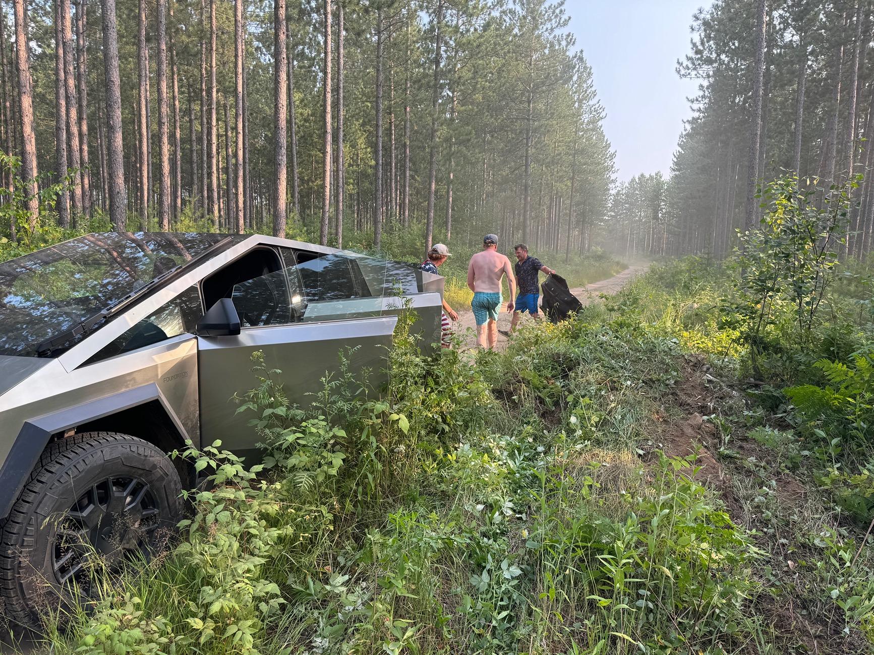

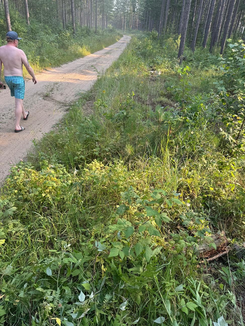

This weekend I took some friends for a ride down a minimum maintenance road in Baja mode for the first time. Drifting around a sand pit was a ton of fun with 80/20 rear power bias. On a straight stretch we hit several large whoops, should have checked the out closer first. After the second whoop at around 70 the rear end started to rise as the front came down to land. I punched the gas to try and straighten it out and keep it on the road, we veered off a little into the weeds and found a dirt pile that was almost 3’ tall. Needless to say when we landed a full 25’ later we were all pretty hyped up. Lesson learned to do better recon before hand.
I can’t explain the smoothness of all this. It handles the jumps and rough terrain like nothing I’ve ever driven before. Even the dirt pile in the weeds, it was a full send off that thing and the landing was amazing. No fish tailing or bouncing. It tracked really well and landed very level.

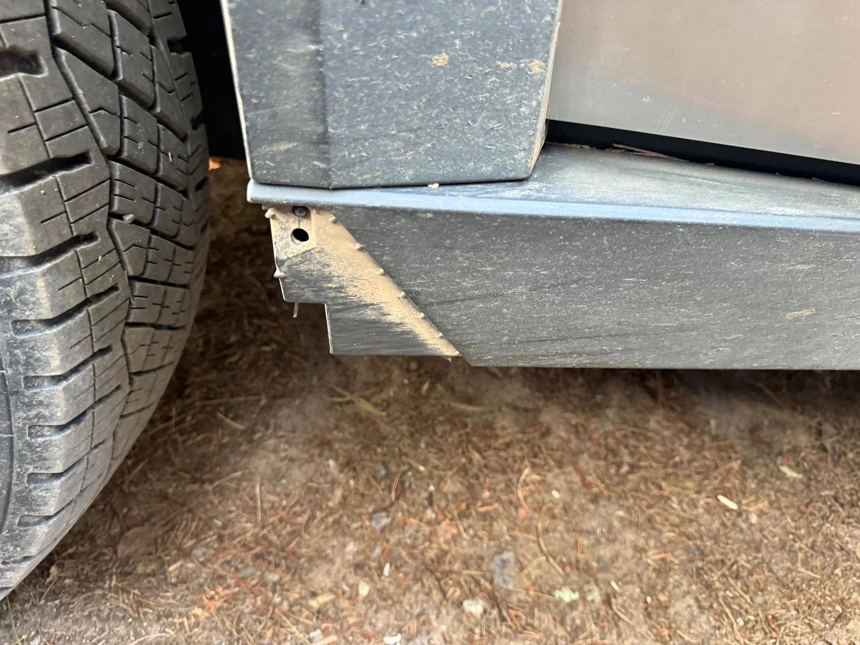

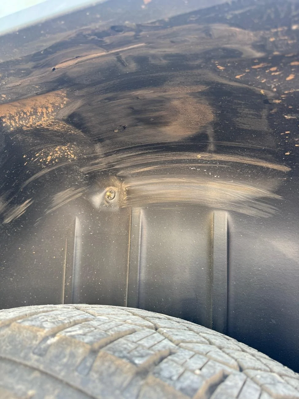

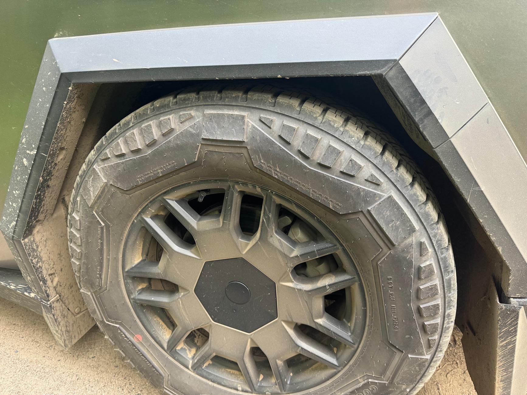

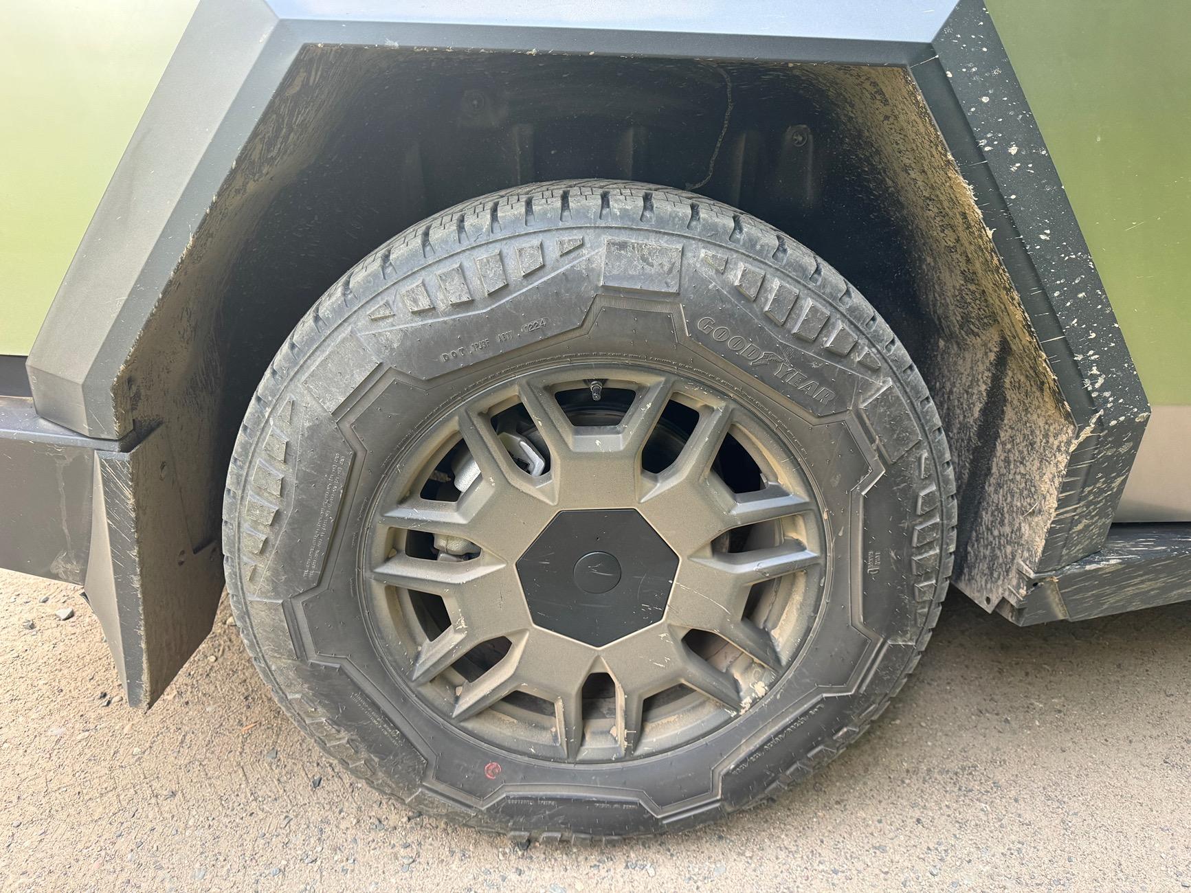

Lost the rear wind dams (the fronts are already long gone) and one wheel liner. There are some pretty good rub marks in the rear wheel wells from the wheels rubbing when we landed. The tonneau cover came off the tracks on one corner. The manual says it can stay up or down, I’m thinking it would be better retracted but I’m not sure.
I already had a service appointment for this Tuesday so I’ll get the cover and plastics fixed/replaced then.

Update. Just got the truck back from the Tesla. About $500 in repair for the plastics. Two wheel liners and two air dams installed. They fixed the tonneau cover under warranty.
We discussed it it’s better to be open or closed when off roading. While it might not get damaged when retracted, it would be a lot harder to get at if it does get misaligned.

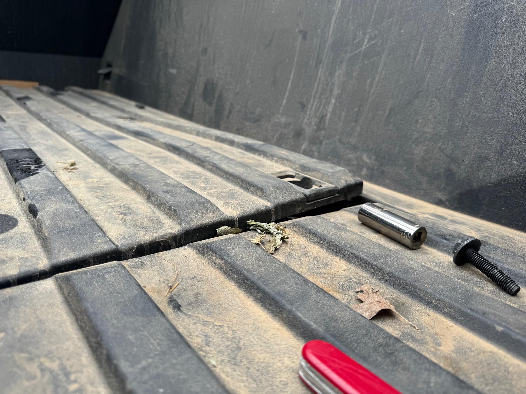

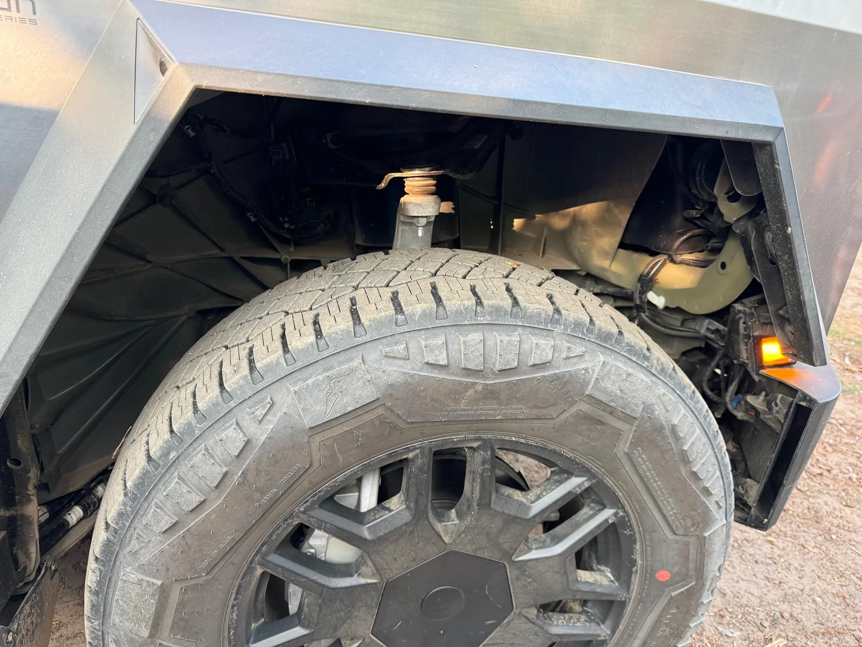

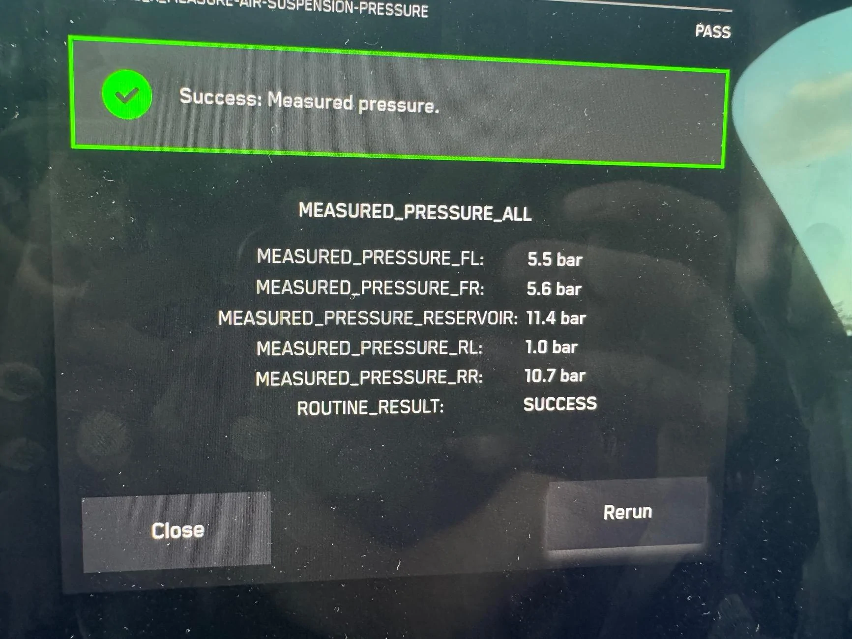

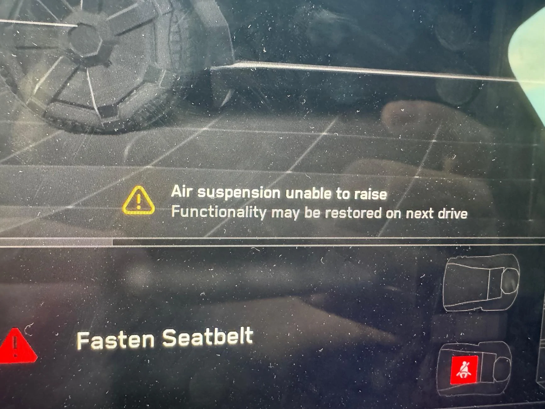

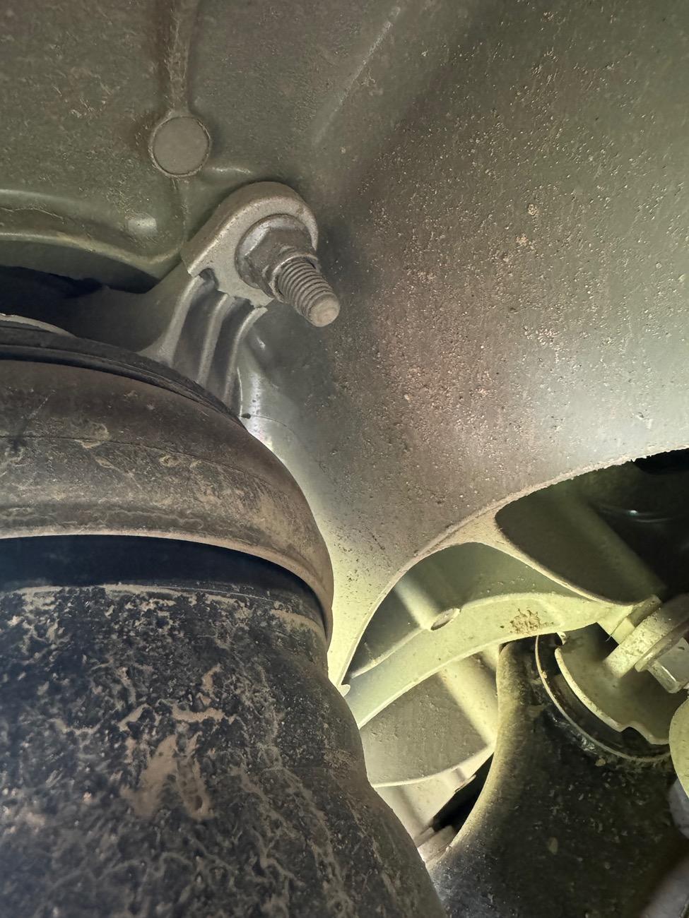

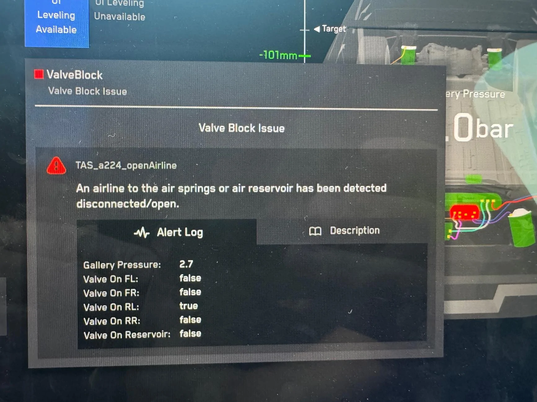

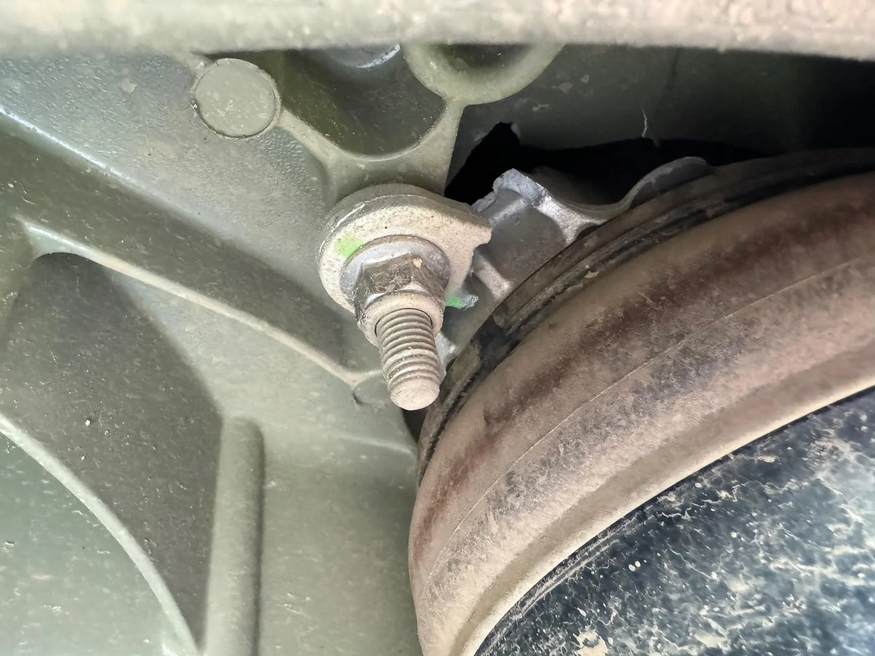

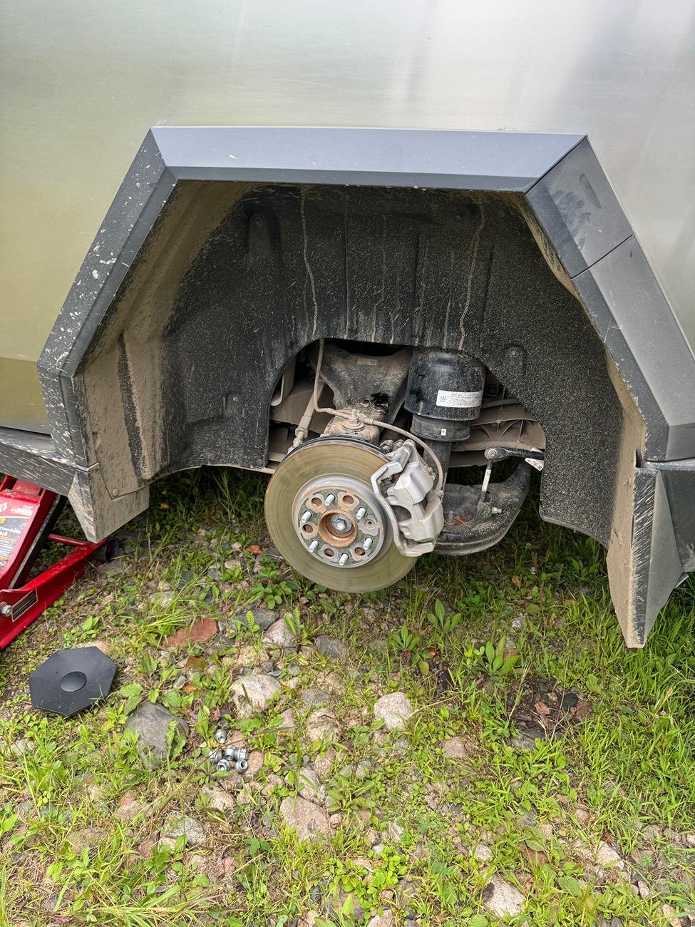

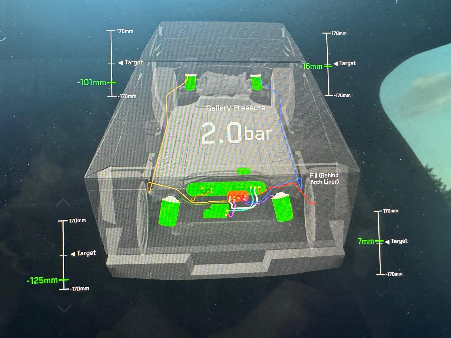

Update. On Tuesday I was showing someone the extract mode, when the truck failed to return to medium hight and gave an error message about the air suspension. One side of the truck almost sat on the tires and the other side was way up still. I took the wheel off and found a few broken mounts on the airbag. It’s pushing up on the panels in the bed on both sides. Started a Tesla Roadside Assistance request yesterday afternoon and 4 hours later a truck came to haul it away. Keep in mind we are three hours from the Tesla dealer and tow truck service. Very impressive service!
Now to have the dealer do a full inspection and see what needs to be replaced.
