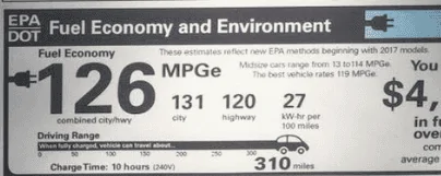

Um
"when fully charged, vehicle can travel about..."
^this
Pretty much the last shoe to drop is the info from the EPA and fingers crossed it brings some hope for range increase via software update

Um
Good point - it does show the one combined range underneath, but that's kinda the problem IMHO. That one range is often not accepted as "real world" - which is an EPA problem admittedly - but why not show - under the same 126 combined/131 city/120 highway section - the estimated ranges for those three categories? We constantly see people - mostly early adopters on sites like this one - argue about that 310 number - real world vs estimated. Yeah we all know that the EPA estimates are just that, but wouldn't it help if the Window Sticker showed 310/322/295 for example (just using rough numbers).

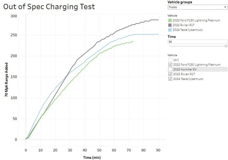

Rivian comparison.
Road trip from 10%-70% is common. NACS will help non-Tesla EVs this year.
https://outofspecstudios.com/charging
The other chart on that page [link] shows a story of Rivian and CT being similar experiences.
Below interpretation:
So this chart is saying that on a road trip doing 70 mph given your vehicle efficiency (Wh/mile) and charging speed (kW) this is the comparison.​
Tesla Cybertruck Range for AWD Cybertruck 200-250 miles after many real world tests VYNKDr
"If my next stop is 150 miles away, then I have 34 mins wait (lunch/phone/walk) in my F150 and 27 mins for CT/Rivian."​
Tesla Cybertruck Range for AWD Cybertruck 200-250 miles after many real world tests gicF3gO
Aside:
ATs -- The data is in that chart (click label)
1) 2024 Tesla Cybertruck - Goodyear Wrangler Territory RT All Terrain tires​
2) 2022 Rivian R1T - Pirelli Scorpion All Terrain Plus tires​
3) 2022 Ford F150 Lightning Platinum - General Grabber HTS tires​
Aside:
One little caveat to your interpretation. "If you start charging at 0%".
If you come in at 15% (~50 mile) you then need to look at the 150-200 mile area that can add more time.
