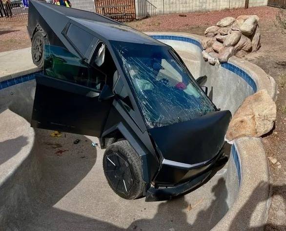

REVERSE means FORWARD??

It's possible it's a misapplication of the hold to stop but I'd expect that to be overwhelmed by any slope. I've seen motors with regen controllers accidentally go the wrong way when there's a capacitance issue in the charger. Lastly, it's possible to be between the magnetic registers for the rotation sensors and the alternating flux frequency creates backwards motion for a moment, or that the sensor thinks it's moving correctly but it's not - but while that's happened in cheaper motorcycles and and robotics, I wouldn't expect it in a Tesla because their motors are not built of spare parts.
All of these seem like they should be much too small or dealt with the myriad of sensors a Tesla has.
10,236
33,889
Two others beside the OP said it has happened to them tho.
Of course, but extraordinary claims require extraordinary evidence.
Every software developer’s first question is: “ how does it recreate? Figure that out or bugger off”

haha, I understand ALL too well. As a software developer I have worked on plenty of support issues in the field and if you can receate it then we can narrow down the circumstance and then recreate it in-house for WAY easier solution finding.
HOWEVER, if there is a significant problem of going forward when the user thinks it is suppoed to go in reverse, that $hit could run someone over or cause serious damage. That is not a bugger off thing ... and the UI is doing something funny ... that is the 'tank' run-ith something over.
OFFICER ... I swore I put it in reverse ... result
I agree, I’d place my money on miss-swiping (which I have done) than a true hardware or software issue.
I've mis-swiped myself, but the OP is alleging that the vehicle did not move in the direction indicated by the UI.
The Tesla software team, if they respond in the customary DevOps manner, will dismiss this as "operator error" since something like that is "not possible". ?‍♂
Unless and until someone can get video evidence, this issue will be dismissed as hysteria or FUD. And even then, it will be dismissed as a Deepfake until there are multiple reports from reliable sources.

Agreed. If it happens again pull out the phone and make a video. And make a service request, Tesla can pull the data and see if it’s real or not. If it is real, they’d be the first to want it fixed.

Here's my hot-take. The high-level control flow should go something like this:
User sets the direction
- command sent to drive unit
- drive unit queried for current state, and UI set to match
but instead, they are probably doing something like:
- UI set to user choice
and there's a rare but non-zero chance that the "command sent to drive unit" is lost or otherwise fails. However, the UI is already set to unconditionally match the User Choice, and is now a disconnect from what is actually in force. The UI is physically and logically separate from the drive electronics, as you can "double-thumb" reboot the UI while in motion.
To recreate this, you'd need to switch between forward/reverse repeatedly until the rare "lost command" occurs, nudging back and forth each time to confirm. An arduous chore.
Anyone experiencing this should certainly report it to Tesla, but I'm skeptical that they'd dedicate the significant resources needed to recreate or debug unless there was ample evidence of this being a true defect and not operator error.

I suppose one could do the following:
1. STOP!
2. Enable FSD.
3. Disable FSD.
4. Hit the mic to submit an audio report and say "The UI is indicating forward but my Cybertruck is going backwards. Please advise."
It may not be in the exact right spot for a complaint like this but at least someone at Tesla would hear it and they have telemetry.
