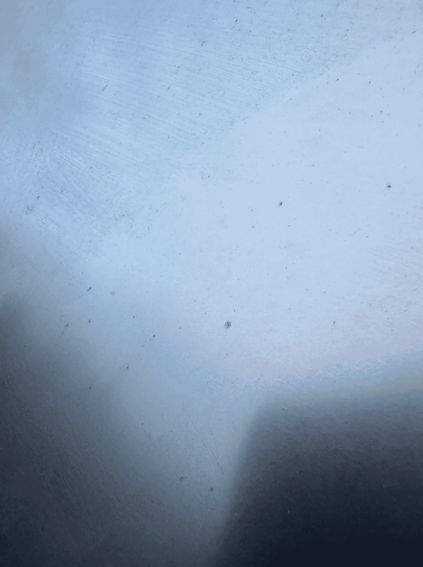

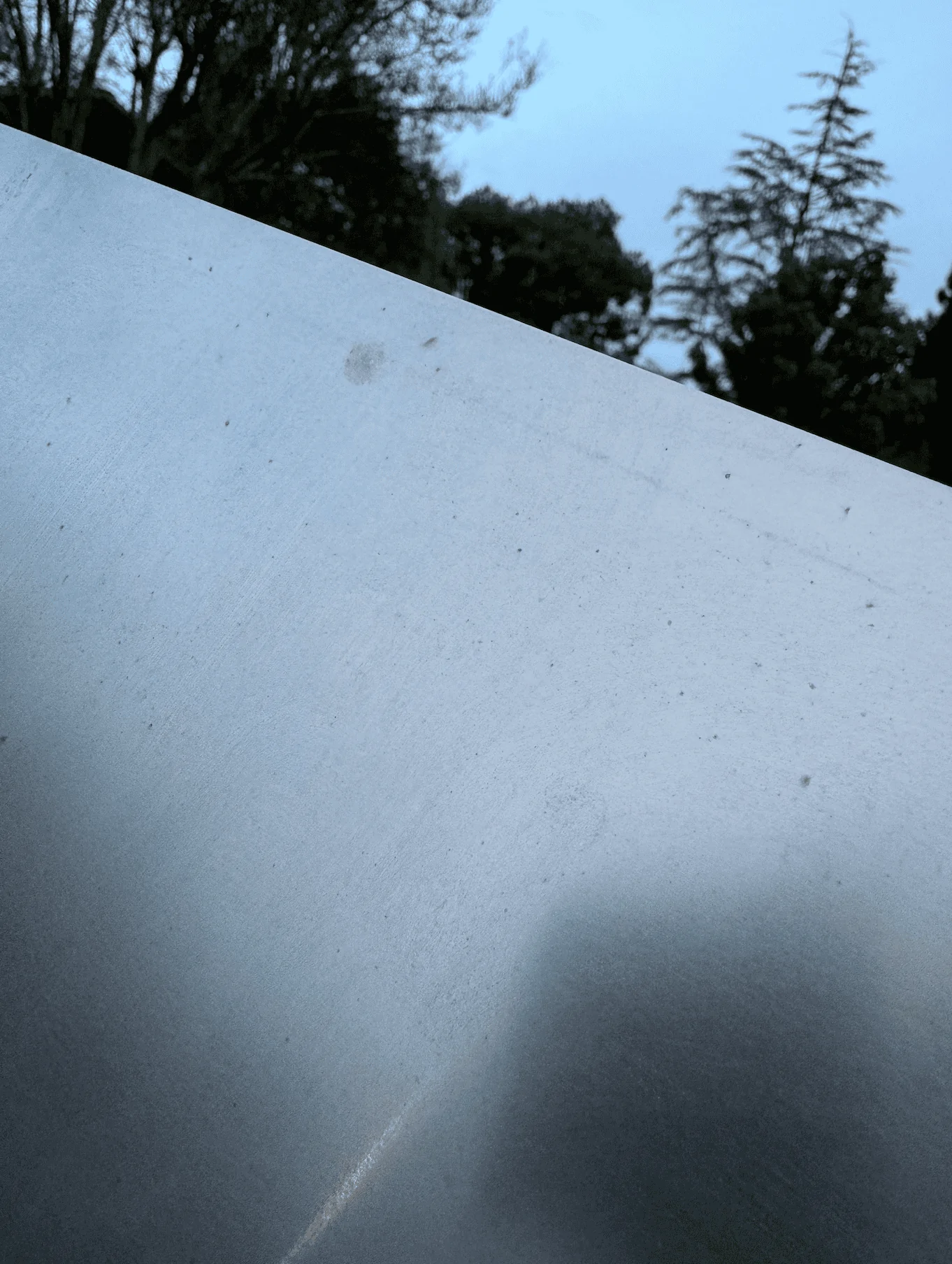

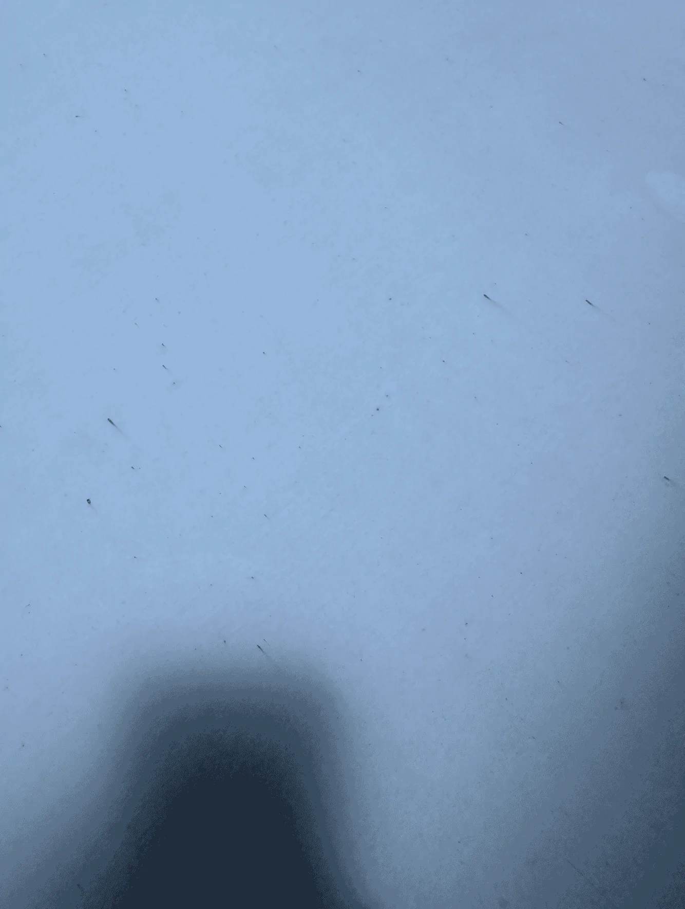

Some images after a dish soap wash. Cybertruck was driven 2 days in rain.

Not cool, I'm supposed to pick one up tomorrow and it's raining all day. All the pics I've seen, they just leave them outside. So, someone left it in the rain and they did nothing to fix it, so now you have to take it into service?

Mine has been out in the rain since I got it a few days ago and I don't see spots like that.
I wonder what would cause that then. A bad batch of metal with the wrong types/amounts of metal in it or rain in a different area that's got different chemicals or pH levels or something. Leaving the rain to dry out and evaporate and versus wiping it down each time?

Can you restore it back to non rusty with barkeeper's friend liquid, and then see if they return? The rail dust suggestion does seem to make sense, stains would be left by rusting steel dust that would not come off from a regular wash. This kind of thing happens in my CNC machines, where a little chip of steel rusts and leaves a rust stain on another surface that would not have rusted under the same conditions.
If barkeeper's friend doesn't remove the rust, that's a problem. If it does remove it and they come back, that's also a problem.
Contrary to what everyone thinks, it IS possible for stainless to rust, but I wouldn't expect 30X stainless to rust by itself with a few days of rain. Even in nasty road salt mist conditions in the northern states, I wouldn't really expect rust to form.

Exactly, this rust spot accumulation from debris in the environment happens to all cars, even ones with actual paint. That's why they make detailing products like Iron-X and Iron Out that you spray on your car, let it sit for a little, and it turns purple. Then you have to rinse it out. Can also get the rail dust out with a clay bar.
That's pretty common where it rains or snows regularly, and I do an annual decontamination wash on my Model 3 in the spring where it looks like it has a bunch of rust specks on the paint.

I remember from a recent YouTube Wrap video that the technician commented that there were tiny metal particles on the brand new truck. I think they used a clay bar to remove them.
Whether they were from manufacturing or transportation, I have seen this type of problem before on DeLoreans.
As mentioned above, if you get non-stainless steel particles on the SS panels, the rusting of the mild steel will set up a chemical reaction that will cause the stainless steel to corrode. I think it has to be left there or ground in ( at least on DeLorean panels).
A “rail dust” particle like these pictures show (if left to rust) can stain the panel. As mentioned BKF will remove it, but if it was left for a while, it could definitely pit the panel. The length of time will depend on the grade of stainless steel.
Here is a DeLorean example: some owners ruined their panels by using mild steel “steel wool” to blend their grained panels. The friction of the blending caused minute particles of the steel wool to be lodged into the stainless steel panels. After a short while, the steel wool rusted and the panel in turn looked rusted. If found in time, the remedy was that the panels were re-blended with the proper non-metallic pads and cleaned thoroughly.
