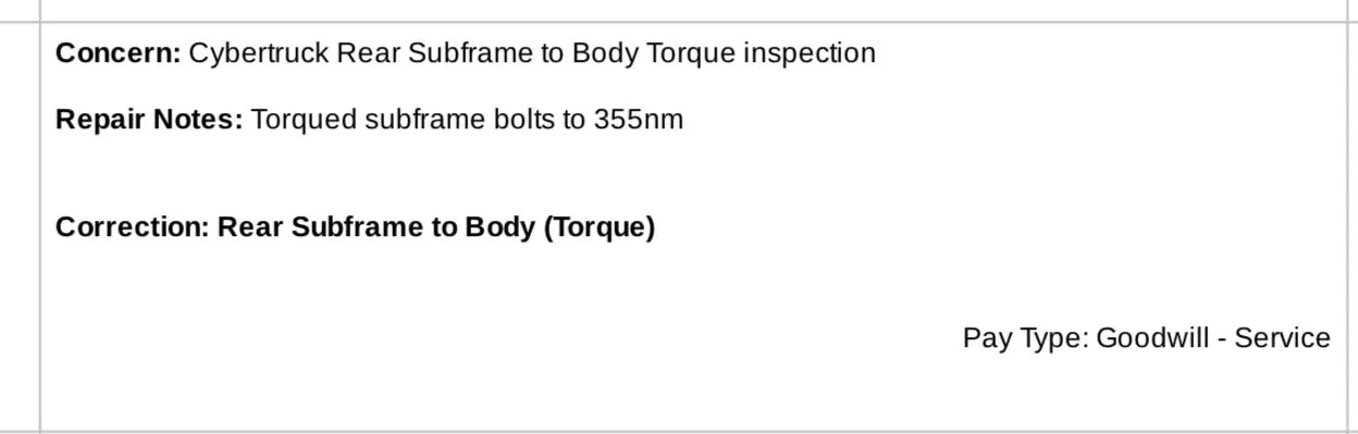

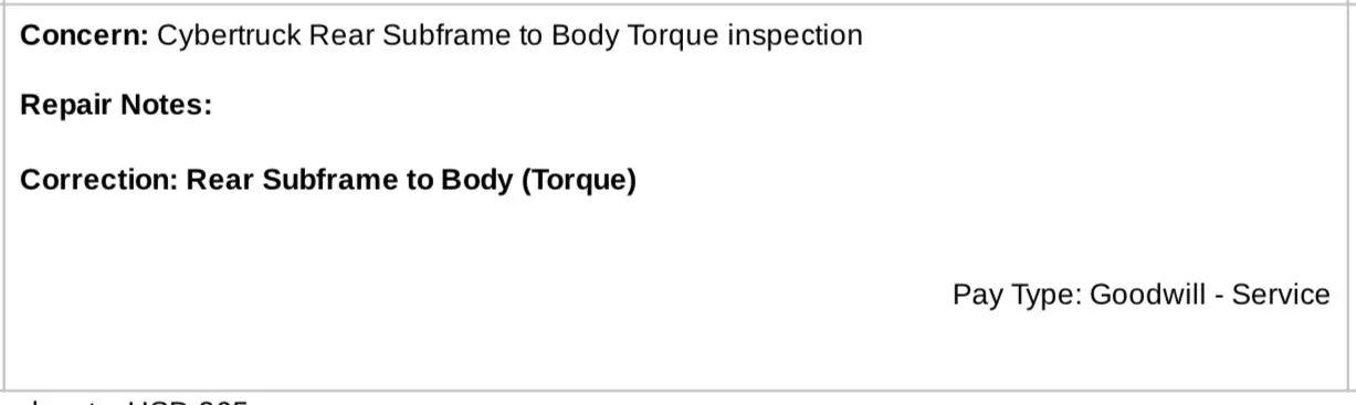

Mine makes a huge thump when I accelerate. Took it to the service center for them to make sure it wasn't anything dangerous. They did hear the noise and deemed it non critical. They are said it was something below have a service appointment next week. Pretty sure this is the remedy as that's exactly were the sound is coming from.

I am VIN 5436 and of all the service bulletins I was told only the accelerator one applied to me. The rest are for earlier vin numbers including this torque of rear subframe.
