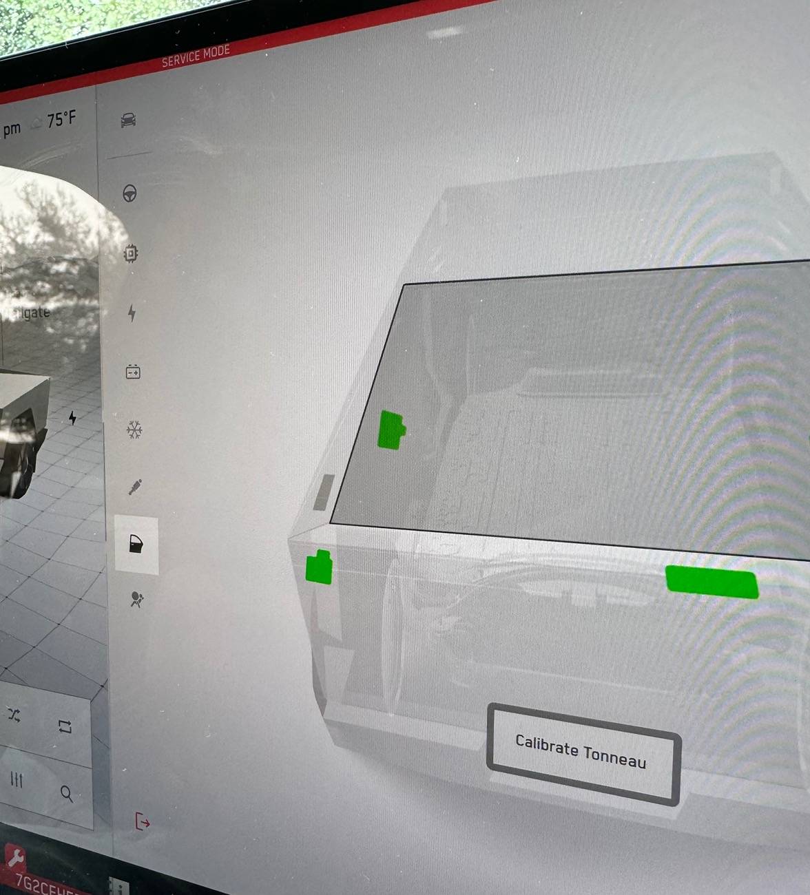

Sorry for the confusion, there is a "Service Menu" and a "Service Mode".
Go to the "Software" menu and hold down the "Cybertruck" logo until it pulses (~5 sec), and then type "service" as the password. Then go here:
Tesla Cybertruck Tonneau Cover Reset? Mine stops 6 inches from closing EDIT: FIXED IMG_0527

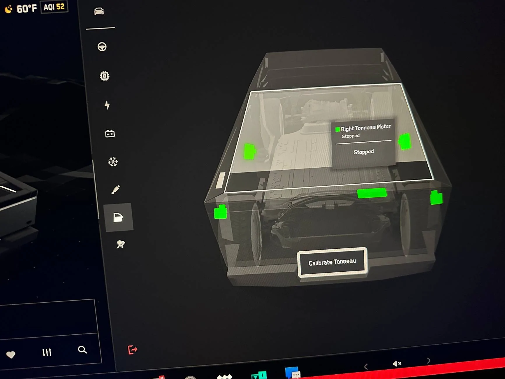

Ok, so I did it. And this is the problem in the pic below. I pressed "Calibrate Tonneau" multiple times and it doesn't seem to do anything. I even held it down for like 15 seconds and I still don't know what it actually does. It doesn't do anything visually.
Now how do I exit this "service mode?!" I seem to be stuck here. I'll try googling it....
EDIT: I found out how to Exit Service Mode. I'm going to send this pic and a video to Tesla through my service appointment in my app.

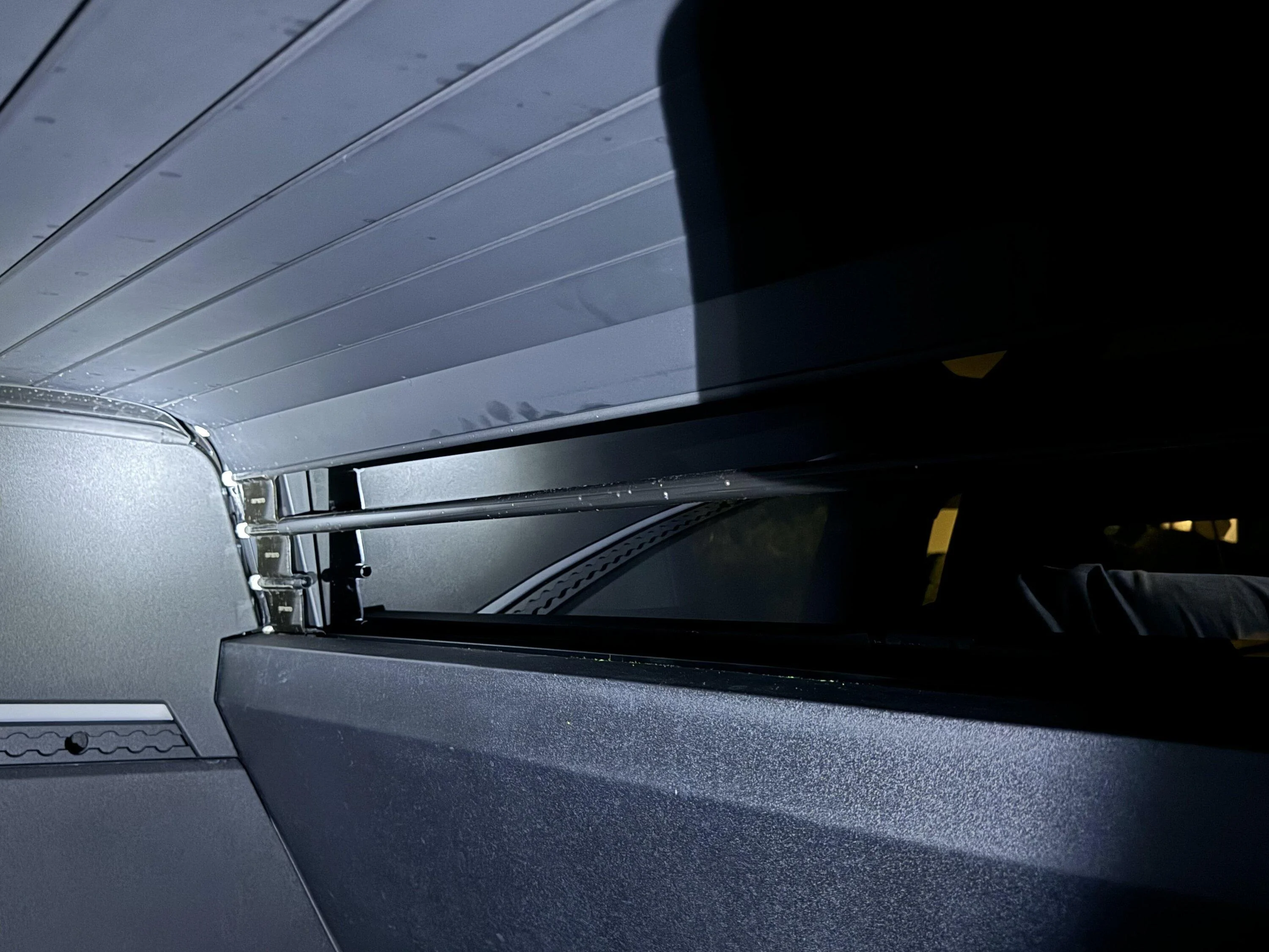

Mine would work in service calibration mode, but not normally.
Stopped 6 inches from closed and reversed unless you gently tugged on right side.
Service Center replaced entire slat assembly with Rev D version.
