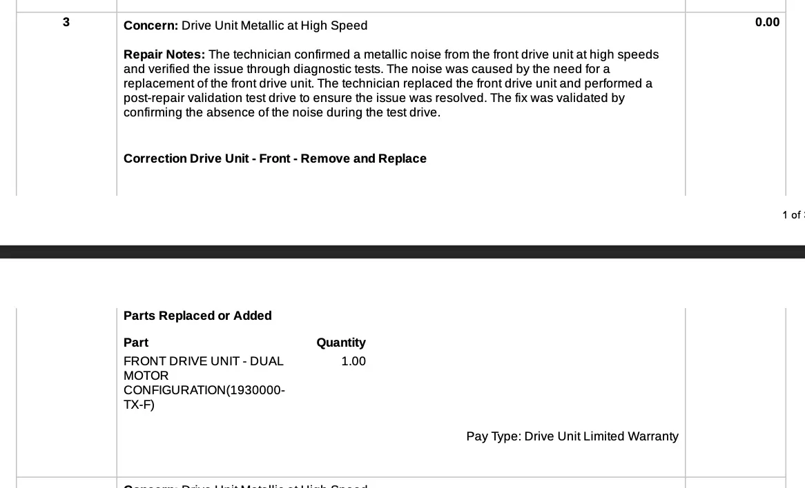

Long time lurker. I had the same issue - static like / mild grinding noise between 40 - 50, disappears when going around a curve. Have an AWD VIN 53xxx, purchased as inventory in June and the noise started around September.
Took it in and they first replaced a window seal and bearings. Picked it up and driving away immediately heard the noise. Turned around and brought it back. Tech rode along this time and verified the noise and said it was not normal.
They replaced the Front Drive Unit - part 1930000-TX-F (Revision F) and the noise is gone.
Waited a bit to post to make sure the noise didn’t reappear. Its been a week and have put ~500 miles on it since. Noise hasn’t returned.
I know the FDU swap didn’t help for some but in my case the noise is gone, at least for now.

Thanks for sharing, that really sucks but a good datapoint. Both you and @Darryl2006 had the FDU replaced without success. Worked for @Hammy60 and I.
If putting the truck in neutral when the sound is occurring causes the sound to cease it points to an issue with the FDU. Since @Hammy60 received a newer version of the FDU than all of us, might be worth seeing if they'll replace it again.
