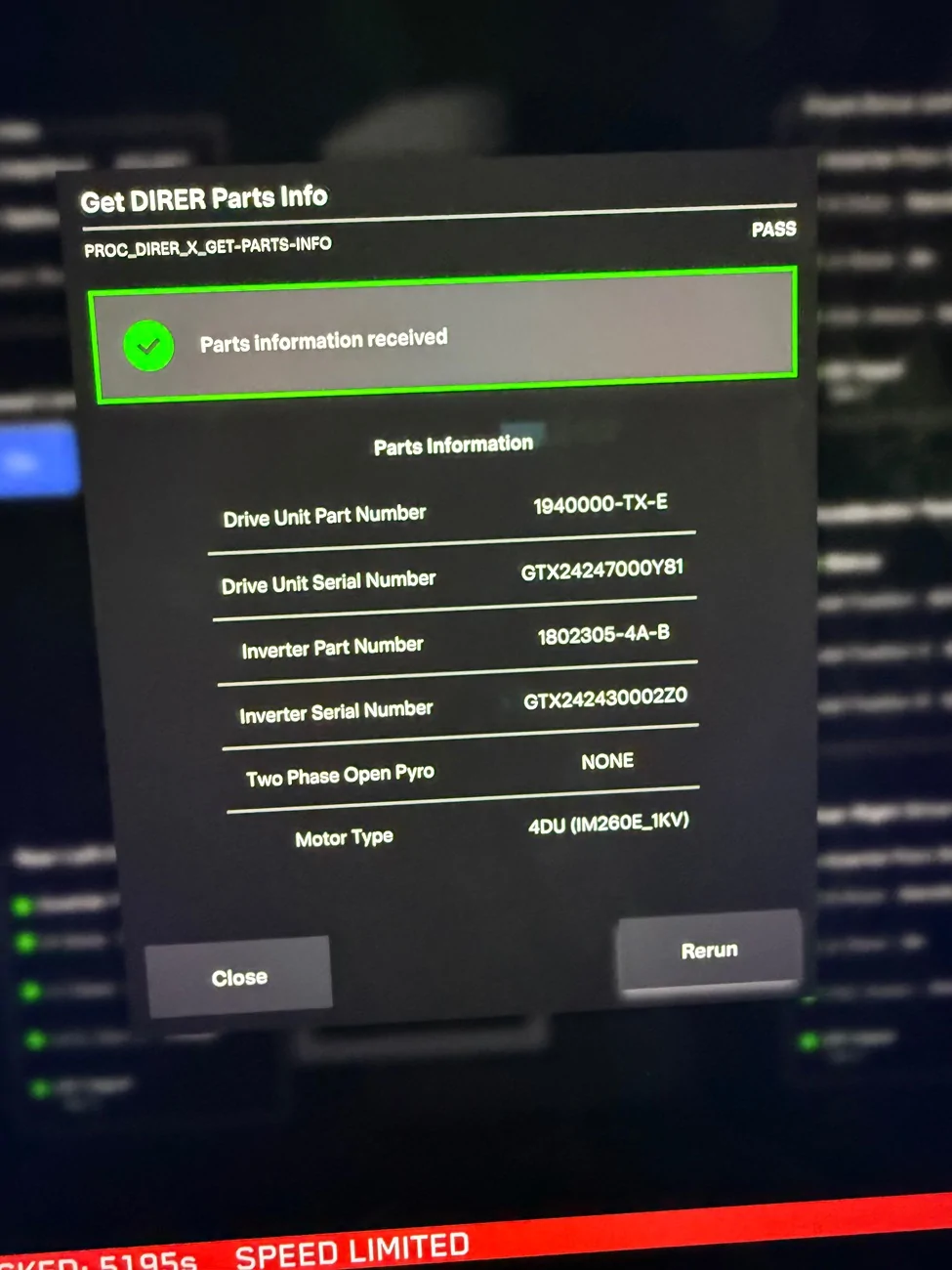

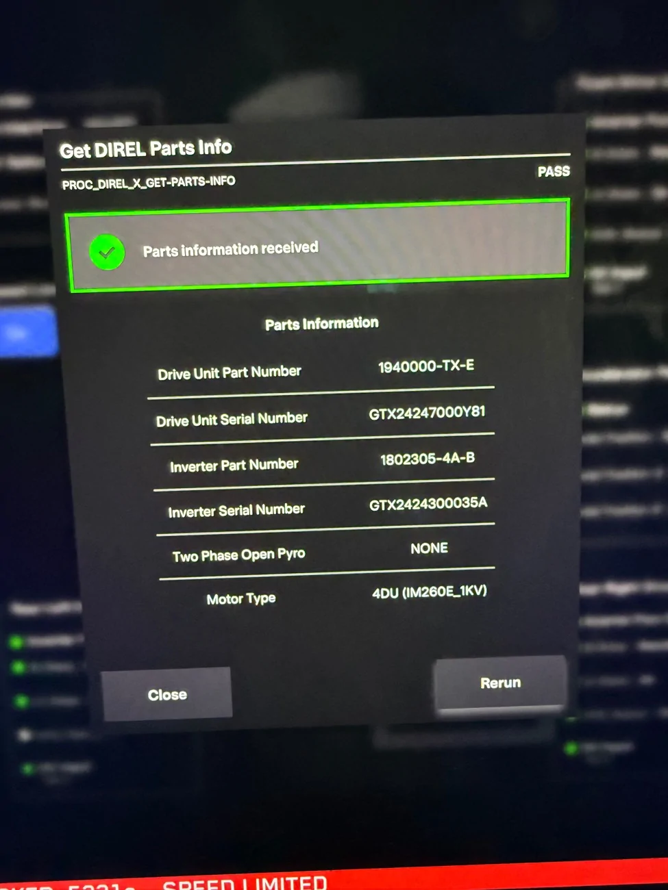

It’s in the service mode. This is my FDU AND RDU’s for my Beast.

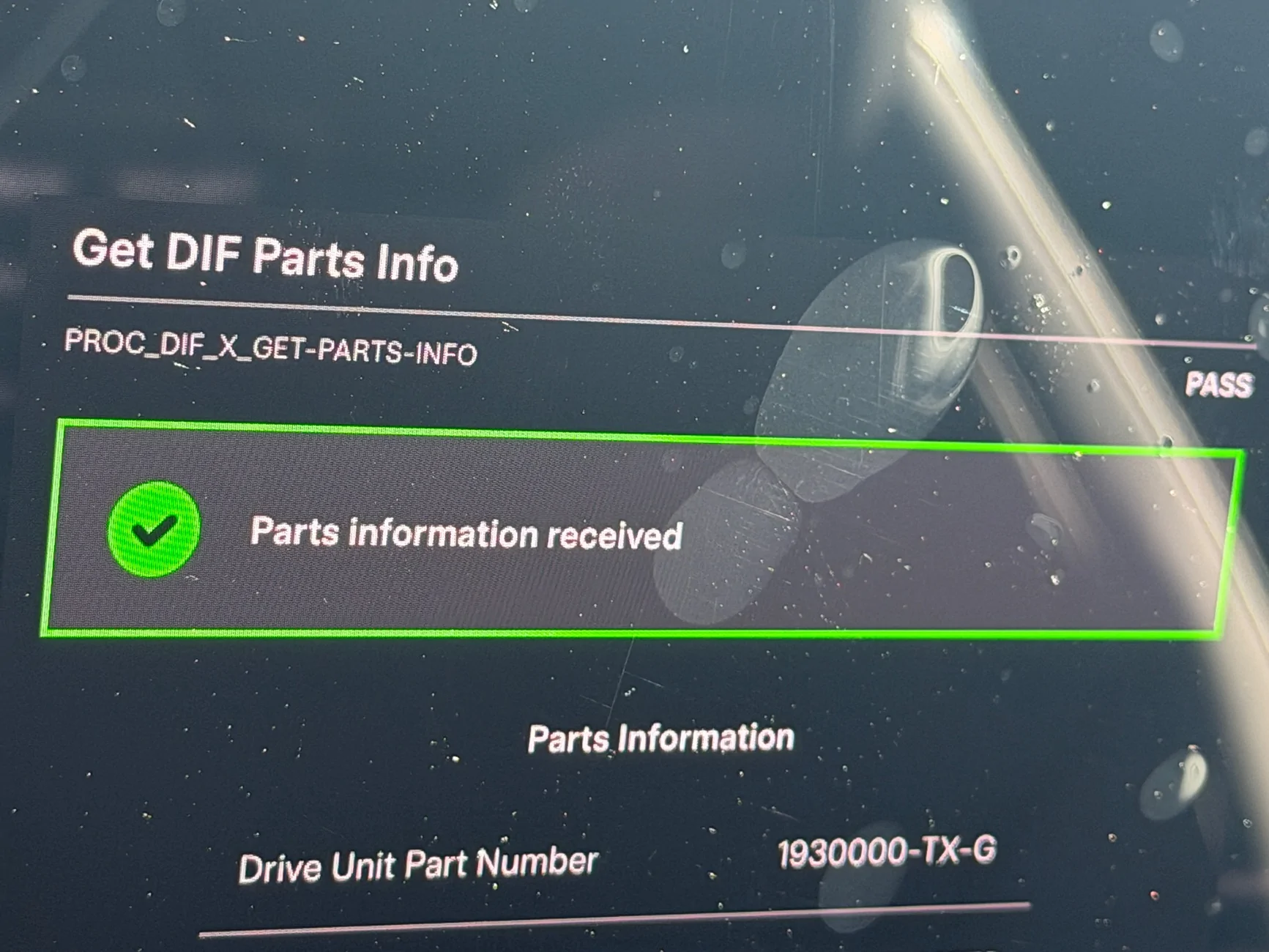

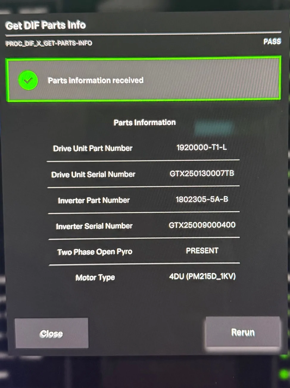

Just had the ‘24 Beast FDU replaced with new 1920000-T1-L which fixed the bearing noises at zero throttle. The ‘26 AWD has the 1930000-TX-G FDU and the RDU has the 1920000-TX-M.
To get the parts info go into service mode/High Voltage ⚡, Drive Unit, Press the Green FDU or RDU on the display/Parts info/Run, follow the instructions to press the R turn signal & Brake pedal.
