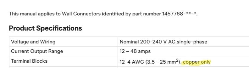

Wall Connector doesn't allow aluminum conductors .
