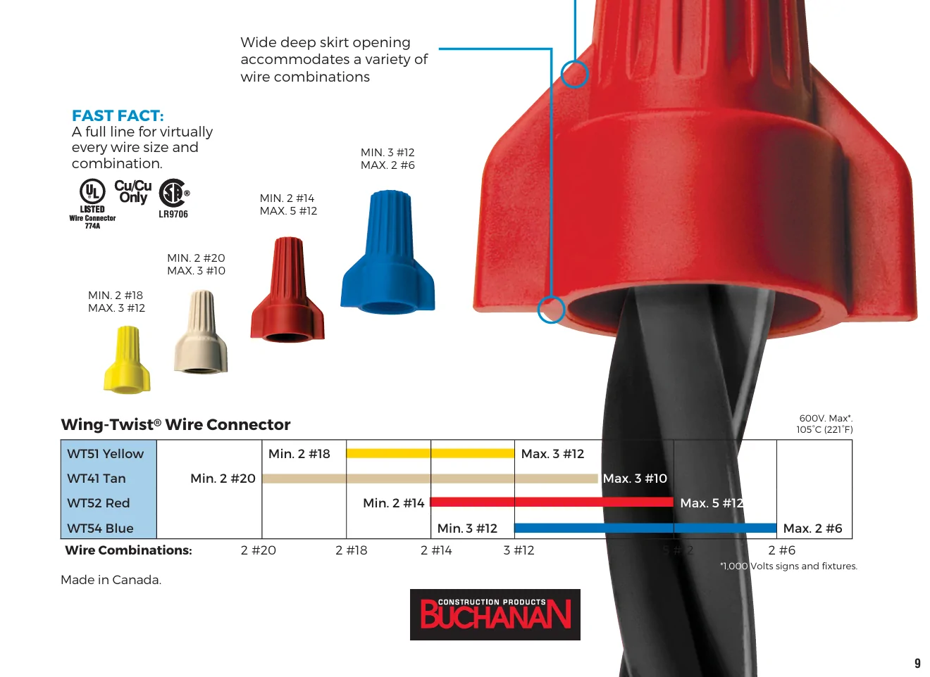

That was not installed to code. You don't twist wires that size. They need to be landed on clamps and torqued. This does NOT look like electrician work, it looks like a DYI install.
I have plugs for mine - which generally is not a good idea (more failure points). But a good electrician will get everything landed and torqued right.
I think you can use wire nuts for two 6awg, with the right wire nut?
Best practices may be another discussion... but I do not believe this violates code, unless there is a recent code change.
most state codes do not allow that.
I only know Virginnia's and VA. follows NEC code and according to the National Electrical Code (NEC), specifically Article 110.14 (Electrical Connections), two 6 AWG wires can be connected with a wire nut, provided the wire nut is listed and rated for that specific combination of wire sizes and conductor materials (e.g., copper or aluminum).
