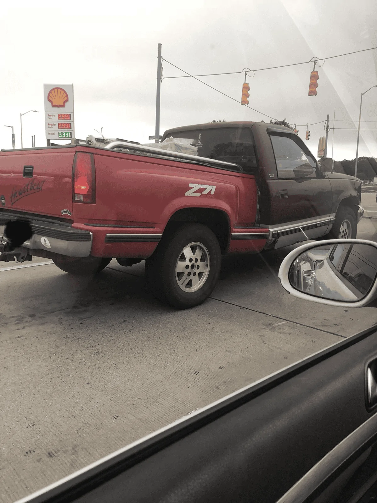

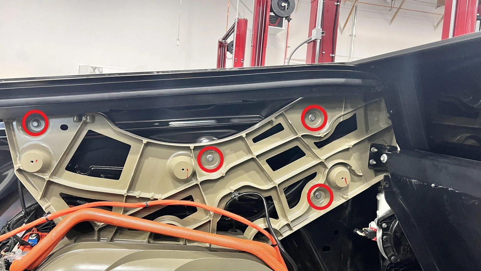

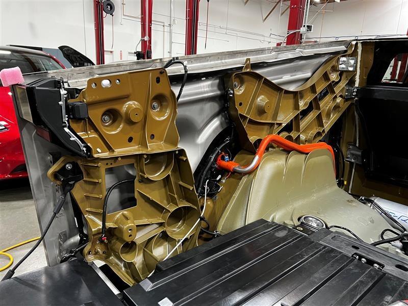

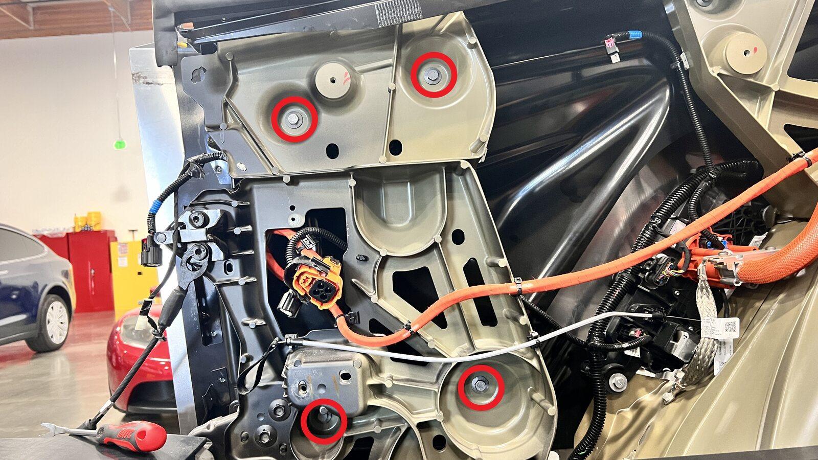

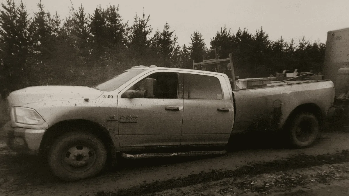

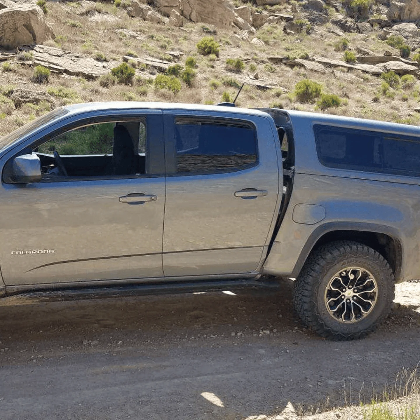

From what I saw from other threads and photos, it looked like the exterior panels are bolted onto the underlying structural subframe, which would make sense because if the panels are truly 30X SS then they're most likely hard to form and would need to be appended to the subframe behind the panels.
To be accurate, alloys of 300 series stainless steel are not typically hard to form, they can be stamped in 3 dimensional dies and their edges can be easily hemmed. What sets the metal used in the Cybertruck apart is that it has been cold worked to a very hard state, the structure of the metal has been converted from austenitic to martensitic, which is a change on the molecular level.
These changes greatly increase the surface hardness, the stiffness and the tensile strength of the panels (without increasing the weight). This, combined with the unusual thickness of the body panels, is what enables them to be used in a structural manner, stiffening the chassis, increasing the towing and payload, and is also what makes the Cybertruck drive so crisply and precisely when pushed hard, even with a load. These panels work in conjunction with the aluminum castings and high-strength steel stampings to "unitize" the entire chassis structure into a truck like no other.
You will never see a Cybertruck do this:
Tesla Cybertruck Back-and-forth between Cybertruck (tri-motor) and R1T (quad-motor) 1711039443854-9h
Tesla Cybertruck Back-and-forth between Cybertruck (tri-motor) and R1T (quad-motor) 1711039476940-0v
Tesla Cybertruck Back-and-forth between Cybertruck (tri-motor) and R1T (quad-motor) 1711039509596-wc
