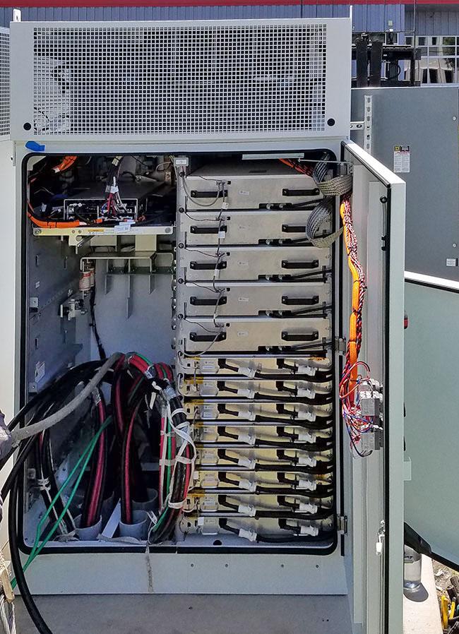

Did you know the first superchargers just used multiple Model S charger units?
V3 cabinets handle four posts plus deal with incoming three phase AC and include cooling. The high power DC-DC conversion doesn't really take much space/weight.
