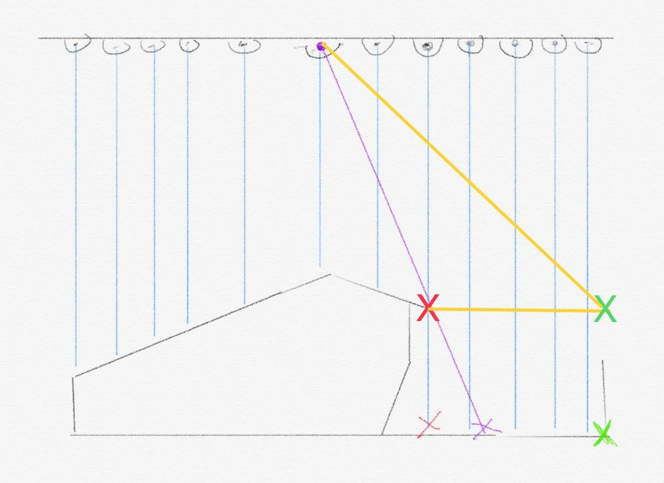

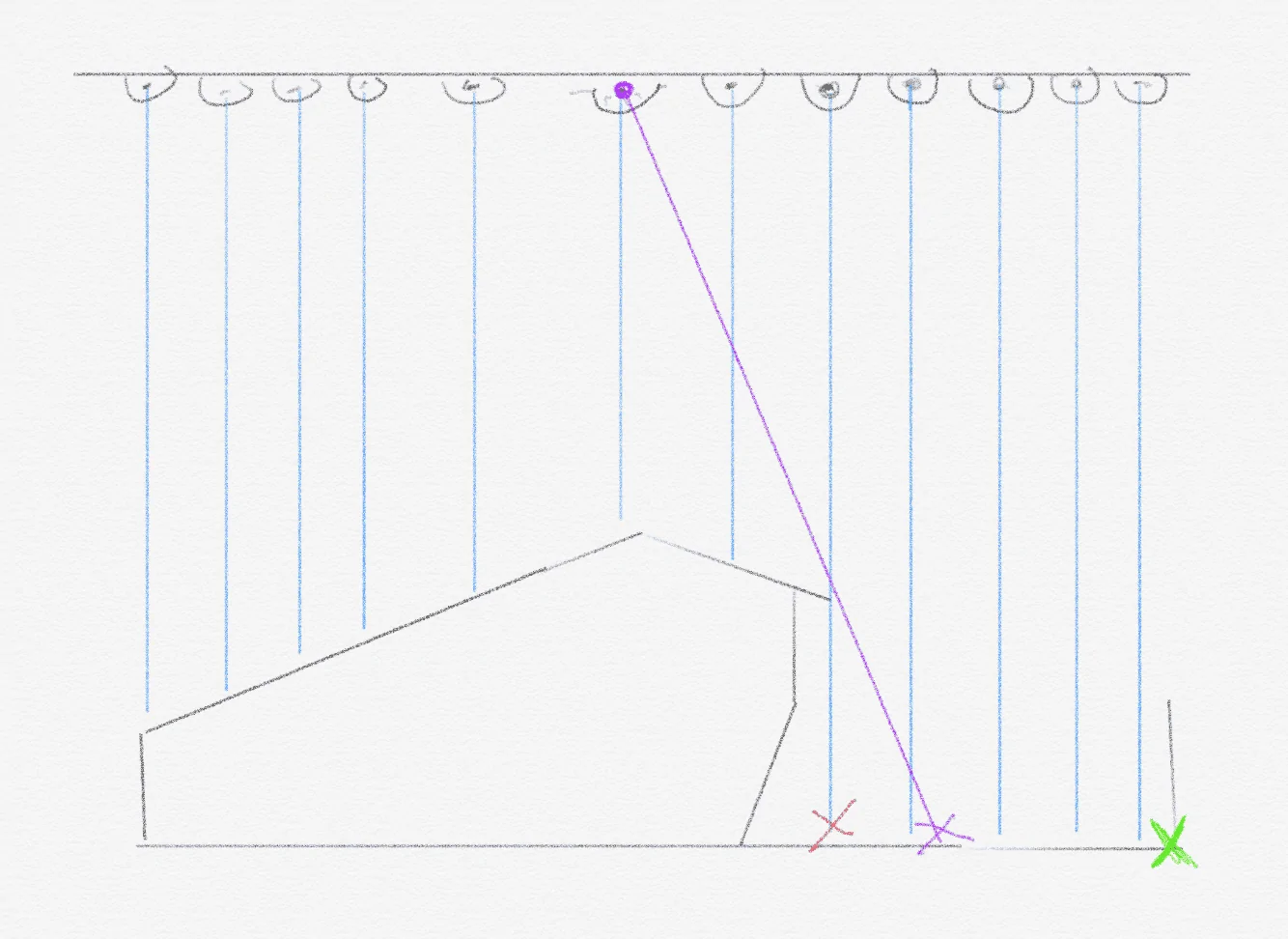

The camera over the center of the cab literally cannot see the red X.
Ok this is at least least part of the miscommunication
Of course it can’t see your red X. But
what it can see, is the exact point in space that is directly above your red X. Put differently:
Tesla Cybertruck Crash Test Video Measurements For Cybertruck Dimensions 87935258-0CB9-4E47-9427-102630601955

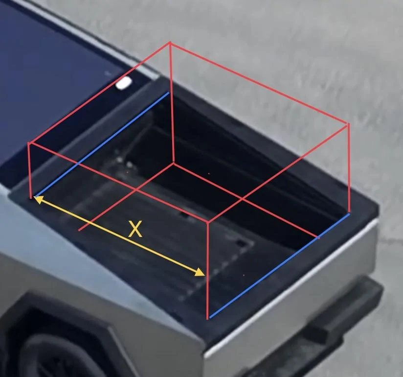

I wasn’t measuring the bed floor. I was measuring the length in space directly above the edge of the sill, to the place in space on the same plane directly above the inner edge of the tailgate - which by necessity of geometry measures - in real world - an identical space directly below this floating plane.
Tesla Cybertruck Crash Test Video Measurements For Cybertruck Dimensions FC46D73A-8BB2-49F5-A28B-69DE7BE52A2F
Any error from radial distortion in the above would come from the tailgate edge of the measurement (furthest from camera center), not at the sill edge (nearest camera center).

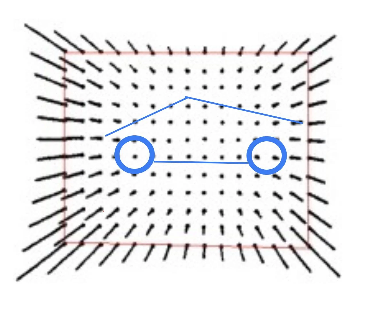

I know theses cameras to be set up as follows:
Tesla Cybertruck Crash Test Video Measurements For Cybertruck Dimensions 35035021-E08C-4FF2-A3C2-8D1AD124E0DB

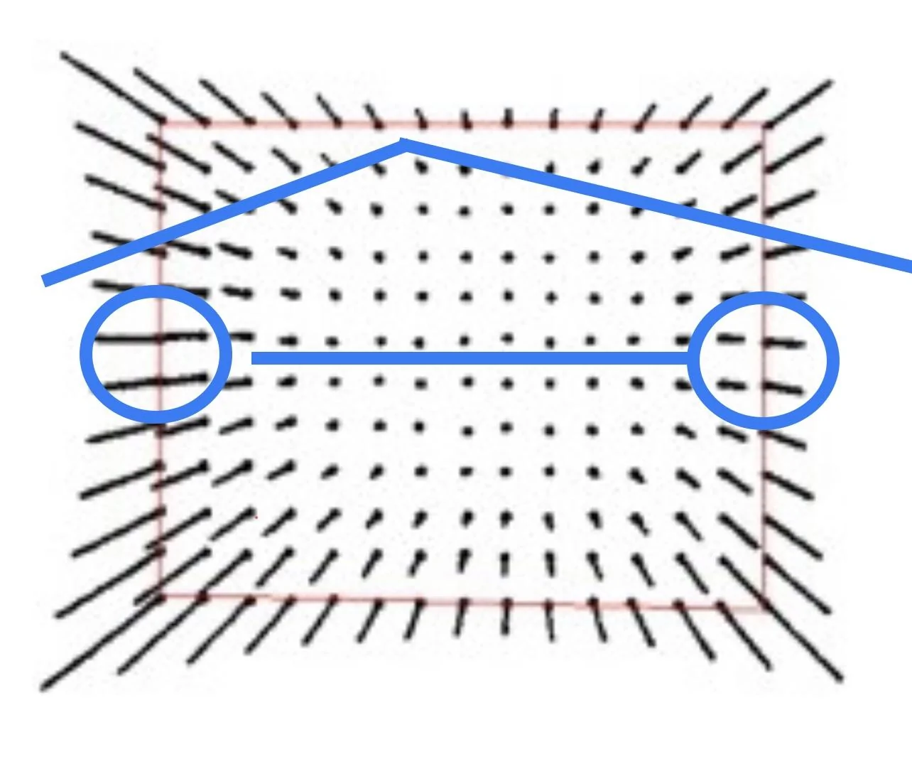

You keep implicitly assuming in all your comments that these cameras are set up as follows:
Tesla Cybertruck Crash Test Video Measurements For Cybertruck Dimensions 75EADEA2-A0FC-4386-9E93-48EDAB4C7859

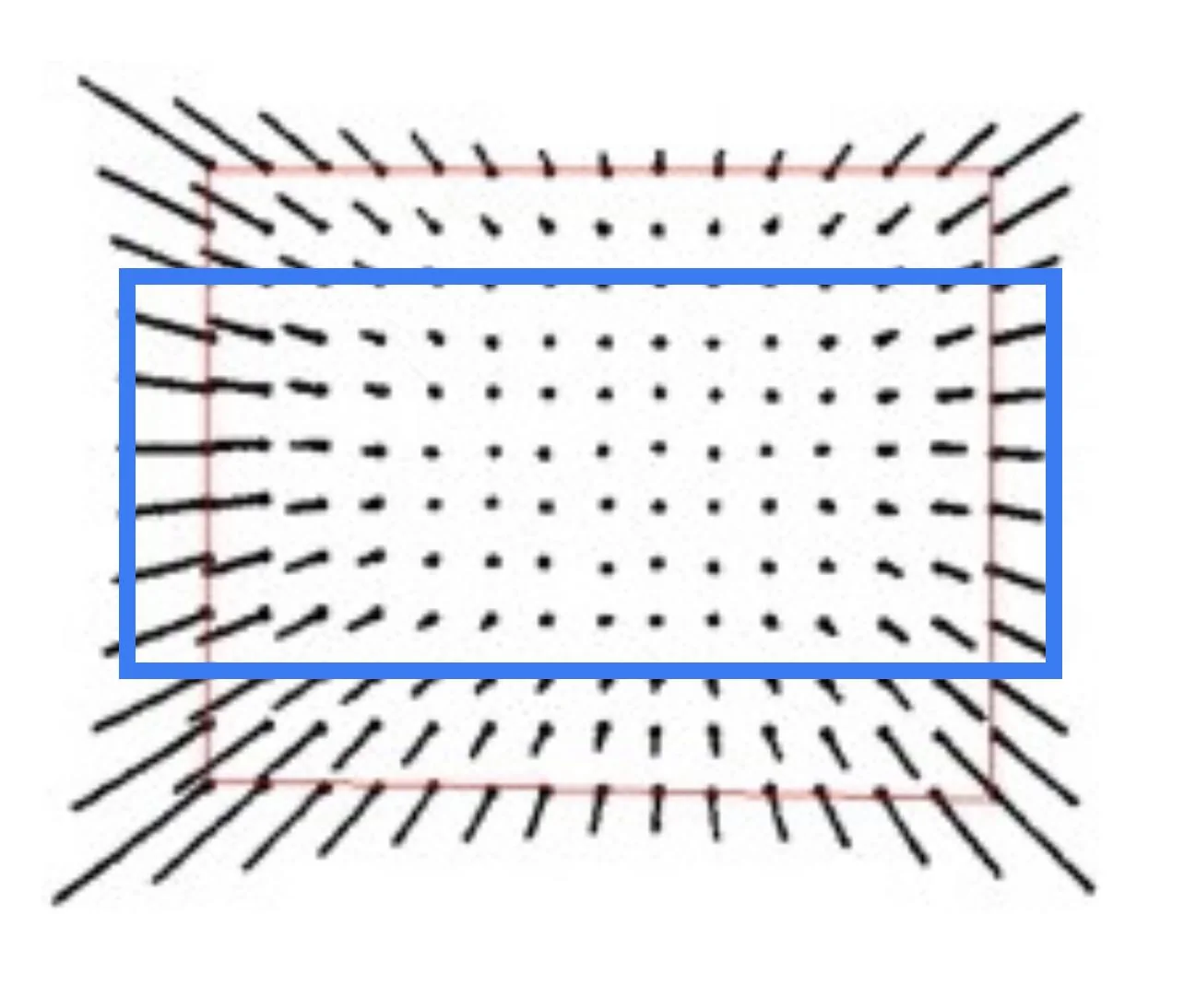

Now, in a “fish eye” type lens, the only point of no radial distortion would be right near the exact center of the frame. That is not the cartoon above.
The cartoon above is in a different type of lens - the ones like the use for these crash tests - where whole swaths of the center of frame are near zero, and the percentage climbs only very slowly outward towards edges non-linearly.
Accordingly, the cumulative distortion % across the red centerline is not also 4%, but instead the average of across the entire length of the line. And since I’m these lenses the radial distortion is near zero or minimal for a lot of the frame, even if the average across the wheel portion of the photo were 4%, the average across the entire red line would a far smaller number - let’s call it a cumulative average of 1.25% for directional example.
Go back, then, to this:
That 4% difference in rims applies to the rest of the vehicle along the line. Well it applies on a scale, less so to the left, moreso for the far right beyond the tire. This is why I'm saying your measurements are close, but probably a bit small. On the length I'd add 2-4%, or 4-8"
You hit at all this in bold, but forget to add that “except it’s zero in the middle, and near zero for much of the rest of the middle, and only a little more after that, before finally beginning to materially distort at the far edges”
But you then say the average is between 4% across the entire line (“8””) or 2% across the entire line (“4””)
Two problems:
First the average distortion in the rim area was not 4%, but instead at most 2.3% (I performed the math for you, above) - even if you assume that the entire error is from radial distortion rather than my measure point selection error.
Even assuming that 2.3% at the outer bounds of the photo, that by no means averages to even your 2% …. more like 0.5% across the entire waistline measurement … we’ll within my margin of error. (But that’s not the issue in my photo; thr issue
