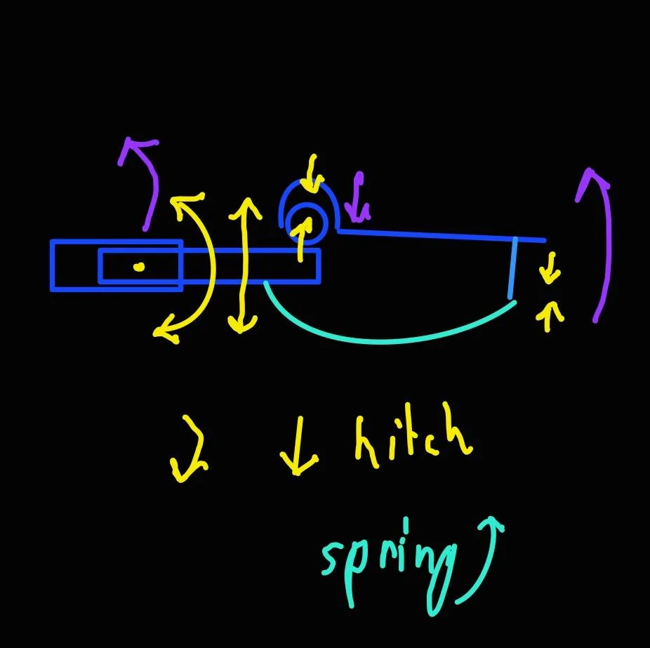

Force on the ball is not the same as force on the receiver.
Tesla Cybertruck Cybertruck Trailer Hitch/Casting Failure @10,400 lbs *VERTICAL LOAD* SmartSelect_20250317_204148_Samsung Notes
Loading the spring arms (green) increases the force on the ball and applies a torque that counters the trailer tongue weight.
Raising the trailer (purple) also increases load on the ball and decreases torque on the receiver (same effect as increasing spring tension).
May 27, 2024
4,654
5,653
They are designed to transfer weight from the rear wheels to the front wheels (actually axles) but they do NOT decrease the weight stress on the rear hitch area. In fact, the more weight being transferred to the front, the more weight pushing down on the trailer hitch fulcrum.
For example, every Ford F-150 made for the past 20 years has a hitch receiver that’s rated for maximum 5,000 pounds total trailer weight and 500 lbs tongue weight, except with weight distribution hitch it’s 14,000 pounds total trailer weight and 1,400 tongue weight (if properly equipped with max tow package, etc.) - every truck is speced differently, but that’s the range and no F-150 can tow over 5,000 pounds within spec unless weight distribution is used.
You are saying the receiver of the F-150 can only handle the torque of a 500 pound load, but it can take the torque of a 1,400 pound load if the stuff connected to it is called weight-distributing.
Do you see how that must mean the WD mechanism turns the torque of a 1,400 pound tongue into a 500 pound equivilent torque at the receiver?
Put another way, weight equalizing hitches do NOT increase the load capacity or the acceptable tongue weight EXCEPT they can increase the total towing capacity of a hitch system that has a separate rating for use with weight distribution.
They don't make the truck stronger, but they do allow the truck to handle a higher load...
Therfore, they must be modifying the forces the truck sees to acceptable limits.
IOW, the make a higher hitch torque look like a lower torque (like a lighter tongue would).
Hence my statement that tongue weight is not affected by the action of the equalizing hitch (although the hitch itself adds about 140-150 lbs to tongue weight with the two brands I have), but the result of moving the fulcrum out by 5” is correct as seen in the bike carrier example, where rated tongue weight is dramatically reduced with EACH inch outward that the center of the weight is placed. The hitch ball remains the fulcrum either way and is where the weight is centered. Move it out 5”, tongue weight rating drops from 1,100 lbs to 700-750.
You never explain why this isn’t so or why Tesla’s drawing explaining this is incorrect. For my non equalized loads I use a Weigh-Safe hitch. I just checked and note that THEIR equalizing hitch places the scale exactly at the hitch ball (12” from the hitch pin), so clearly they understand that the point of hitch weight is at the ball. See pic. Therefore, if you use a distribution hitch, you must use the rating applicable for 12” behind the hitch pin, not 7.5” behind the pin, which is the only place you get 1,100 pounds, or the ability to tow 11,000 pounds.
Put another way, when using a weight distribution hitch its pretty clear that you are limited to a trailer weighing 7,000-7,500 pounds. My trailer weighs 9,300 pounds or so depending on the boat’s fuel load, so no way I will trust my normal weight distribution setup with that, but am still within specifications assuming I am careful about how the boat is loaded - hence the non-distributing hitch system with built in scale.
I would genuinely like to have the added safety and security of weight distribution, but believe this would violate the specifications as outlined by Tesla, and place potential liability on me for exceeding the hitch capabilities, should something go wrong, even if unrelated. State police come looking for stuff like this when there’s an incident - they typically will let out of spec private towing alone until there’s a problem, unless a loading issue is obvious to the naked eye. Having air suspension compensate for mis-loading errors can mask issues like this until the point of failure in one or more components.
